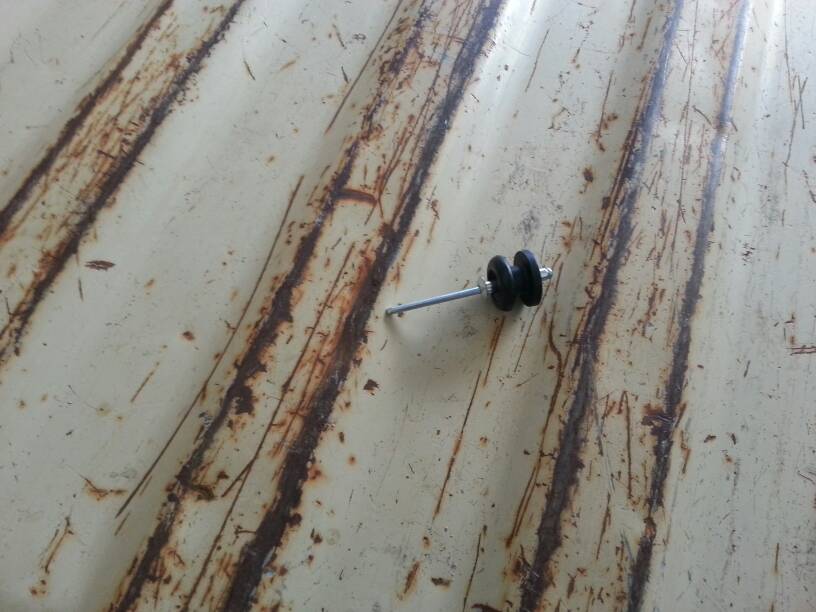

Replaced a tonneau hook the other day as it broke off some where down the track.
The kit was about $15 at supercheap. So Ive got a few spares.
[ATTACH]4100[/ATTACH]

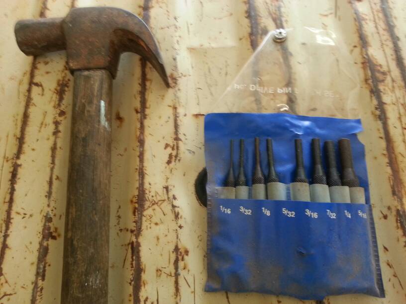

Thats what I started with. It was broken on a weird angle so the drill wouldnt dig in. I ended up using a drift punch to quickly knock it in.
[ATTACH]4097[/ATTACH]
Then you just slip the hook onto the rivet.

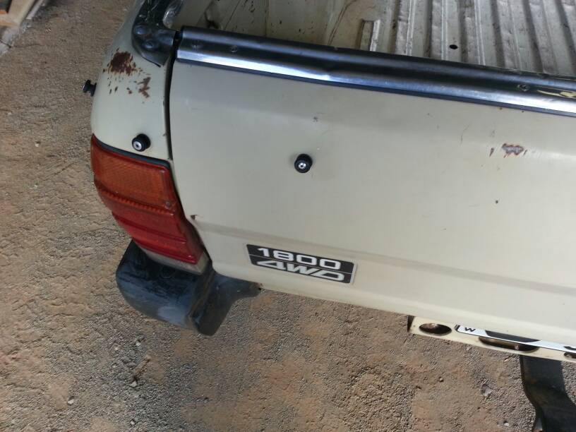

[ATTACH]4098[/ATTACH]

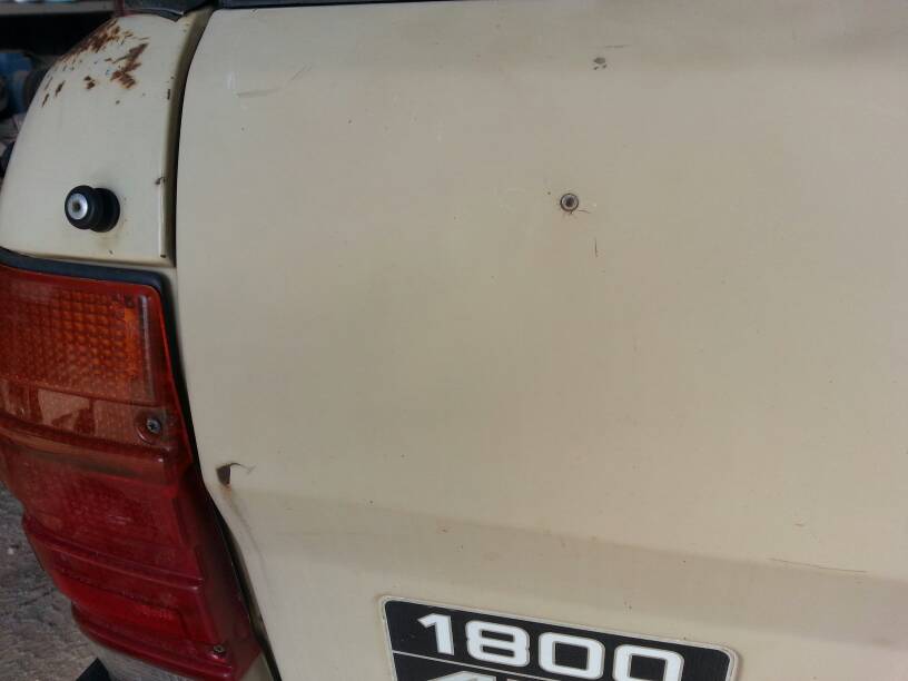

And pop it in.
[ATTACH]4099[/ATTACH]
Now all I need is a tonneau cover... -_-

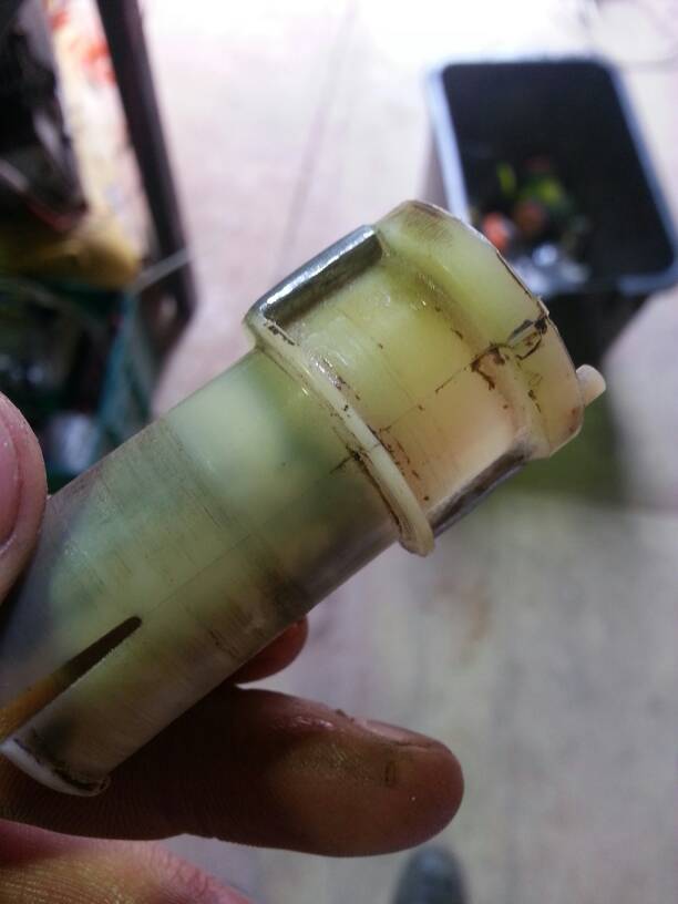

I did this two or three weeks ago now. It's very easy!
My advice to anyone reading is to make the sides of the metal pieces steep rather than not, otherwise the disengage mechanism will just slide over it without disengaging!
I used some model brass, 5mm wide (from memory), bent it to shape, heated it on top of the wood stove and pressed it into the plastic as the plastic melts a little bit. Once cooled those metal pieces will not be going anywhere.
Best mod/fix for the MY's I reckon! Well worth the effort of pulling the steering wheel and the steering column cowling.
This repair needs its own thread. I have put up with this problem for 14 years on one Brumby. Now wonder if the part is available - FROG ? I did imagine if only some genius could come up with a spring metal clip that had its necessary rises in it, araldited into place.
What are you using to hold them metal bits in place ?

Already done one here : showthread.php?t=22371
Just the process of melting the metal into plastic it seems to hold ...

If you can send me one that needs repair I can do it for you Steptoe. If you can't send a spare one I should have one on a parts car I can pull and repair then send to yousteptoe wrote:This repair needs its own thread. I have put up with this problem for 14 years on one Brumby. Now wonder if the part is available - FROG ? I did imagine if only some genius could come up with a spring metal clip that had its necessary rises in it, araldited into place.
