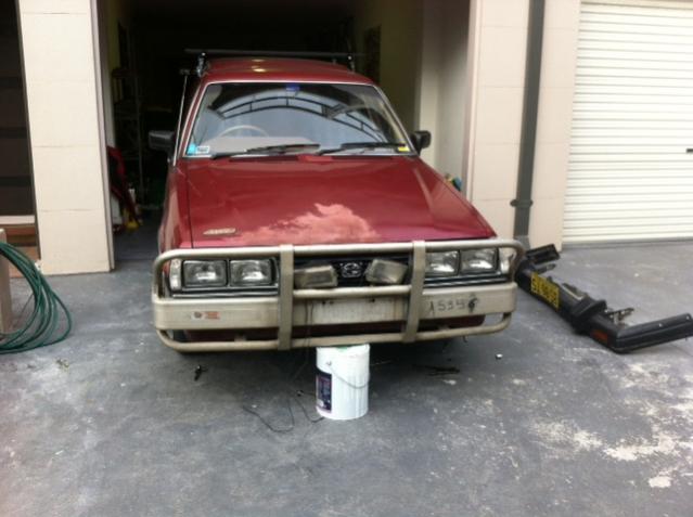

Vist to the wreckers - you pull it

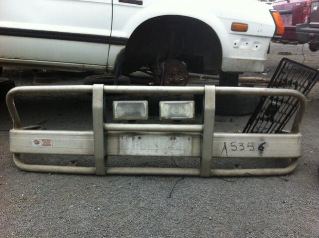

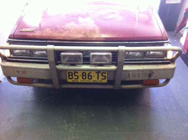

Finally got down to the wreckers.. No MY wagons in sight just two sad brumbies and about 5 or 6 L series. So much fun - like a treasure chest.. wish there were some wagons though
Grabbed this bullbar from the front of an 1989 brumby - single headlight model I'm not sure if there are legalities attached to my improvised indicator mounting..??
[ATTACH]3738[/ATTACH]
[ATTACH]3740[/ATTACH]
[ATTACH]3742[/ATTACH]

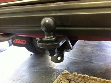

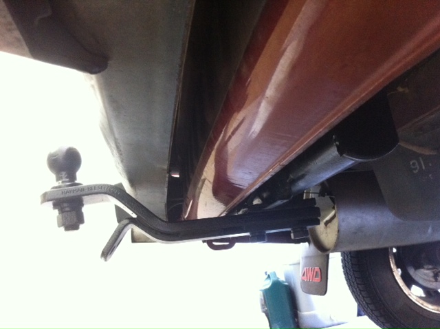

Sanded and painted the tow bar - holy shit this was a damn mission to get off - the brumby was wracked by beach abuse..
I also scored some nolathane bushes for the front torsion bar (i think thats what its called) only got the frontmost - will have to go back for the other two.

Haha - yes, I loved it. So many parts in such a small vicinity - if there were more MY's I would be addicted.
Cheers, yeah I was going to cut holes but they are in pretty tight.
$125 for the bar and lights
$45 for towbar
$5 for the bushes
Is this in the range of good prices for the wreckers? do you ever bargain or just go with it?
$45 for towbar
$5 for the bushes
- TOONGA
- Posts: 5340
seen the same bar on ebay for 250 dollars in the same condition no lights
I bargain all the time at the wreckers down here, but occasionally I just pay as the price is very low anyway
seen a tow bar for an my wagon for 100 dollars on ebayGunFactory wrote:$125 for the bar and lights
get a bucket and fill it with bushes at that priceGunFactory wrote:$45 for towbar
GunFactory wrote:$5 for the bushes
yes, yes and yesGunFactory wrote:Is this in the range of good prices for the wreckers? do you ever bargain or just go with it?
- GunFactory
- Posts: 130
- Joined: Sun Oct 28, 2012 5:28 pm
- Location: NSW
There were modified mounts on the brumby which I took and it has lined up pretty well, theres some slight droop where the bar wraps around the side - not to big a deal.Cliff R wrote:Which wreckers ?
Did you need to modify the bull bar mounts. ?
The bar I had looked to be the same as yours and it was off a Brumby and the bloke I sold it to was to put it back onto a Brumby again. No mount issues.

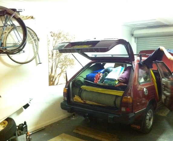

Travels and Trouble
Hi all,

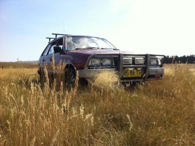

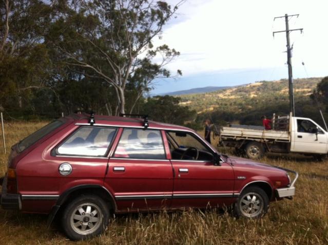

Have been having a damn good time with the wagon, have kept the suspension wound up for at least the last 1000km and have noticed some strange tyre wear. However, if thats the price for the car to handle nicely I'm accepting it for now... new front struts are $$$.
Here are some photos from the recent adventures

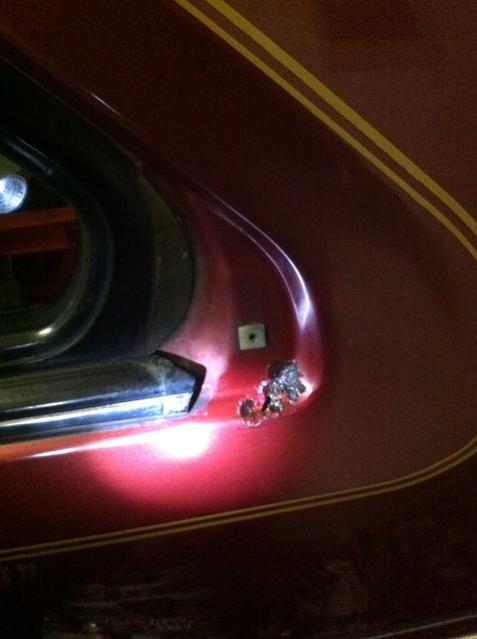

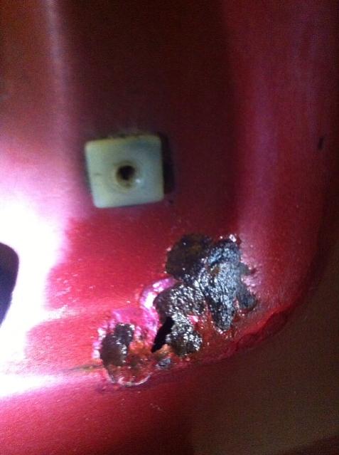

Last night I decided to hunt for rust...
I investigated a suspicious looking bit of touch up paint near the rear quarter window seal. After taking off the small plastic shroud and picking at what looked like nail polish... Ouch!

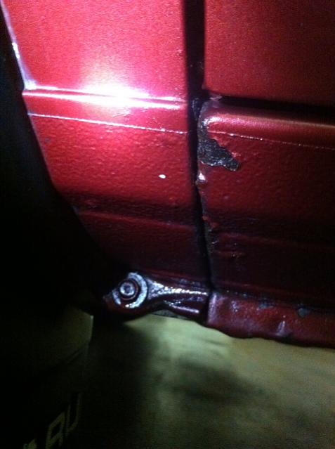

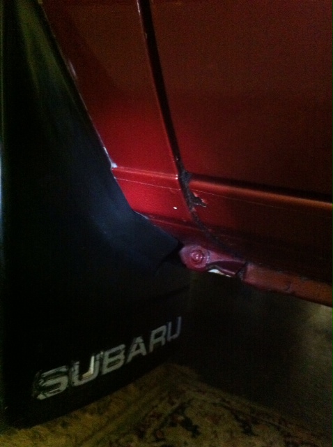

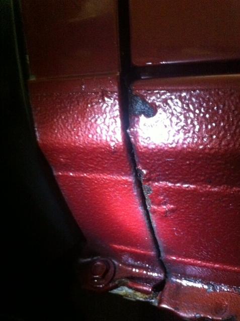

More rust
I also had a little pick at some little bubbles behind the LHS front wheel. I had been denying their existence for a while..
[ATTACH]3858[/ATTACH]
[ATTACH]3859[/ATTACH]
[ATTACH]3860[/ATTACH]
There also appeared to bee a substantial ammount of sand in the water drain hole/space inside the panel behind the mudguard.. Salty perhaps as there is no bubbling or rust in the same spot on the RHS.
Where I discovered the rust in the rear LHS window (previous post) I also noted that this was very close to where the rear windscreen water bottle lives.. which I found due to a very wet boot floor was lacking the majority of its rubber feed hose. May be a long shot but looks as if the water could have been spraying from the remaining hose onto the inside of the metal..... I'm grasping at straws here but will know more when I take a look from the inside.
So. I do have a little rust despite spruking that there was none so many posts ago.. Damn!
Any thoughts?

Also have a really good look right in front of the rear wheels where there is that "dog leg" angle between the wheel arch and the rocker panel. they seem to be hot spots for rust as I'm finding out. If the paint is bubbling, it means it's rusting from the inside and is actually alot worse than it looks from the outside. If you've had water spraying inside the rear panels I'd be having a really good look down inside the panel where the outer skin is folded and welded onto the inner skin (another place you'll find dirt and dust piled up) on the inside. Virtually impossible with the naked eye, I've found one of those "inspection cameras" with the long bendy cable is incredibly useful for finding rust inside panels. They seem to be sold at every supercrap and DIY style automotive shop these days.
That's if you are serious about preserving the vehicle, and with how good a condition that car is now I would be

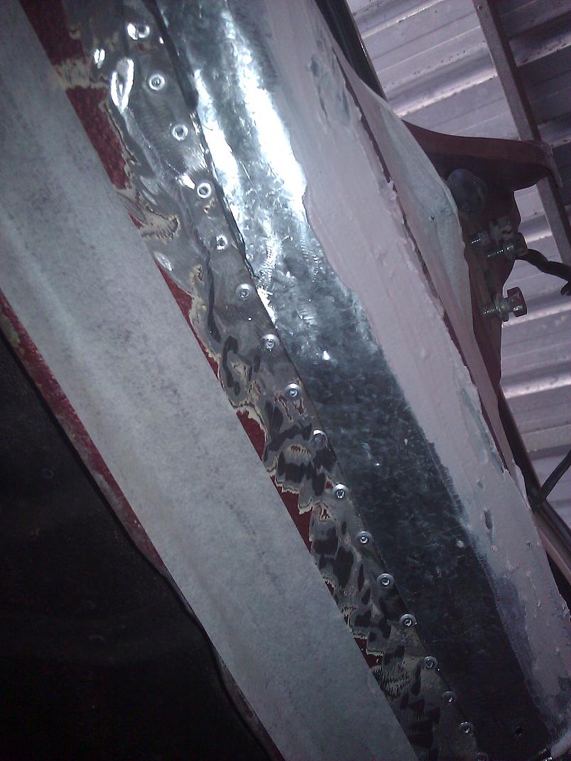

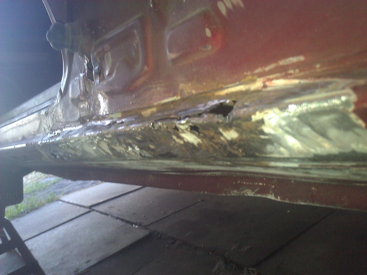

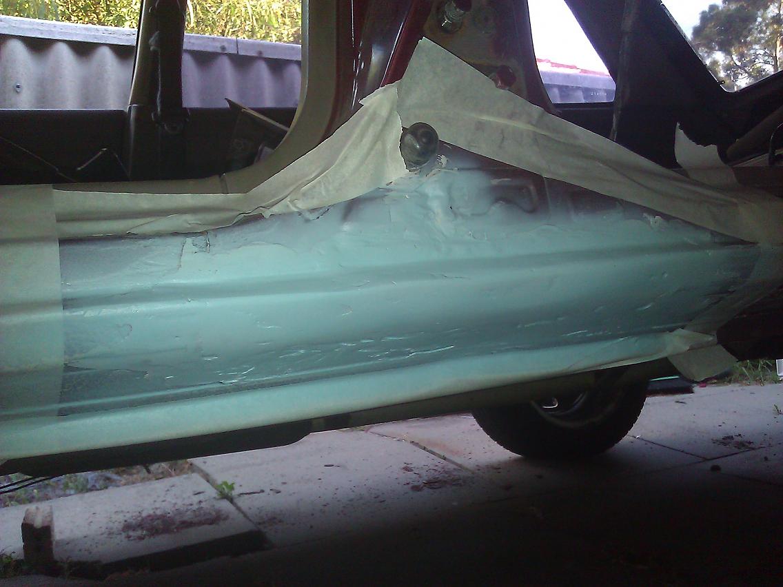

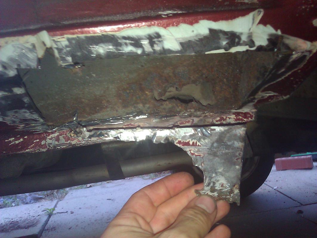

Hey Gunfactory,
I recently dived into some panel repair on my 82 touring wagon. Id deffinately be jumping onto it before it gets bad.
Unfortunately in my case the previous owner had just bogged over the rust and resprayed the whole car, so I really had my work cut out. Ended up putting about 3/4 of a sqr meter of steel back in the body, and I still havent done the rear door and around the front windshield.
Here are some pics to show you what to avoid
Mainly of one section I fixed but you can see how bad it got. One section was full of wet dirt which wouldnt have been helping.
Doug
Doug

Some People are just lazy, or they didnt know any better. Probably just scraped the paint off were it was rusted and bogged it up. What I found though is what you can actually see from the outside only reflects about 1/5 of the actual rusted out metal. I just got a screwdriver and walked around the car stabbing. If It went through I had struck rust and it needed further digging.GunFactory wrote:
That sounds pretty rough, I guess they didn't plan on keeping it long hey? boggles me as to why they would respray it knowing there were issues like that under the surface.
For a Temporary patch to stop it growing more, heat the area up with a hot air gun and stick some dessicant on or near it as best you can. Then after a day or two, spray it with fishoil to help keep water out. A car cover helps to if its sitting outside. You can pick them up on ebay for around 60 bucks.
Doug
