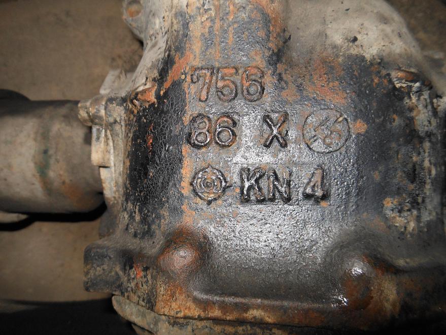

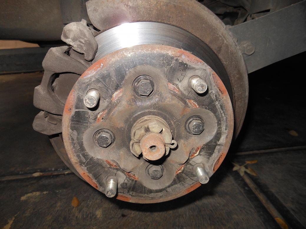

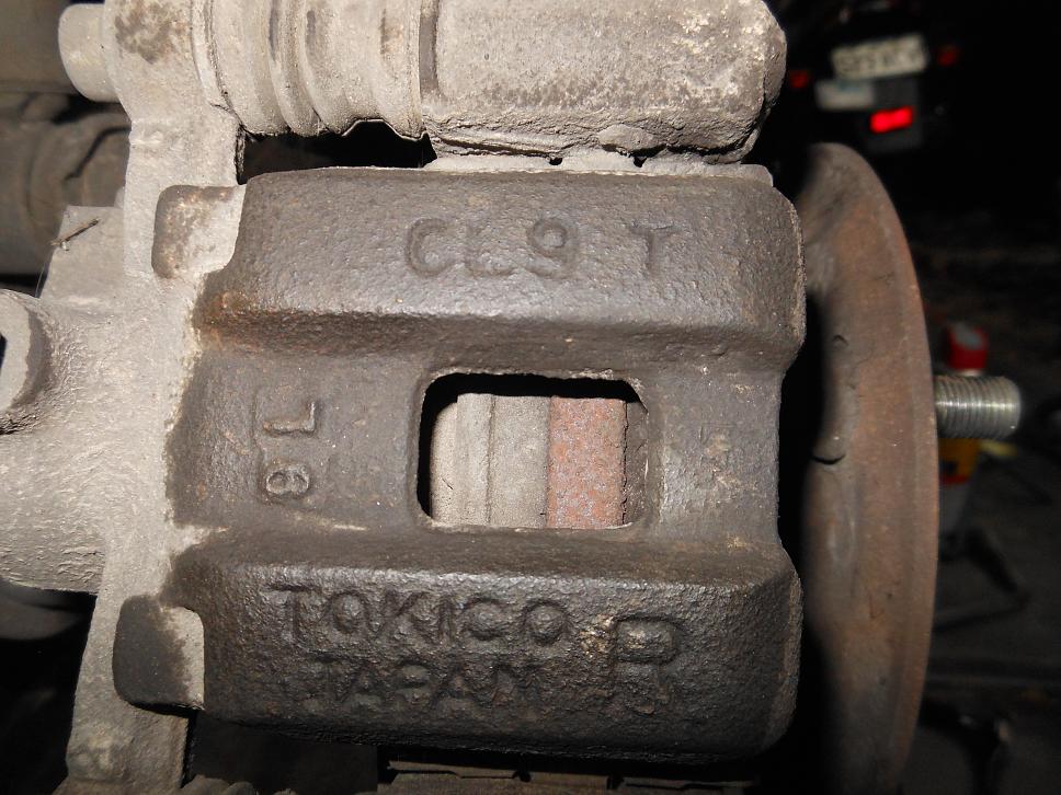

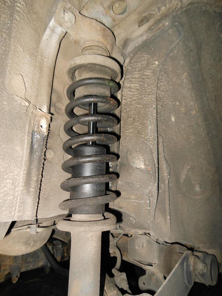

Post by Rebuilt » Fri Jun 01, 2012 5:32 pm
Hi all, I had a bit of a squeak in the rear suspension so I pulled off the tyres today and sprayed the moving components with a silicon spray and whilst I was at it took some photos. Can some with the knowledge give me some info on what I have in the rear as far as the suspension parts and diff/disc set up. Basically wondering if any of it is the same as a standard L series so I know what I'm after when sorting parts.
Tried my best to photo some of the numbers and the squeak is gone for now :lol:
Rear Diff.jpg (114.54 KiB) Viewed 6709 times
Rear Strut and Spring.jpg (106.93 KiB) Viewed 6702 times
Disc Break Rear 2.jpg (112.62 KiB) Viewed 6693 times
Disc Brake Rear 1.jpg (108.15 KiB) Viewed 6700 times

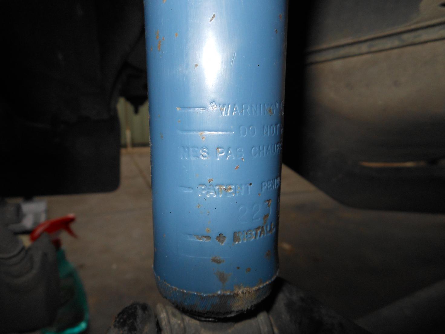

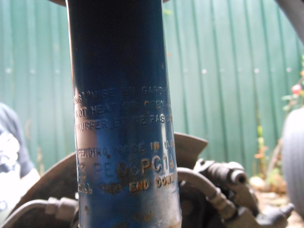

And some strut numbers, best I could get
Rear Strut 2.jpg (97.07 KiB) Viewed 6637 times
Rear Strut 1.jpg (96.2 KiB) Viewed 6642 times

You can help yourself by getting on the ground with a tape measure, sneak up from behind the rear wheel , shove it up to spring seat and measure from there down to centre line of bottom bolt of strut. You could then check with Peders on the measures of their 8201,8202 and 8203 rear shocks and see which one is a close match to your dimensions.
Allow for a bit of squish in the lower bolt bush
You have a standard factory rear station wagon L series spring going by the orange and green paint daubs. I have two sets, or had anyway, the other set had different colour daubs.
