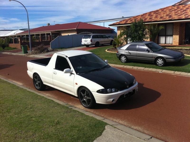

Post by niterida » Thu Nov 17, 2011 8:32 am
wrxer wrote:sorry its not a subaru
Looks good though - nice sleeper :cool:
nice rims - very similar colour and style to the ones on my Outback :D
I'd lose the black bonnet though :p
Post by TOONGA » Thu Nov 17, 2011 8:59 am
Can we change the name of this thread to Jacks Jumbuck?
I saw this car when it was just purchased and I have to tell you it looks way better now than it did. It is still a jumbuck though :)

Post by wrxer » Thu Nov 17, 2011 2:43 pm
thanks guys, i went with a colour for the rims as close to brake dust grey as i could get. i have had white rims before and these grey ones never need cleaning. ;)
and toongs, it goes way better too. its at 15.6 now, but will be mid 14 with the rear diff, then to wind the boost up to 14psi or so for low 14 i hope.

Post by wrxer » Fri Nov 18, 2011 8:09 pm
niterida wrote:500hp would just get you in the 9s :mrgreen:
if i could drive...but the ute weight is 1066kg stock, but may be 1300 by the time i finished. ie, awd gearbox, rear diff, tailshaft etc
if you look on post 26 in this thread, you will see the jumbuck rims when they were brumby rims, i had them blasted and powdercoated. the jumbuck i converted to 5x114.3mm stud on the front by utilizing tr magna hubs and discs.
rears are redrilled from 4x100 (jummy) to 5x100mm. the rims are 5 stud multifit and squeeze in nicely (no rubbing) with 215/35/18 on front and 235/45/18 on the rear. this really accentuates the rake on the ute (stock rake is 4") but in the above pic i had king lows lowered an extra 38mm in the front, but it is too low and i have another set of kinks lows in it now as the bump stops were getting a hiding and thats after i shortened the stops by miles
