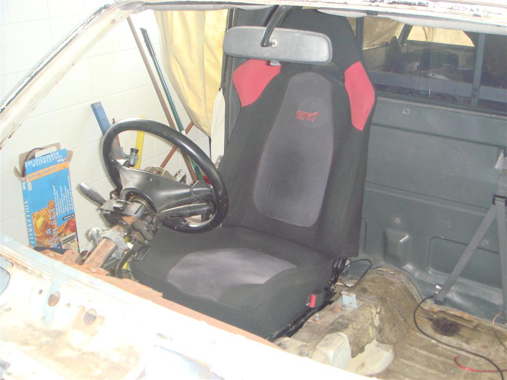

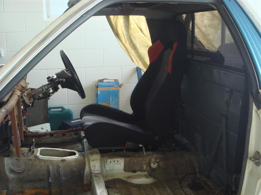

Hi guys, latest update:
Been working on getting the WRX driver seat mounted, i've decided to retain the factory WRX seat rails so this is anything but straight forward. After some cursing and head scratching, i've got him sussed and everything is tacked in. Once i've trail fit everything else around the seat centre console, dash, etc) i'm fully weld it it.
[ATTACH]1881[/ATTACH]
[ATTACH]1882[/ATTACH]

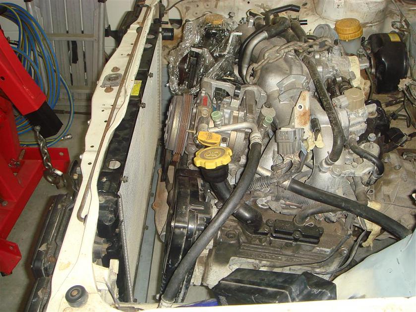

Here's a pic of the WRX radiator slotted into the front of the brumby, there's only a bit of mig wire holding the top at the moment until I knock up some brackets.
[ATTACH]1883[/ATTACH]

Agree with you - the seats are interesting to fit !! We dont have to replate if we do that sort of conversion here, as our annual MOT test would find out any issues, however that only happens once a year so you could run with a crap job done for 364 days before it was looked at!
Question...how much room do you have to extract the spark plugs? Must be tight!

I can get the spark plugs in and out quite easily actually, there's not gobs of room, but enough. It's a bit difficult to see in that photo as I have a fuse box sitting on the inner guard (not it's final position). I think the main reason I have room, is that I haven't spaced the engine cross member down like most people do to achieve a clearance between the motor and the bonnet. The bonnet closes fine with probably about 10mm clearance to the A/C compressor and power steering pump, this may not be enough when I eventually start the motor but and I may end up spacing it down, but probably only by about 10mm.

Nice mate, looking awsome. good plan not dropping the engine, we couldnt get the sparkplugs out of the one i built for my friend (ej20T,5mt, 4.11, hyd clutch, brumby radiator with bigger outlets, sti a2a intercooler, 2in lift, 14's) only realised after it was running. not pulling the engine out again now tho.
please, if you havent already, take heaps of photos and that on the seat mounting, and ill do the same, im fitting wrx seats into mine, using bolts through the floor and tunnel and into the original xpeice at the front. but if theres a better way, illd love to know, as im worried the mounts will push clean through the floor.

I've lost my welder for a while (I borrowed it from someone) so progress updates will be delayed for a while.
Brumbyrunner - For the dashpad, I actually peeled the black cover off the sections of the dash that I had to cut off, so that when I fit it in place and add some new sections to it, I can re-instate the pad by adding expandable polyurethane filler to the new sections and then just glue the cover back down.
Well that was the plan anyway, but the last owner of the half cut screwed a couple of gauges right into the centre of the dash so it's got a few holes in it.
Now i'm thinking once i'm happy with the shape, i'll recover the whole lot in leather or alacantara (if I can find some), and maybe do the door trims to match (they desperately need sprucing up).
Dane - I briefly thought about making up some adaptor brackets, but the problem is the WRX seats are very high compared to the original brumby seats, so if a bracket was used, I would have to remove the fun top to sit in the car. The location of the standard brumby mounts are also quite different to the WRX, so it wouldn't be a simple bracket, which would increase the difficulty at getting it engineered.
To help with the height situation, i've actually cut out the front seat mount beam and replaced with with a lower one with the correct mounting points for the WRX seats, making the rear mounts lower is easy as the floor slopes down towards the rear wall.
Once i've finished the mounts i'll post some piccys to show what I mean.
