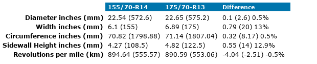

Just measured the wheel well space
the black line is approximately 18cm from the curve of the wheel well to under the wiper guard the red line is 30cm from the firewall curve to the encapsulated nut.
so when you compare a 155/70/14 tire to a 175/70/13 tire you get
stolen from here https://www.tacomaworld.com/tirecalc?ti ... -175-60r15
I don't think you will get anything bigger than a 175/55/15 in the wheel well but feel welcome to try if you know a patient tire fitter as I did years ago.

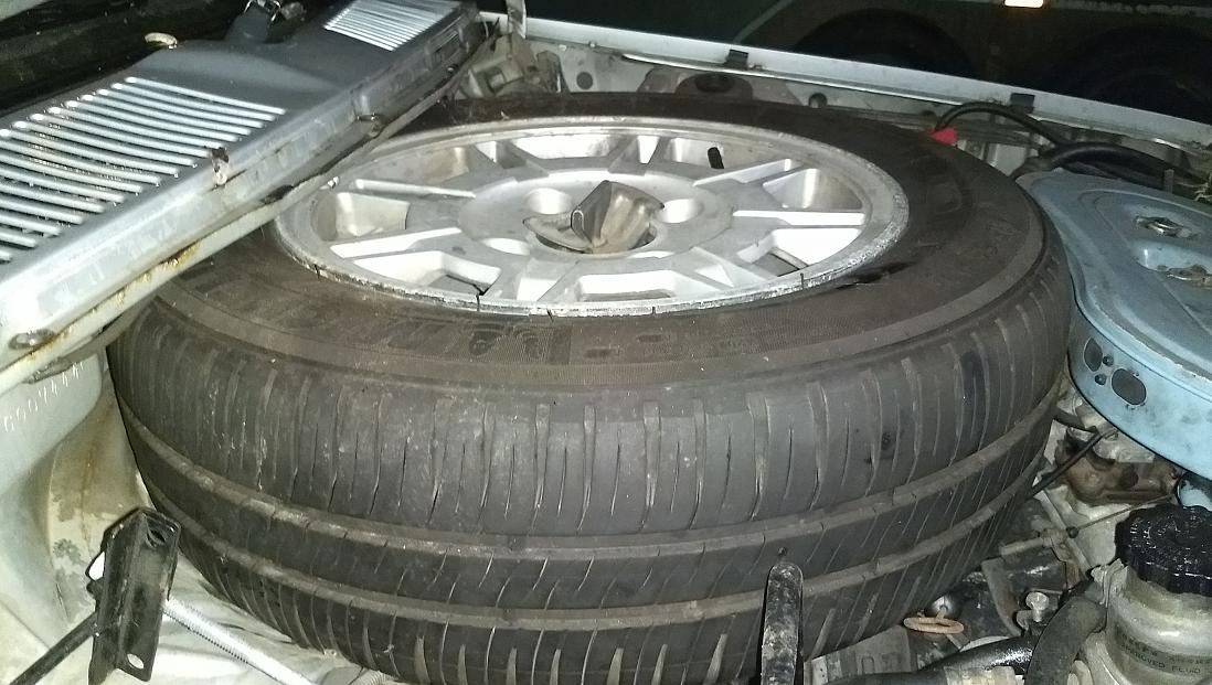

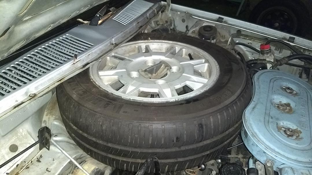

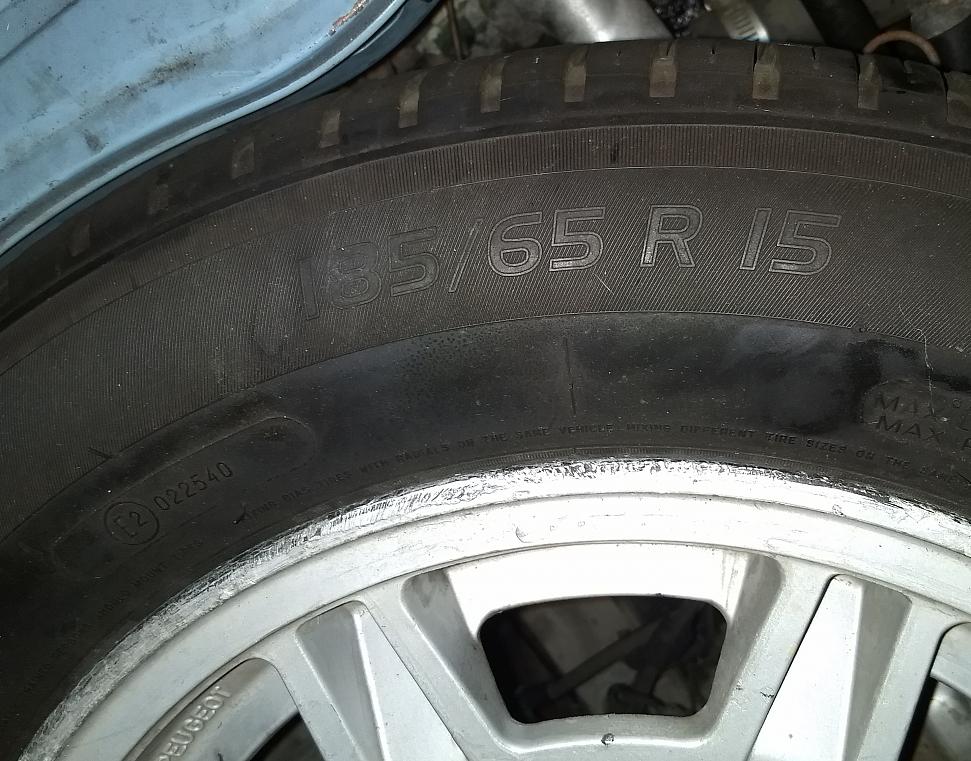

185/65/15
Running 185/65/15's and in the spare, the holder does not centre.
- IMG_20170717_224333195.jpg (116.91 KiB) Viewed 73703 times
- IMG_20170717_224254850.jpg (116.15 KiB) Viewed 73704 times
- IMG_20170717_224316340.jpg (113.69 KiB) Viewed 73704 times
- IMG_20170717_224242611.jpg (113.82 KiB) Viewed 73709 times

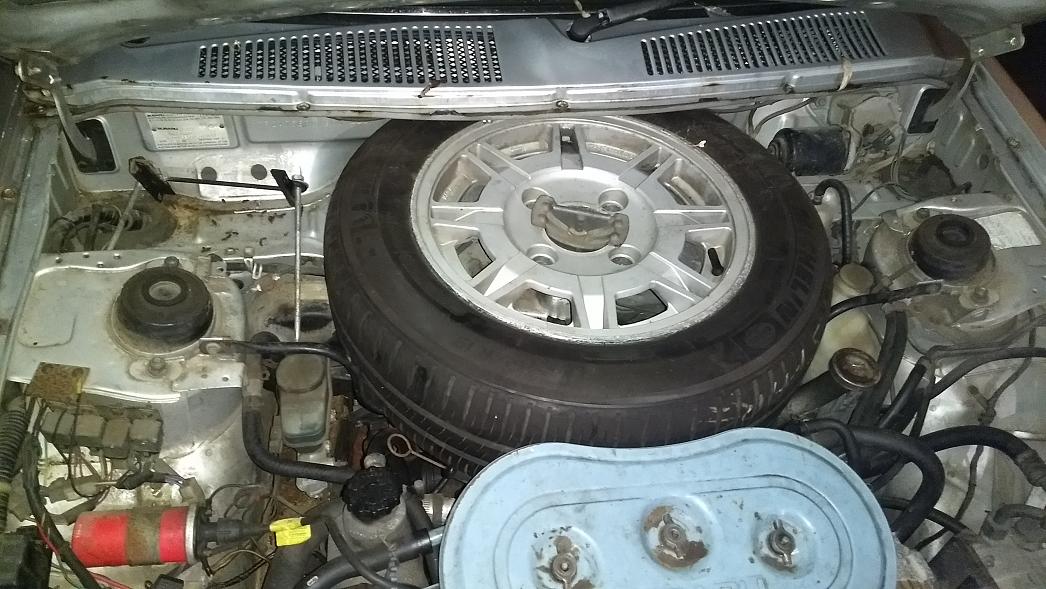

Re: Largest tyre to fit into MY/Brumby spare holder ?
UPDATE !!!
For some totally unknown reason, the exact tyre that is shown in the above photo of a MY touring wagon - will not fit into the same space in a 1989 Targa Brumby !!!!???
the aircleaner seems to be 10-15mm closer to the firewall and is preventing the tyre from slipping down into the firewall/bonnet sill slot.
As far as i know there are no issues that should have made the engine retreat 10mm to 15mm rearwards - but there we are.
Its not an issue related to engine height/lift kits etc as its not the engine height that is the issue.
Ahh well.
Ahh well.
