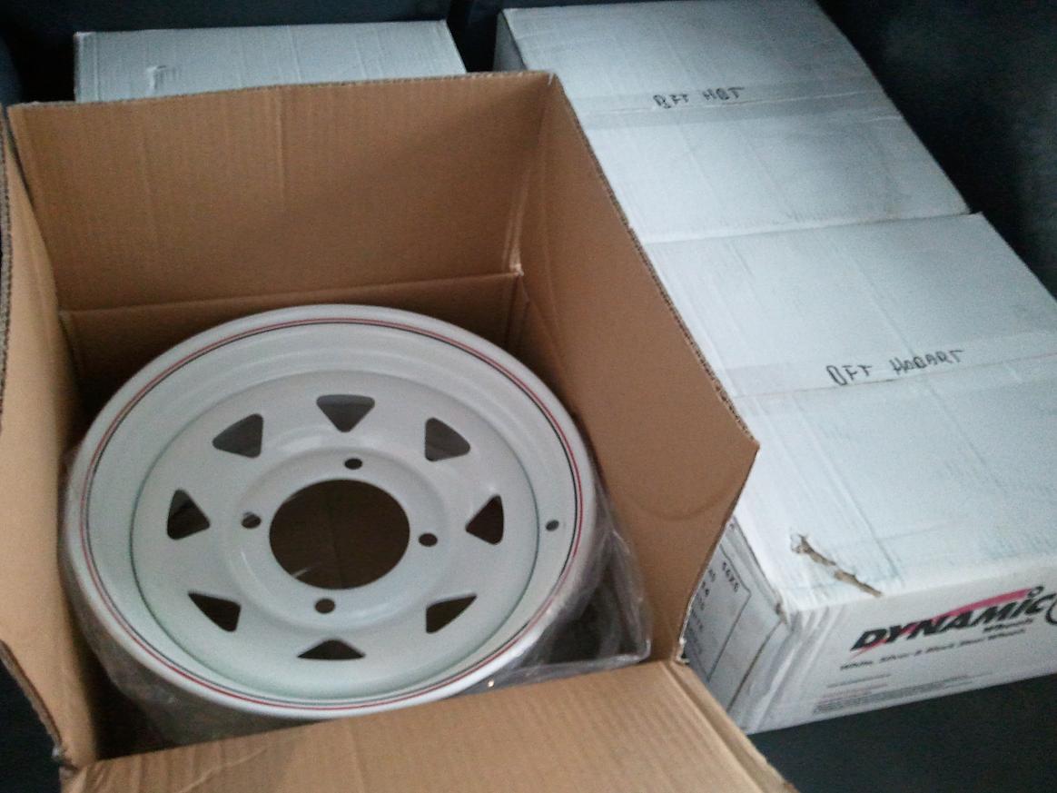

Hey guys,
So I bought a set of 14" sunraysia wheels (attached pic) and now just waiting to hear back from my enquiries for a lift kit. So once I have a lift kit done I will put the new wheels on but what tyres are you guys running on the 14" rims? I didnt realise the choice of A/T's would be so narrow but thats OK, im sure theres something suitible. Or maybe even just a light commercial or winter tread tyre?
Im not really planning to do serious offroading but just the odd rough track or whatever comes up when I go away camping etc.
Cheers!

Where did you get the wheels from ? You did well to find these are they new or just unused and still boxed ?
ratters
Posts: 33
Joined: Thu May 31, 2012 1:41 pm
Location: Sandy Bay / TAS
Post by ratters » Wed Jun 20, 2012 3:50 pm
Not sure exactly if they are new or have been sitting around or what, but I called beaurepairs in Hobart and asked them what was available for the L series, and they said nothing, so I asked can they order a custom sunraysia blank and have it drilled which they seemed to think was possible. But they called back and said theres a set in Launceston and they are yours for $69ea so I said OK! By the looks of them and the boxes I would say they have not been sitting around long tho, pretty clean and brand new looking.
