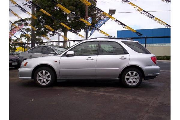

I've got a set of 4 subaru 15" alloys that I just took off my Impreza. Would be willing to swap with you for the 16's or $75 minor scratches and kurb rash.
[ATTACH]3329[/ATTACH]
current rubber is well and truly worn 195/60
-Mitch
