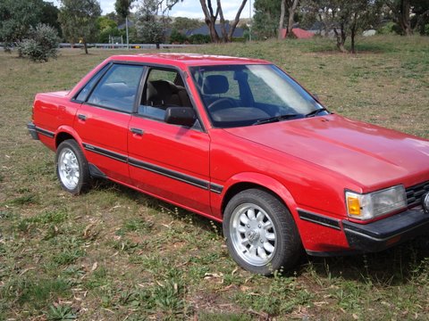

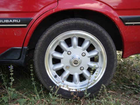

That's a real clean car you've got there timmo and those wheels complement it . Can you tell me what sized tyres it has on those scorpions .
Also very interested to know the finer details of that radiator of yours .
Sounds like fabricated tanks welded to a production aluminium core .
Thanks for the pictures , cheers Adrian .

185/65 at the moment. When it needs tyres I think i'll get 195/65. Speedo reads about 5km/h under currently. Radiator has a alloy holden vectra core which is the same length and width as standard L but thicker (can remember extact dimensions, something like mine is 21mm, standard is 15mm). Hand made alloy end tanks with bungs for thermo fan probe and a/c thermal cut off. Its held within the standard frame so fits without modification - but there is not enough clearance for clutch fan so i run the standard thermo and a 10" davies craig, both contolled via the factory setup.

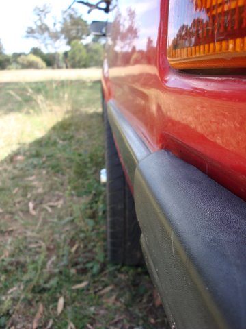

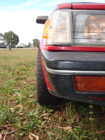

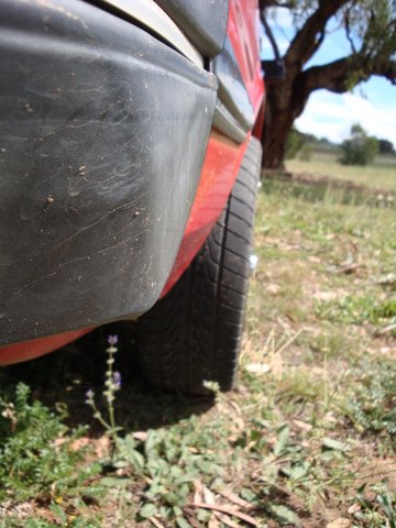

Here are Jono's photos i promised him id upload
- DSC01249.JPG (61.53 KiB) Viewed 5256 times
- DSC01246.JPG (72.72 KiB) Viewed 5256 times
- DSC01243.JPG (59.56 KiB) Viewed 5254 times
