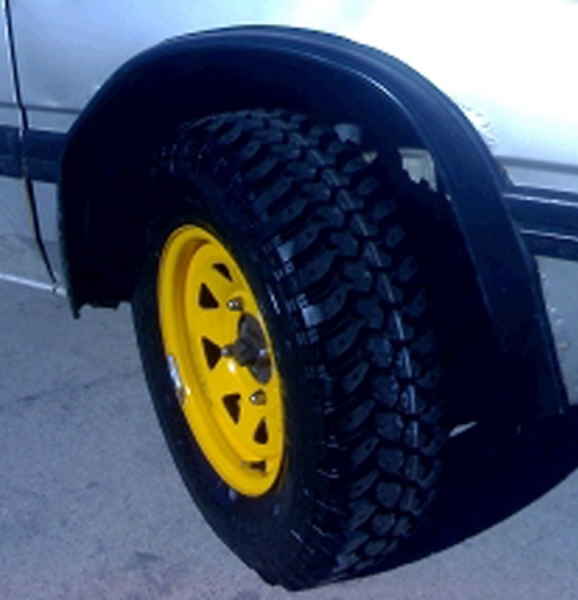

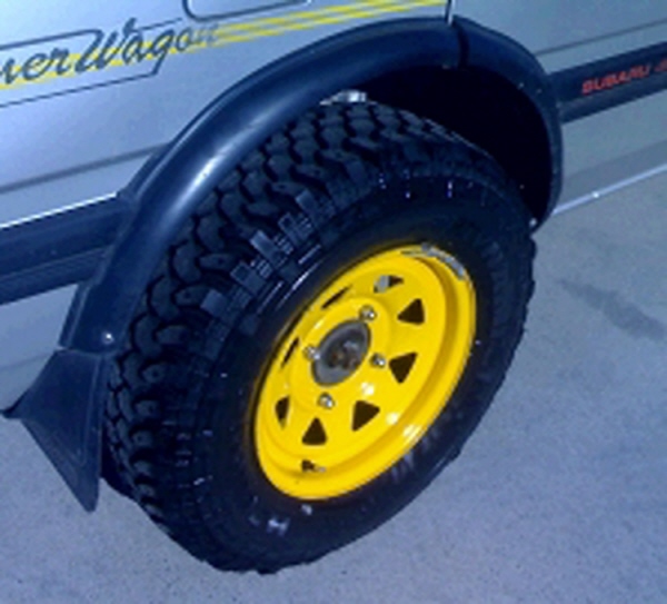

Post by whatcharterboat » Fri Aug 08, 2008 6:31 pm
Hey Got the hankooks today. The tread must be at least 12mm deep. Hope they last. More road noise than the Super Trippers and you can almost feel each knob hit the road but I can't wait to try them on the beach. Let you know how they go. The tread in the road is a little narrower and they don seem to rub at all. Thanks for all your advice.

Lookin' good.
The tread blocks are very close together in the middle. Probably be better on sand than mud.

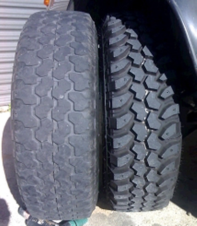

Post by whatcharterboat » Sat Aug 09, 2008 3:32 pm
Hi .
Yer. They are Hankook RT01's and I am sure they are 27 x 8.5. The same as the Hankooks on paper but they look a little narrower and taller. They just rub at the front on the flairs when they didn't before. I don' know how much the RRP is but they cost me less than my Super Trippers. Don't know the RRP of those either. Shop around. The pics don't really do them justice. The RT01's make the old Wild Conquerers look like slicks when you look at them together.
