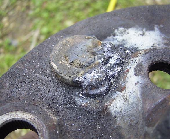

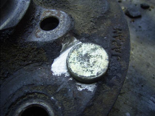

I did some reading yesterday regarding this, and a couple of thread on this forum highlighted the danger of it more than anything. The drilling of the hubs isn't actually a problem in itself but the drilling into thinner material than where the original studs come from is. So to is welding the studs onto a hub because the hole is a bit big. Now if the hub was uniform thickness at every bolt hole I wouldn't have a problem with it but it is obvious from a few things I have read that they aren't and the new studs are put in material that is significantly thinner that where the old ones come from.

Part of this stud is unsupported, and when you have to angle grind to fit the stud the material it sits in is thinner. I grant you the stud isn't recessed into the hub and these parts are thicker but the combination of no support on part of it and the grinding of the hub would be deemed in NSW to weaken the overall structure. The welding in the next pic would deem it outright dangerous and as an Authorised Registration Inspector I would have to fail the car on a pink slip (if I knew about it) and possibly ask the NSW RTA for a ruling.

strength wise... i cant see it being a problem, ive been running 6 stuf for a few years and everything has copped a caining, ive bent lower control arms, radius rods, shocks, broken ball joints, and the hubs have held up fine
i must also admit that im one of the dodgy people who have welded the studs on as well, as i didnt quite get the holes perfect :(
legally tho... theres no way they would pass if anyone noticed

Don't get me wrong, I like the idea of a 6 stud. I just cannot see any engineering signatory passing it if it is done like in the pics I put here. If someone like Castlemaine Rod Shop would make a batch of hubs to suit then the legal aspect would be taken care of.
