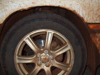

im running 16 inch x 6.5 (7 spoke imprezza)with 215 60 16 maxxis and 10 mm spacers to rear, rolled guards, with no lift im rubbing on spring perches atm with plans to fit early rex struts all round to give the extra clearance big difference in the gearing with this set up im using low range for first 5 gears then chuck it into high for "sixth" just something to bear in mind. umm standard wheel size was 14 or 15 inch i think from memory....

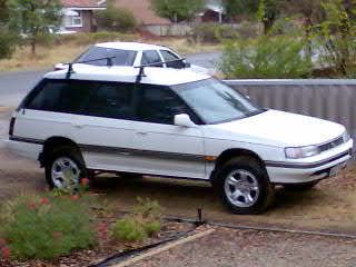

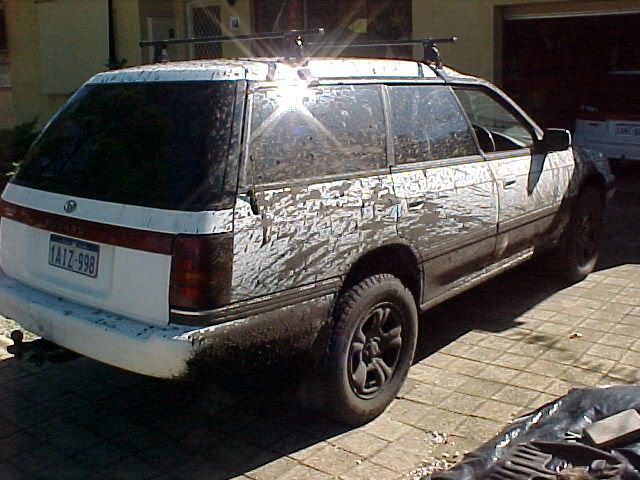

i've got a s1 wgn with 2in lift,g2 outback struts and springs,16in forrester rims with 215/70/16.thats 27in tall
The front mud flaps scrub a little on full lock,rears i had to cut and bend the section in front of the tyre,not a big job.The gap b/w the front of the rear mudgard and tyre is only 10mm,apparently outback lower contol brackets can fix that.Haven't fond any yet.
If you want to fit that big tyres you have 2 use o/back rear struts,if you use std lib,the tyre will rub the lower spring plates.
