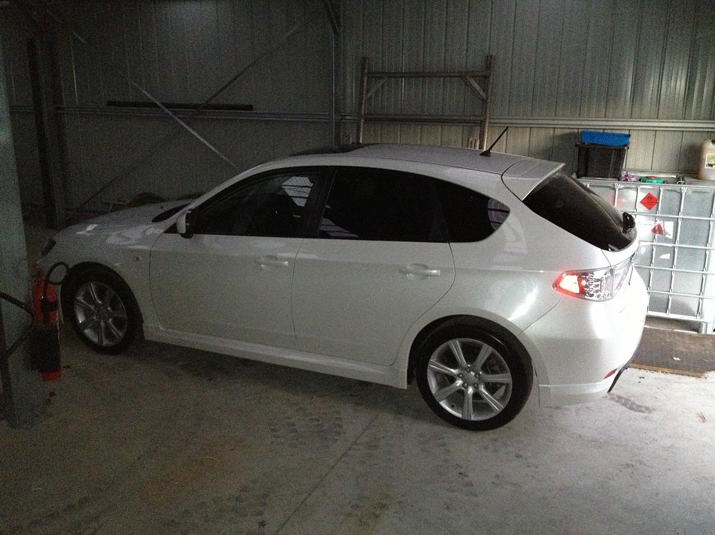

Hi all,
I have purchased a pearl white my09 Impreza RS hatch and am seriously considering putting after market rims on. I am curious to know the specs of the stock rims, I know they are 17"x7.0 alloys stock with a 5x100 studd pattern but I am not sure of the offset and am finding it difficult to find the offset specs.
In saying this, I have no idea what offset means... Does anybody have an indication of the size, width and offset of aftermarket rims I could purchase which will not affect my stock set up such as rolling guards etc and will fit straight on?
HELP! THANKS!
HELP! THANKS!

My 2002 WRX has 17 x 7 factory alloys.
Yours will be similar.
From under the car, look on the inside of the spokes until you find "MADE IN JAPAN, 17 X 7JJ 55".
The "55" is the offset.
Which means the hub face is 55mm AWAY from the centre of the rim width towards the outside of the wheel.
A "0", (Zero") offset has the same amount of wheel either side of the hub face.

Best to check your wheel (like Gary said) to see what your offset is before going any further. I personally wouldn't change it from what standard is, otherwise you'll put extra pressures on your wheel bearings. As for going a little wider, I'd check your clearences between the tyre and strut first. You might find the RS model is already the widest possible. Also, check with your insurance on what wheels you can fit, you really don't want your insurance knocking back your claim, just because you have 'non standard' wheels on it.

Any offset other than 55 will shorten life of the bearings, you also need to check the clearance of the struts and fender gaurds as well. That is why i dont bother aftermarket rims.
