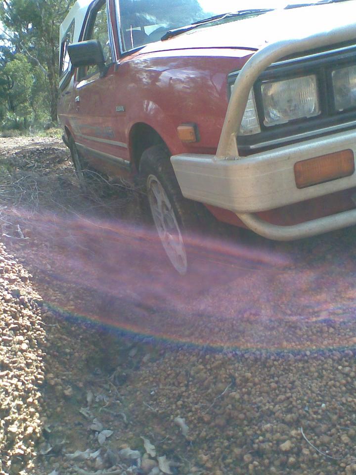

And here is a photo of my front wheel- Do you reckon I need guards? I'm pretty keen on the idea of pulling the top of the tyre in a bit and reduce the camber by slotting the strut tower holes too.
Sorry the picture isn't great..

Can't hurt to put some small flares on.

Does anyone else have an opinion on the offset here attracting attention without flares? I'm just reluctant to put them on because I would only need them for the front wheels- if at all.. and that might look a bit funny.

I have now got 215/65 r14s on my brumby and in the last 2 days Ive been passed by 2 highway patrol cars, driven through a spotcheck point, and had my son wave at a police car next to us at a set of lights much to my bemusement, they did nothing and my tyres stick out way more than yours if you are really worried get some guards flares like the ones guyph_01 has on his L series
By the looks of that photo, your Brum seems pretty unremarkable (in a nice way). I wouldn't worry about flares. Plenty of cops have seen my L with oversize tyres, including 27x8.5" ATs and no flares, and haven't said a word. You'll be right.
