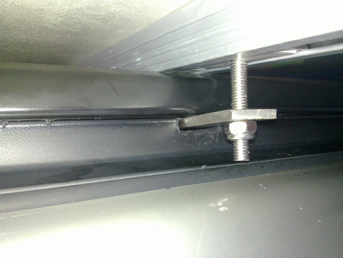

When you make the slits I'd suggest drilling a hole at each end a little larger in diameter than the width of the slit. Its an old engineering trick to stop the slit, which is like a crack, from growing.
So measure then drill your 2 holes, then cut the slit from one to the other. Try to do it evenly so there is nowhere for the stress to concentrate.

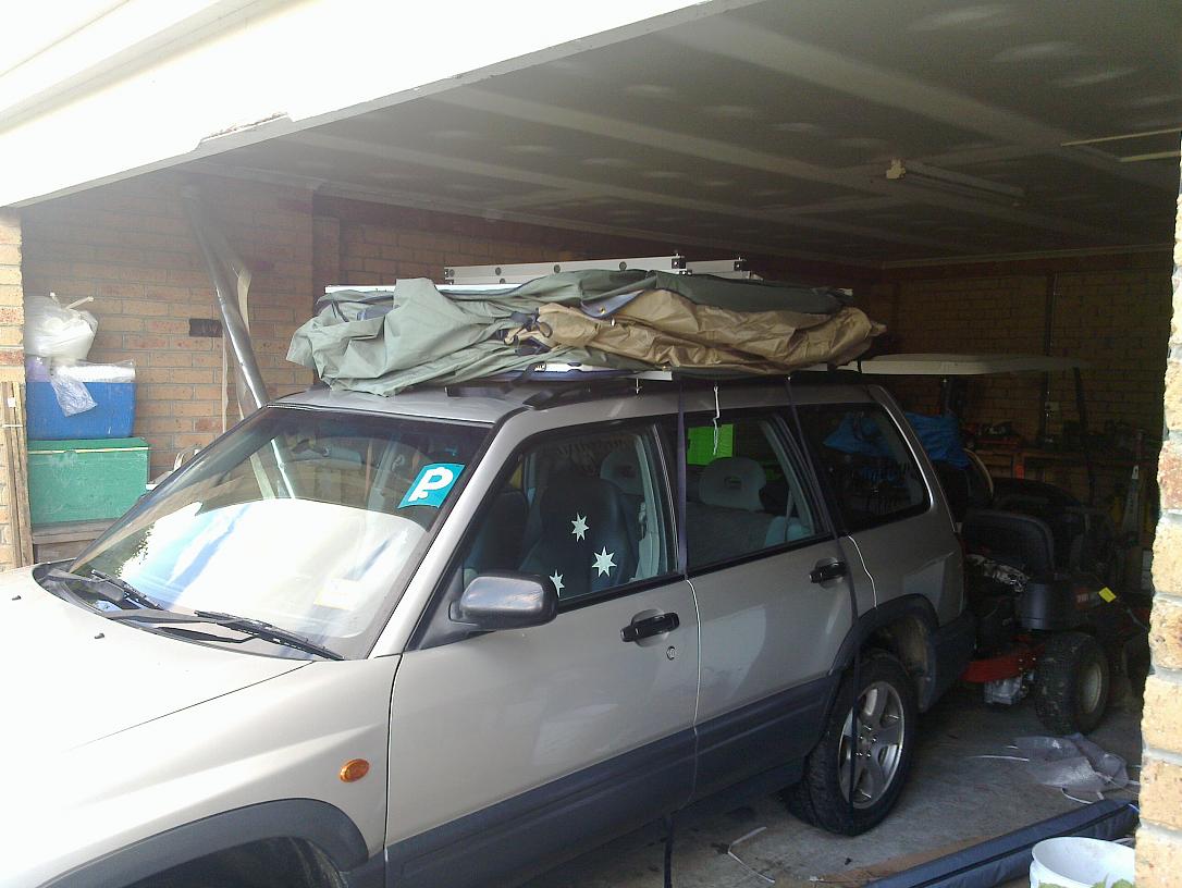

Post by thunder039 » Wed Jan 11, 2012 2:20 pm
well the tent arrived yesterday, so all systems go was todays plan. have got it all on except one bolt as i lost it :???: but will get a replacement tomorrow. the plastic roof rails seem to be more then strong enough for the job as i have been in it and tested it out. the new firmer and lifted kings springs also insure that the car doesn't sink much all when im in it.
the pictures show the tent folded up on the roof but with out its cover and the slits made in the roof rails. all thats left to do is figure out how to install the awning which means understanding the instructions :rolleyes: and then test it out!

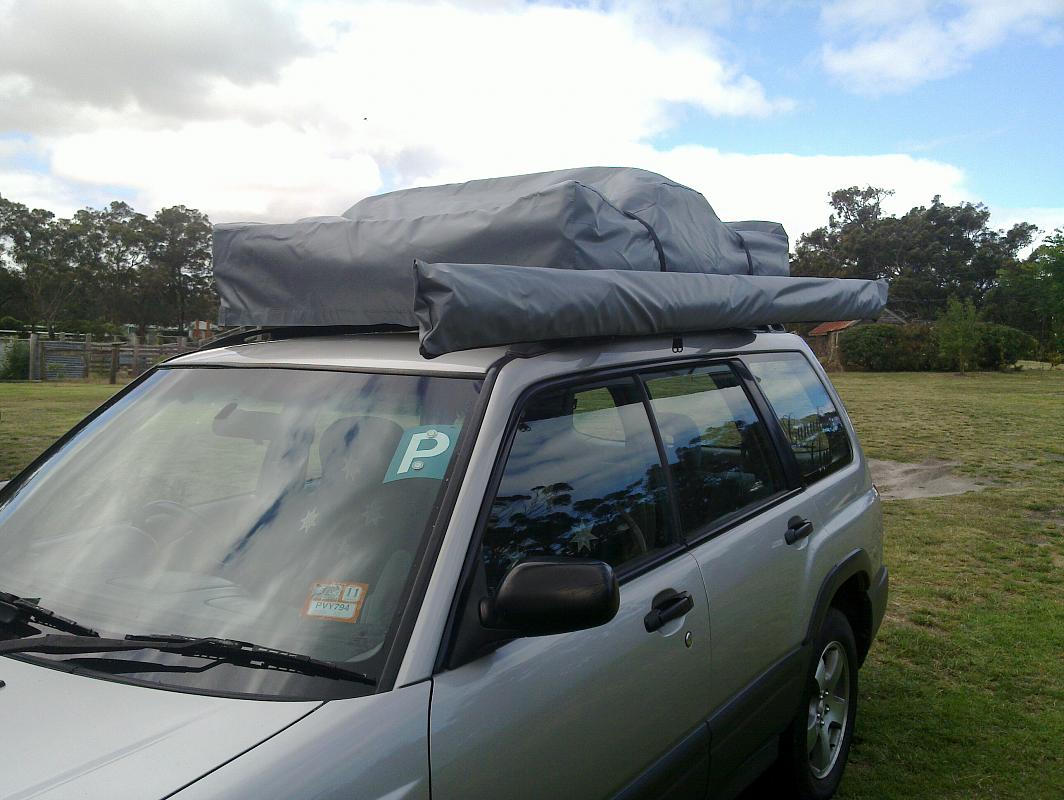

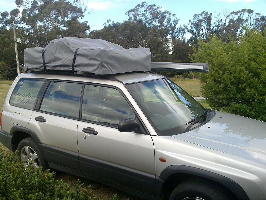

Post by thunder039 » Thu Jan 12, 2012 3:31 pm
just a few more pics. finally got the awning on with help from google images:D.
i will get some pics up of it all set up when i go camping to use it!

Post by El_Freddo » Thu Jan 12, 2012 9:50 pm
Looking good mate! I reckon an air dam in front of the tent could be good if the tent doesn't use that area when it's all set up - just for extra fuel economy.

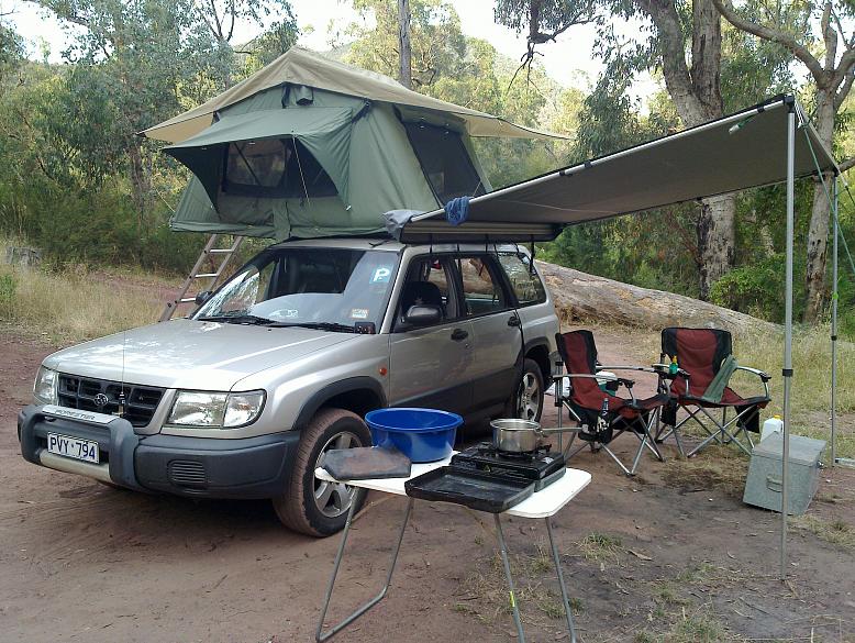

Post by thunder039 » Mon Jan 23, 2012 8:45 am
well here it is all set up. fantastic to use much better then a tent. look forward to many more trips using it!

Post by NachaLuva » Mon Jan 23, 2012 12:37 pm
Very nice thunder. How is the drivers side of the RTT supported? Cant see poles, just the ladder.
Love the fly & the window awning, should help keep it cool in summer... kool :cool:
Those awnings are very useful, dont take long to set up & make lunch in the rain so much nicer.

Post by thunder039 » Mon Jan 23, 2012 1:38 pm
when it folds out it clicks into place and the ladder also acts as a secondary support feels very sturdy. the awning is very useful indeed! i was camping in the vic high country when we had some hot weather last week and it proved very useful to keep out of the sun
