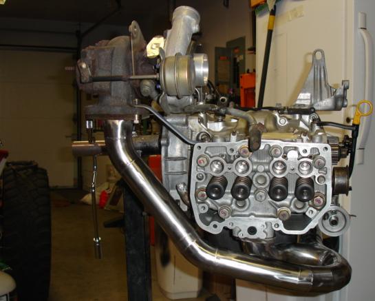

think I posted these ages back on old forum.
if you' chasing power, something like this is the best thing since sliced bread. Prettymuch mandatory really, not just bigger pipes, but the merging design.
I had alll sorts of troubles with the stock pipes, it was extremely obvious they were trouble on the dyno as they would glow bright red when trying to tune.
only thing I can't remember is the size, i'd have to get in there with some calipers. since that's your main Q afterall.
-ed oh and to give some indication of how effective they were, before, it was probably a 16sec car at best, and winding the boost up to 15 would do nothing.
after, It ran an easy 15.1 @ 90mph prettymuch straight after installing them and getting engine back in, with just basic road tune, heat soak mania top mount, and about 11psi . I still havent been back since adding a fmic and more boost .. been nearly 2 yrs now :/

Thanks for the pic, that front pipe on mine is leaking so I want to get it off to make a jig for exactly what you have shown.
All I need is some bends, a mig and some time.
The "T" join from the RHS header on the original would be the most crudest design I have seen.

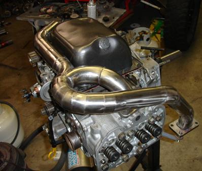

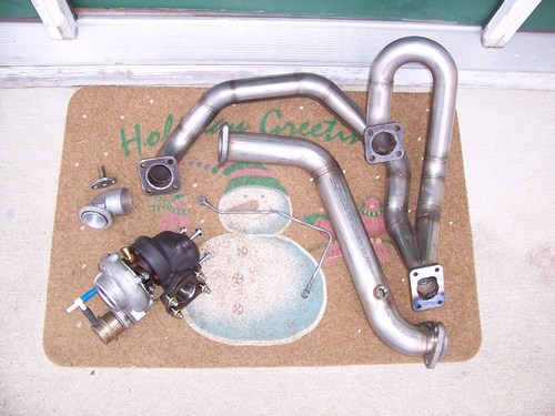

These are two types ive seen
The techworks kit was a group buy on the USMB i think
The other 3 pics are of a home made job that an american guy made out of stainless steel. I would seriously put my money on this design
He has obviously put some time into his design

The guy from the USMB that made the stainless steel crossover goes by the name of "Boosted Balls".

sorry xtreme, somehow missed your post there
the pipe size is:
just shy of 1 3/4in OUTSIDe diameter
merging into a 2.5inch OUTside dia pipe up the turbo.
so not certain what i/d would be but someone who knows what sort of pipe the exh probably used for such a task might know the wall thickness.
it's a VF12 though, so if you're not going to replace the std little huffer then I'd go a bit smaller to keep the gas velocity up, etc etc. I have no way of telling if it spools up slower / later with them as the turbo is bigger, hence it is slower to spool anyway.
