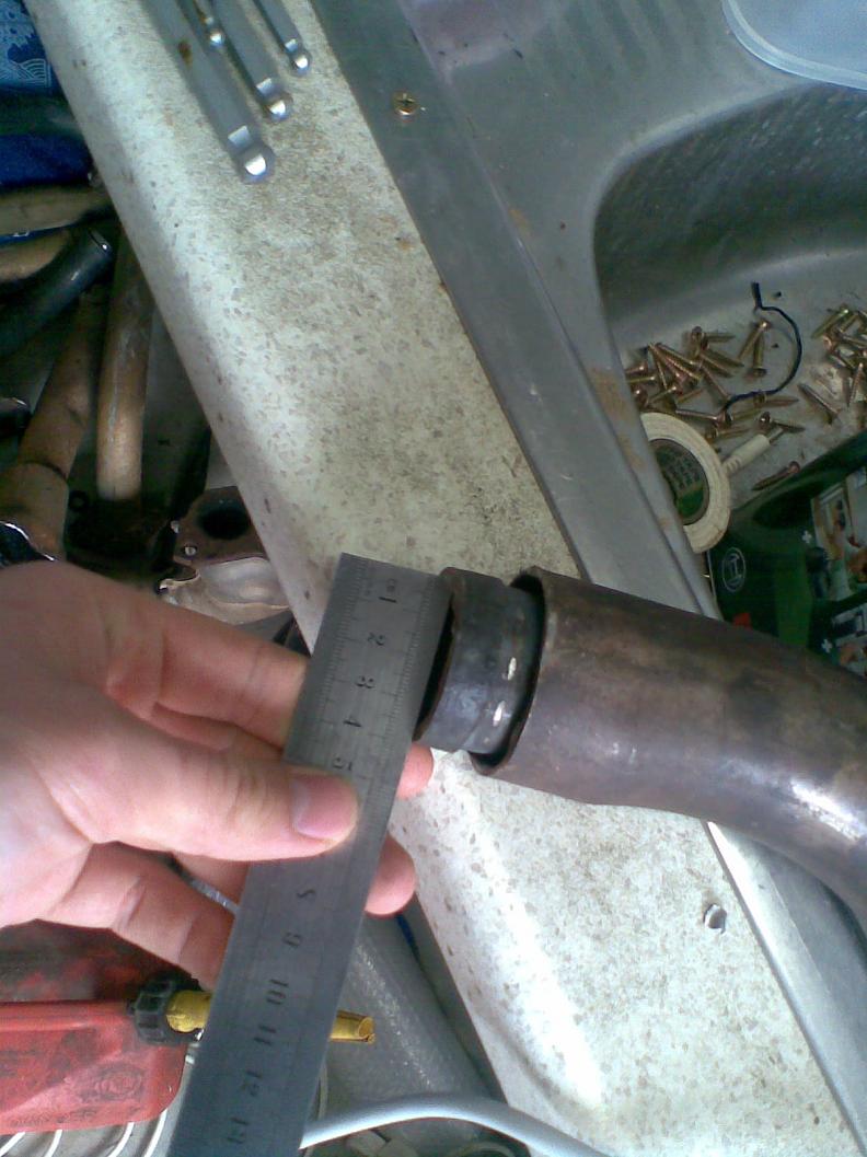

Yeah but its a double pipe, a 40mm pipe inside a 50mm pipe. The inner pipe has a 37mm IDdiscopotato03 wrote:IThe crossover pipe measures 50mm OD neat so I guess a metric 2 inch.
- Image086.jpg (97.93 KiB) Viewed 5725 times

Its all the way through (if i move the inner pipe at one end, it moves at the other end)
But i can can cut it up more if you would like.
Whatta u wanna know?

No that pretty much tells the story , the bore of the inner tube measures ~ 35mm from what I can see in that pic or around 1 3/8 .
I suppose to go up 1/4" to 1 5/8" (41mm) bore means 1 3/4 OD tube or 1 7/8" for 1 3/4" (44mm) bore size .
41 or 44mm bore tube is probably about right and would have a significant cross sectional area increase over 35mm bore .
Cheers A .
