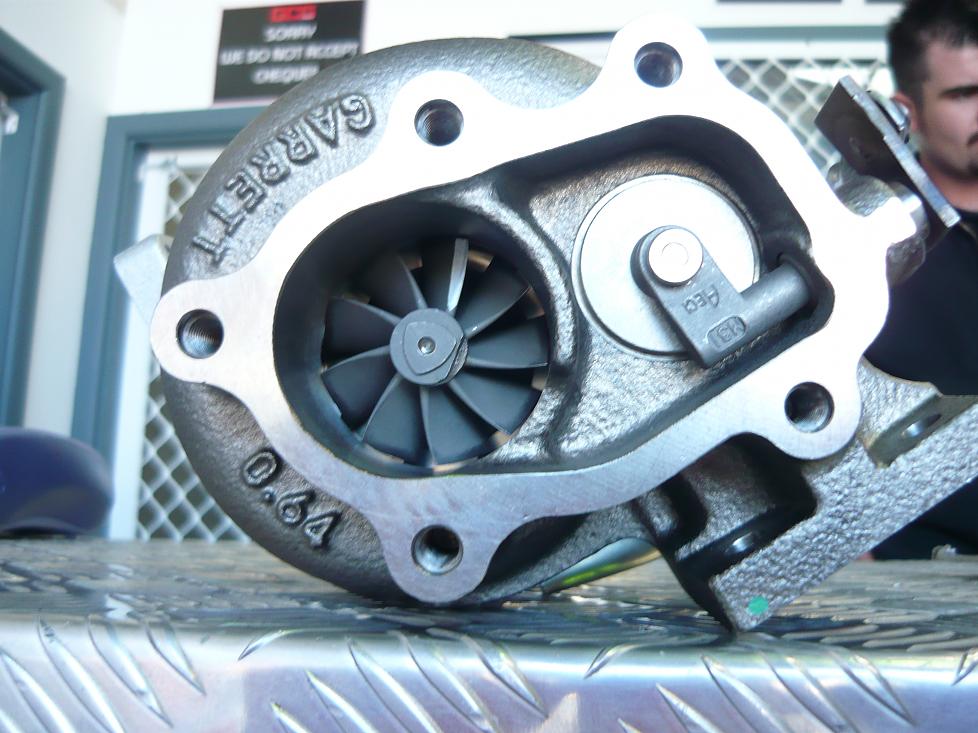

Sending Gannon a pic of the back of my turbo so you can all have a look at it .

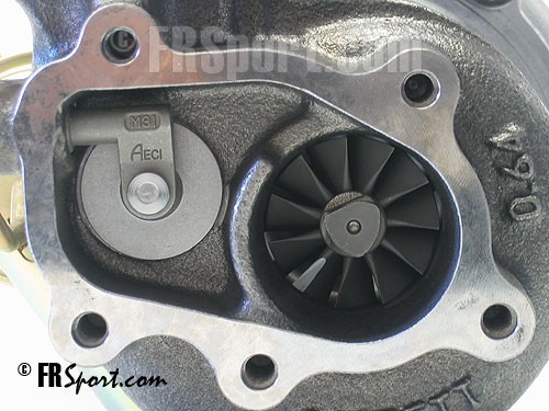

Here are those images
Adjusting the distributor to alter ignition timing isnt gonna affect anything enough to cause a problem, even if the reference marks are used for semi sequential injection, its not like you are gonna be changing it more than 5deg
- P1000789.jpg (97.68 KiB) Viewed 6397 times
- GT2560R 4..jpg (62.49 KiB) Viewed 6398 times
