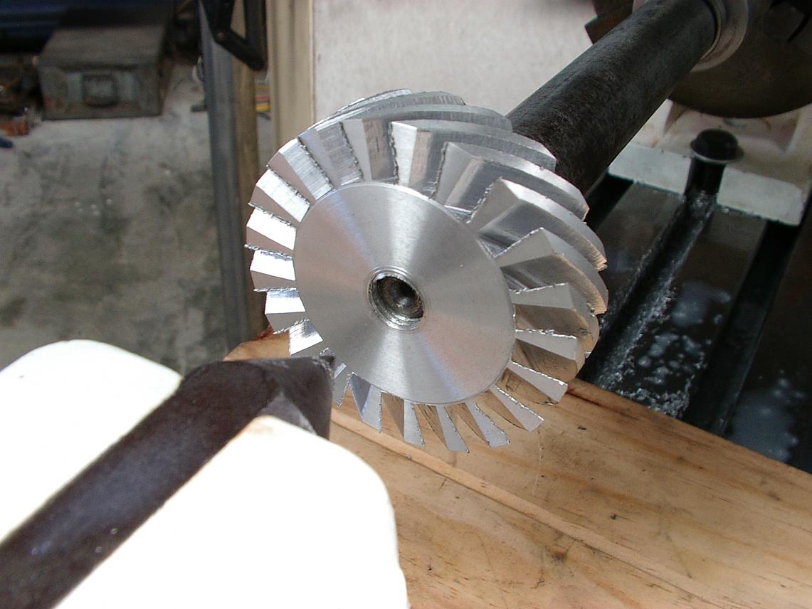

When I was a kid, my dad built a small forge out of a gas bottle and a manky old vacuum cleaner, and we used it to meld down beer cans. About 50 or 60 cans was enough to cast a cylinder of aluminium about 80x80cm. We then machined it to what we needed.
Made things like this,
Making things like carby adaptors would be easy, but something like the ea81 manifold? For low volume you probably better off fabbing it out of tube and plate steel.

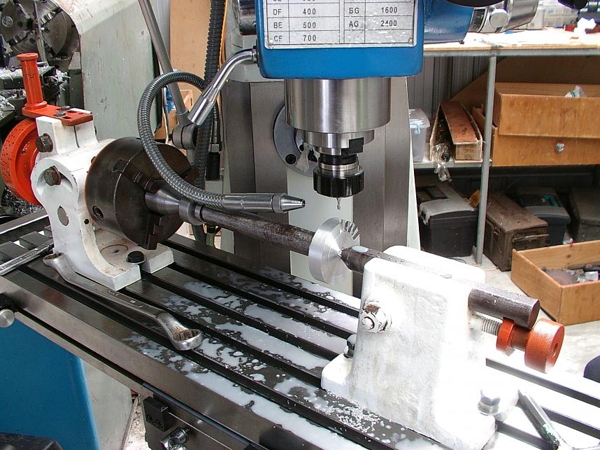

Nice one Doug, was that a homebrew CNC or was it machined manually? If the latter there's a bit of skill in that thing :cool:

Post by Subydoug » Sun Aug 31, 2014 9:25 am
All manual with a index wheel. Only got into cnc these last few years.

what is it ? curious to see thinner at base of each fin, so would be not power transfer like a cog ... 360 / 21 :) I would have gone lazier way and made it 20 fins :p

Subydoug wrote:All manual with a index wheel. Only got into cnc these last few years.
Doug
So you must have had the indexing head geared to the feed handle at the other end? To get the helix?

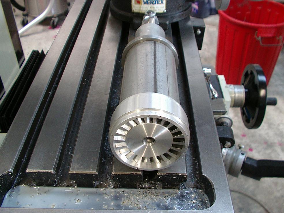

Very observant of you Jonno, yes the fins are thinner at the bottom. Ideally a V shaped cutter would be the way to go. Me and my dad were trying to build a small axial turbine. The ali shroud was also beer cans melted down.

I cant find my favorite thing we built out of beer cans. It was a valve head for a pulse jet. Looked a lot like a reed valve for a 2 stroke. lots of math ;).
