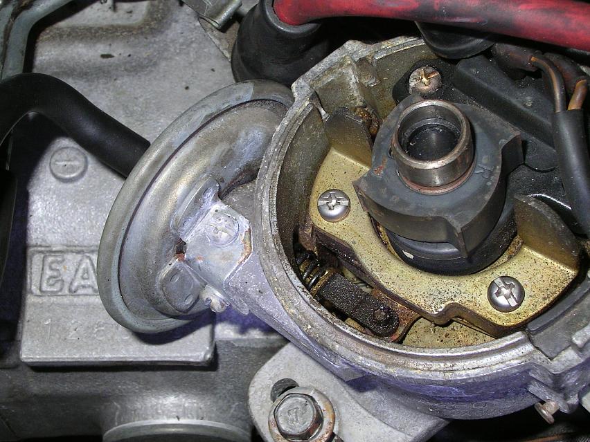

Nah the biggest faff up was the reluctor star on upside down. I want to trigger on rising edge so I want the star to swing into the sensor with a very steep angle to get the best trigger edge I can. With it on the way I have it in the pictures Id be better off triggering on a falling edge. The slower decaying slope after the initial rising edge probably helps stop the falling edge from spiking negative.

Post by Skull » Sun Jul 21, 2013 1:04 pm
The reluctor looks to be fitted correct to me, unless mine has been installed upside down also.

Yeah, I kind of figured that the "R" was meant to face up. Oh well, running like a champ at the moment so I guess Il just leave it as is.
