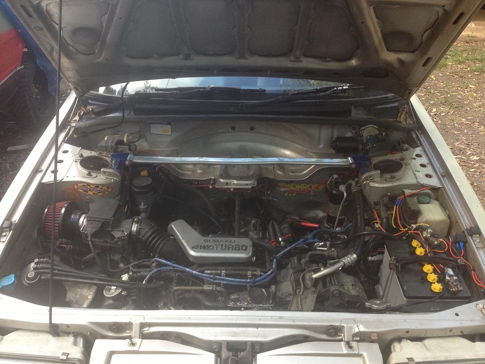

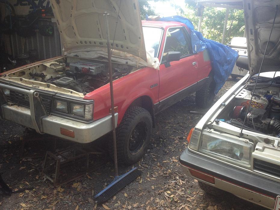

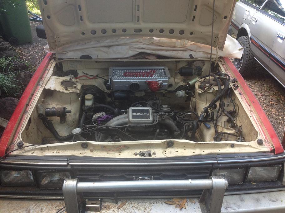

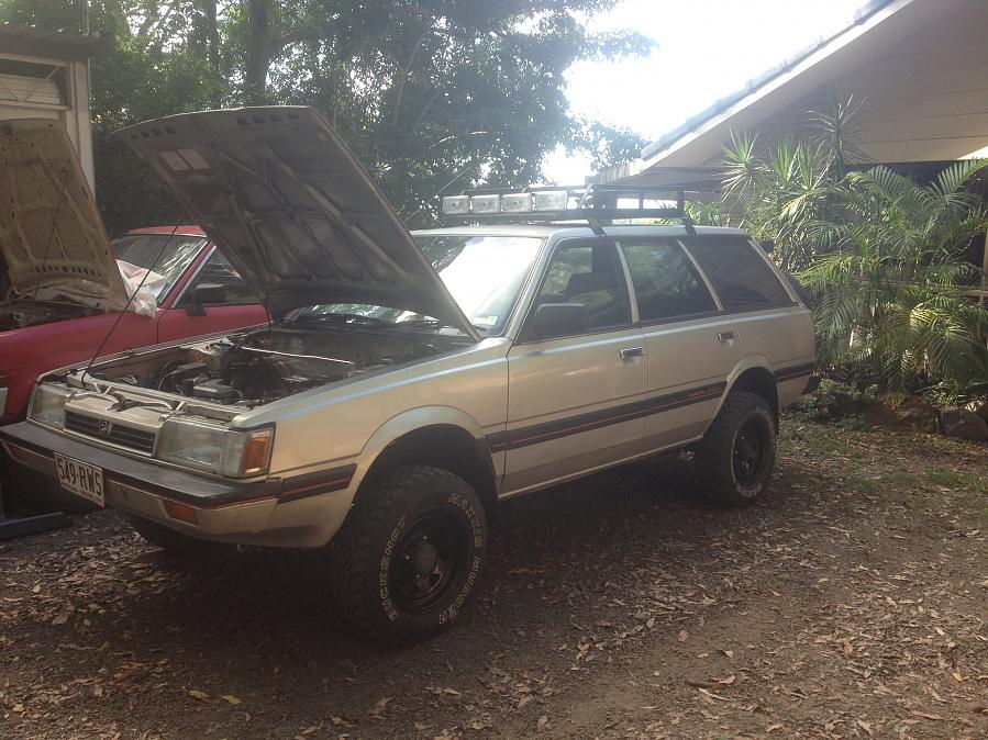

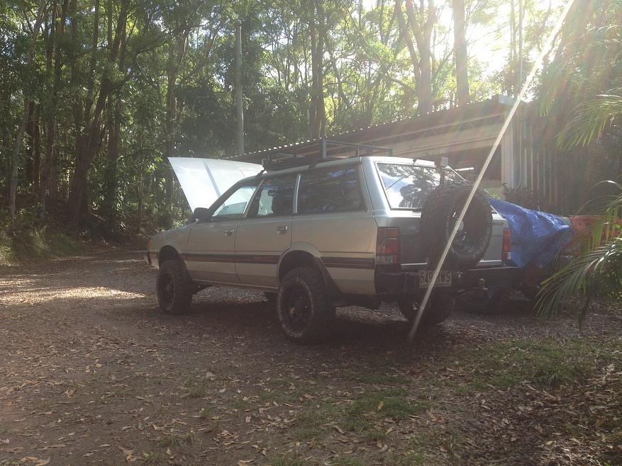

finally got around to these photos of my wagon and my mates brumby I'm doing.. and a few build pics and my shed...hope you enjoy.. loving the wagon with the new motor... :)
