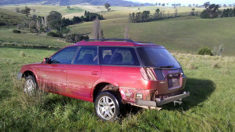

Finished and tested
The budget outback paddock bomb has been tested and works well.

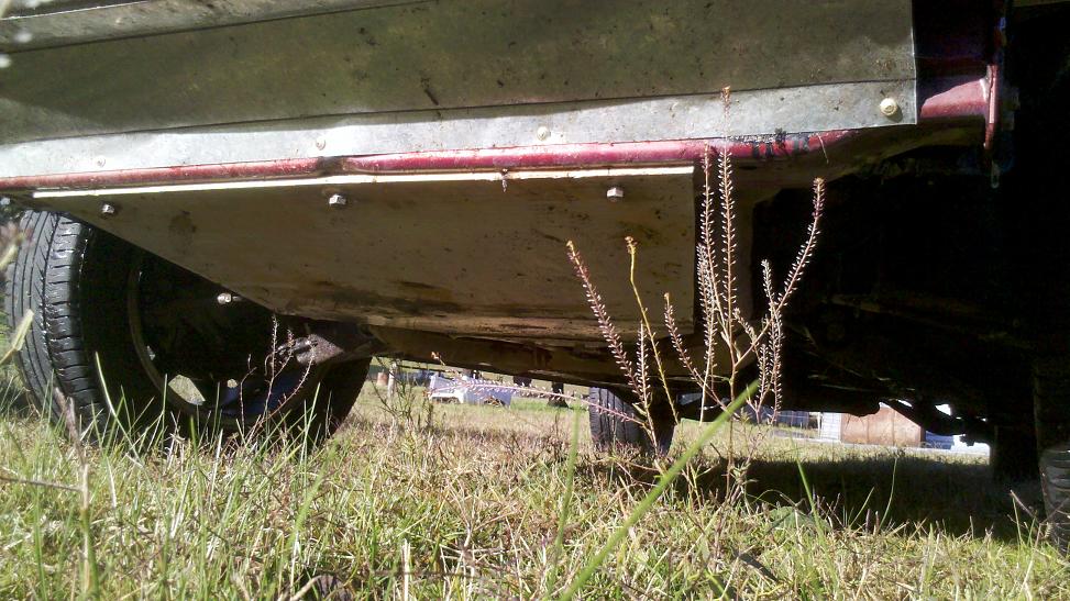

Custom aly sumpguard (made from offcut balistic aly)

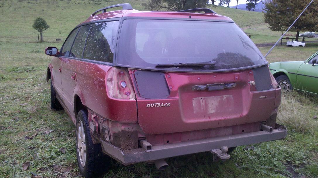

Custom rear towbar/bumper (made from offcut steel)

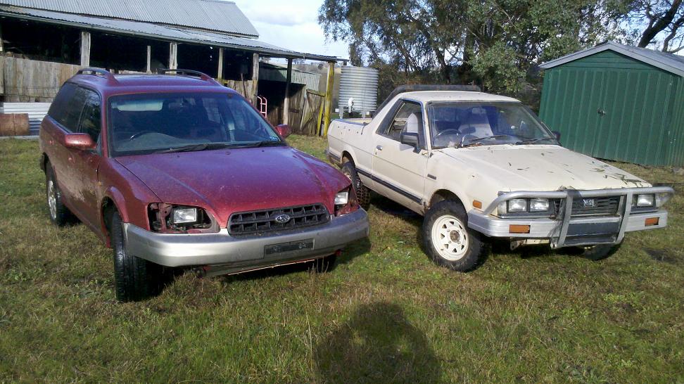

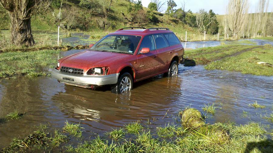

1. Made it to the back paddock
2. Family shot (1/2 the familly)

Magnificent job tambox !
love the headlights tucked safely away
set of muddies would go good, just make sure they are all the same rolling diameter
looks awesome!
looks awesome!
Like I said, these were budget basic mods.
Bumper off, a lot of engineering calculations to work out the correct towball height after lifting it, appoach and departure angles were then added to these calculations, to get the ultimate setup.
Ok I lied, the first pieces of steel near the top of the offcut pile fitted well and were the right length after some angle grinder adjustments.
What i ended up with suits me, 1. CHEAP 2. Easy to do 3. functions as required (paddock bomb rules)
