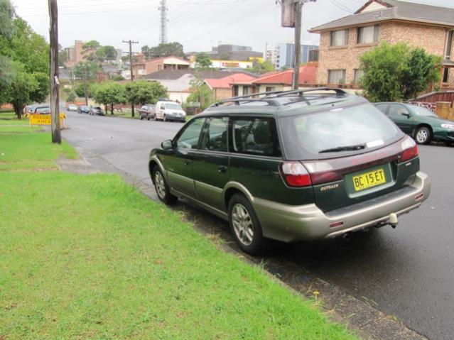

Just picked up the donor vehicle for my conversion. Its a my99 outback auto, got 240k on her but is in fantastic condition, i cant believe how well it still drives. Paid 6.5K for it, got 4 new tyres and 6months rego chucked in.
Will be picking up the halfy in 2 weeks, then i can get started on the surgery.
Its got all the panels including the bonnet and factory HID's which is a bonus.

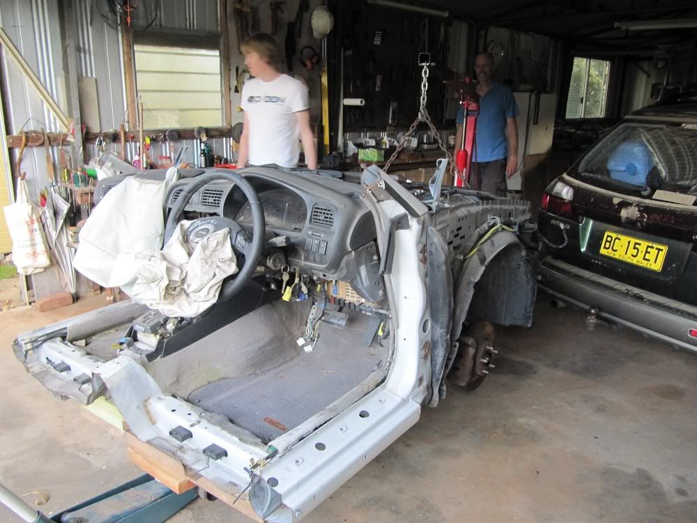

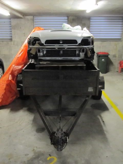

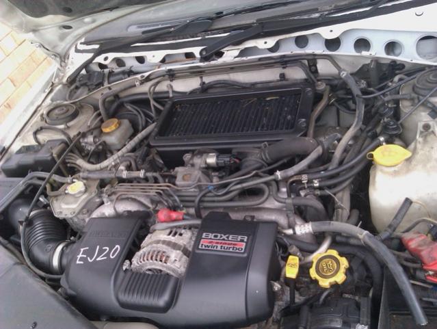

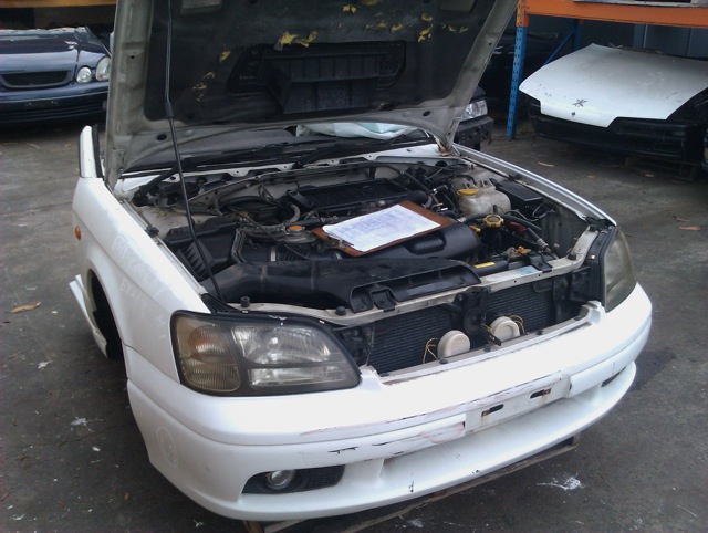

Halfcut has landed in my garage!
Went to pick it up this morning, it was about 3in too wide to fit into the trailer. We weren't really sure what to do, so we built up a bed of plastic pallets in the trailer so the halfcut could sit up high clear of the trailer sides. Probably one of the more dodgy things i've ever done, but I pretty determined to get it home today. We strapped it down HARD to make sure it wasn't going anywhere. Anyway, just took it easy on the way home and got her back safely. The old EJ25 was struggling a bit getting up the hills around Bulli, haha.
Got it started up when I got home, it runs sweet!

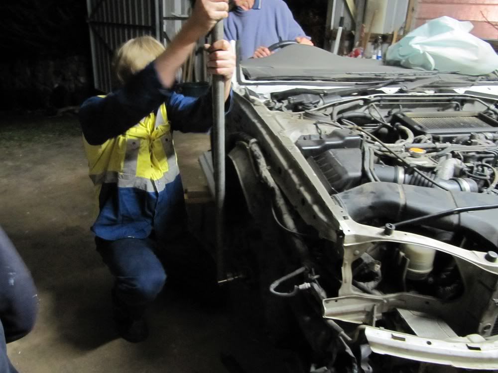

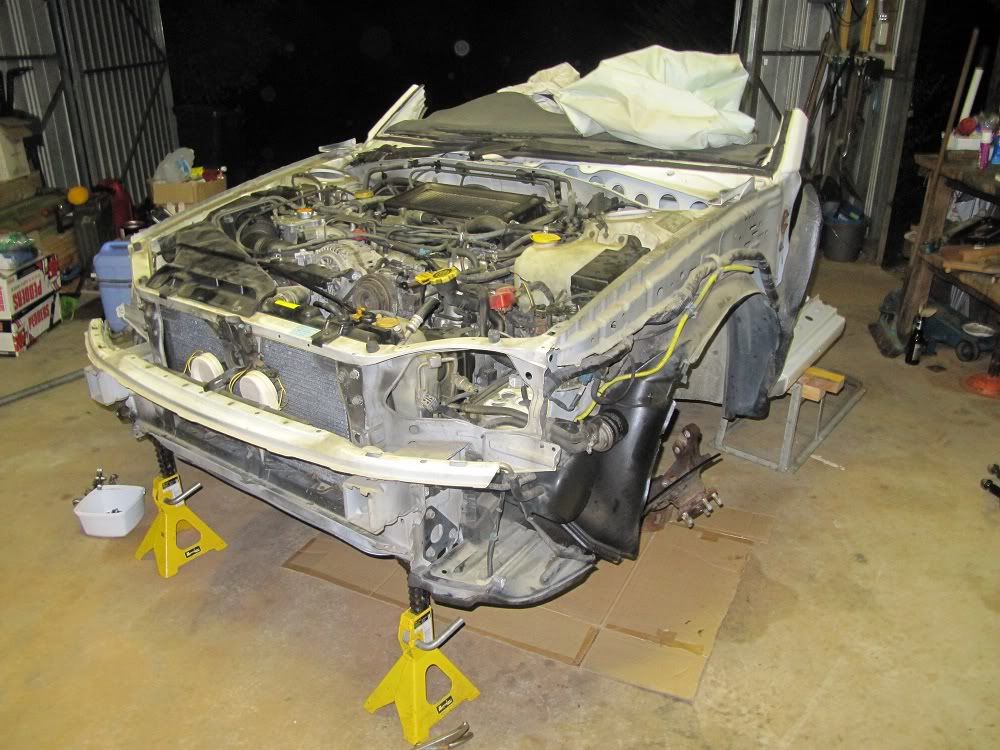

Post by tmh983 » Mon Apr 11, 2011 7:47 pm

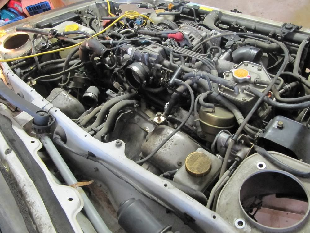

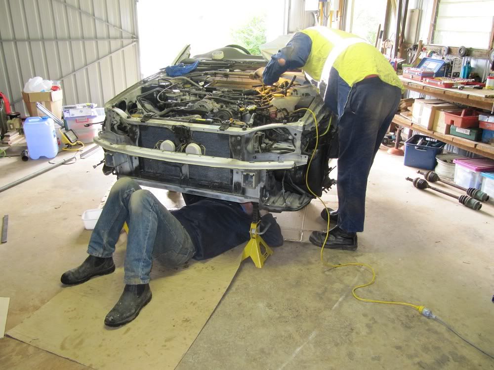

Finally, it is time!
Progress at day 1:
Pulled the twin turbo motor from the halfcut
Changed its timing belt
Fitted new gearbox seal
Fitted new dump pipes to the turbos
Removed the cross member and all the suspension from the cut.
cracking the axle nuts is always fun!
<a href="http://s1234.photobucket.com/albums/ff4 ... G_3861.jpg" target="_blank"><img src="http://i1234.photobucket.com/albums/ff4 ... G_3861.jpg" border="0" alt="Photobucket"></a>
got the intercooler out, i'm dreading getting it back in there, its going to be a nightmare to get back in.

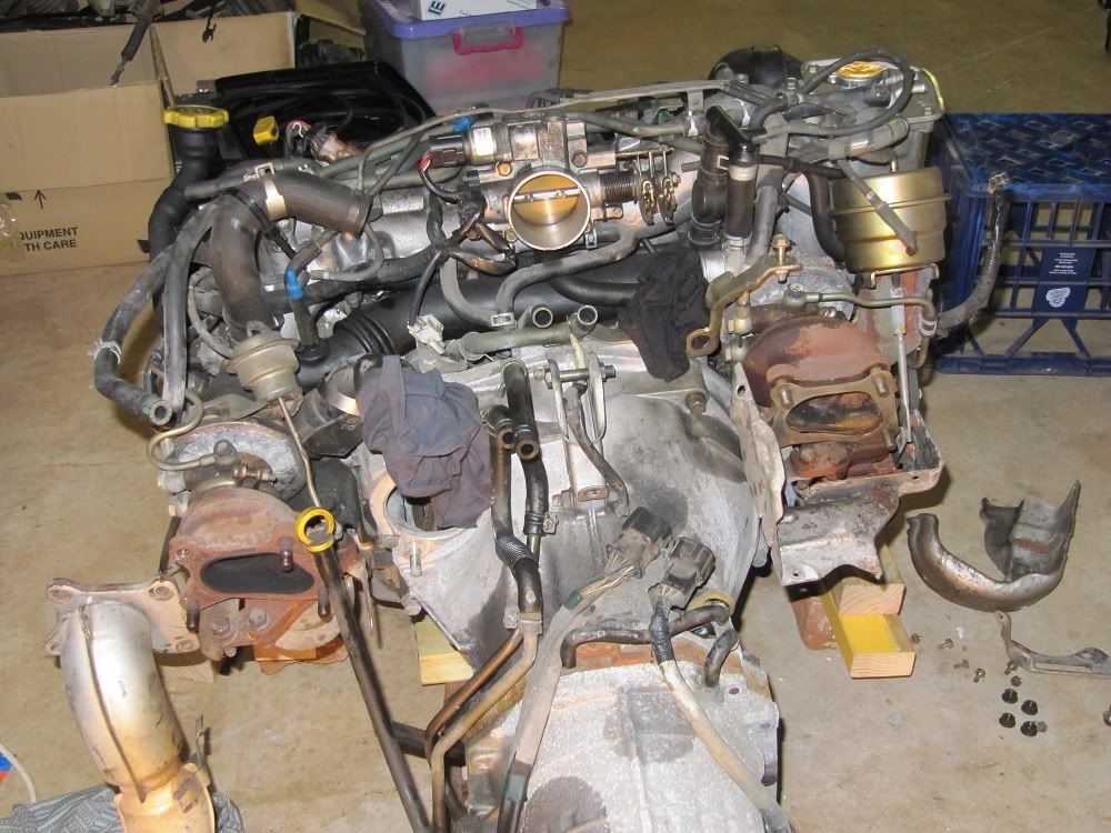

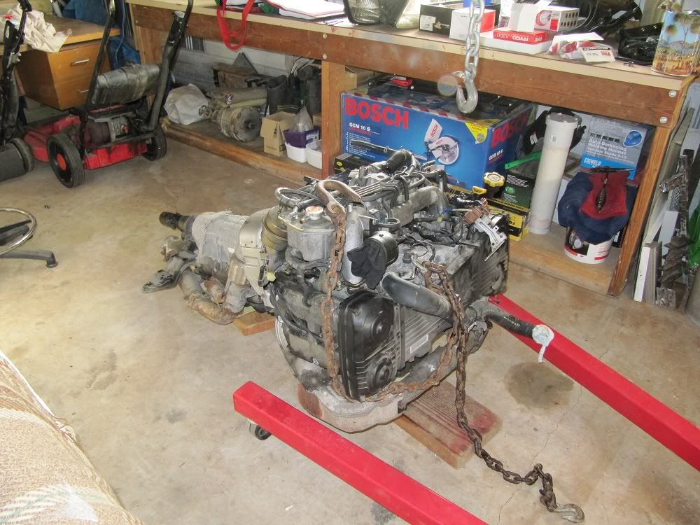

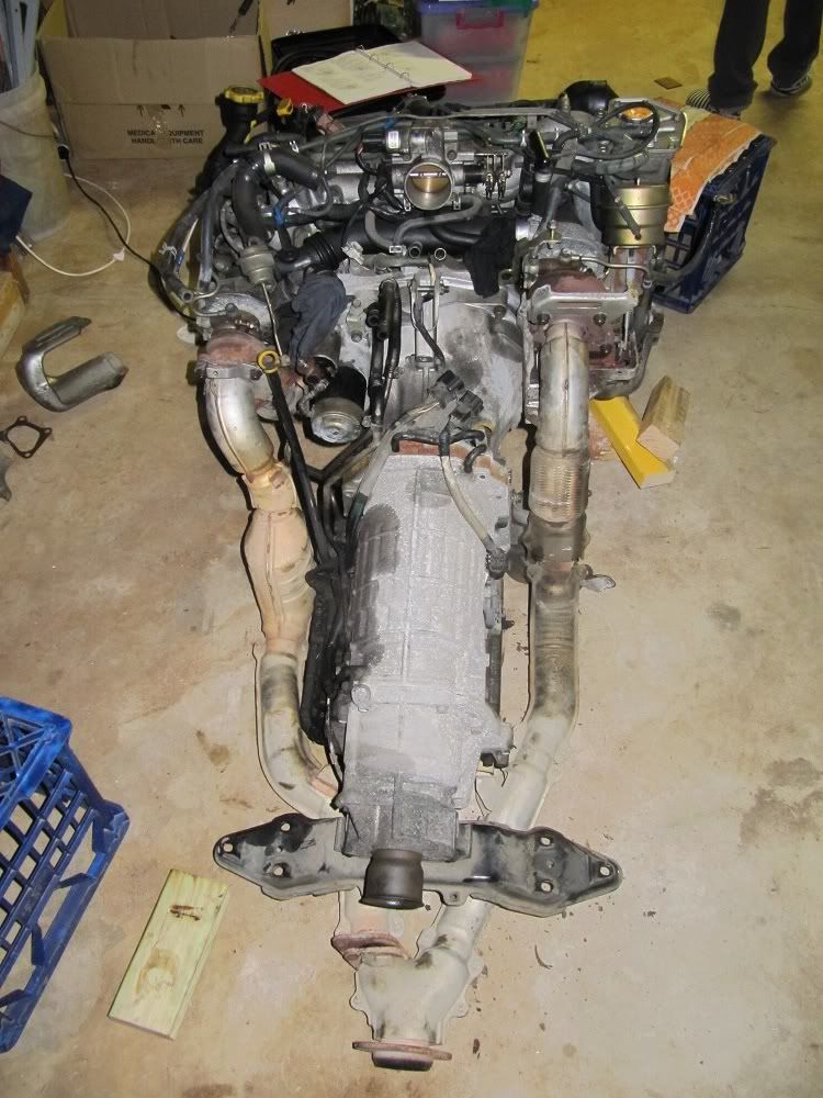

engine out
two of the tiniest turbo's i've ever seen!
new (second hand) factory gtb dumps to replace the badly rusted ones from the halfcut
