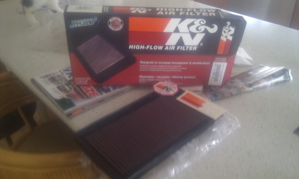

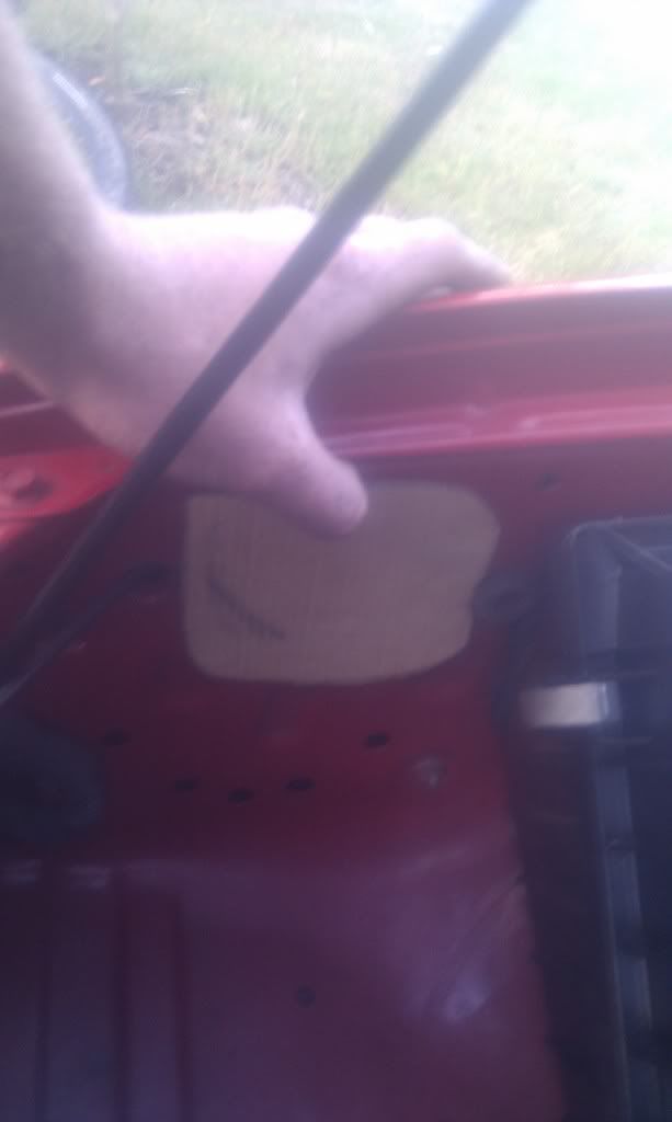

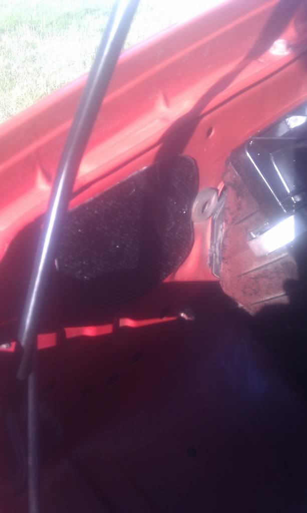

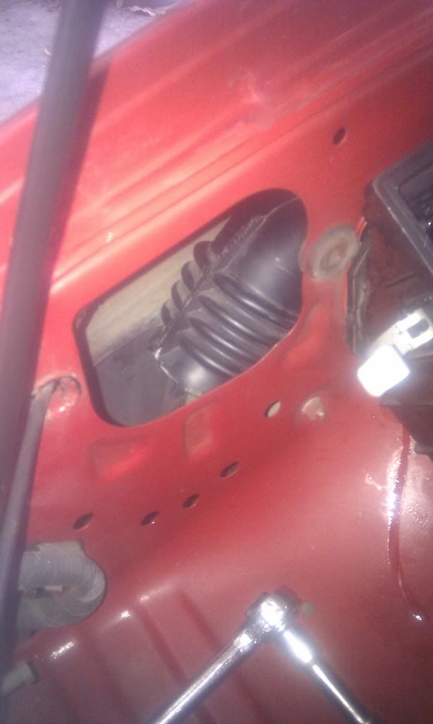

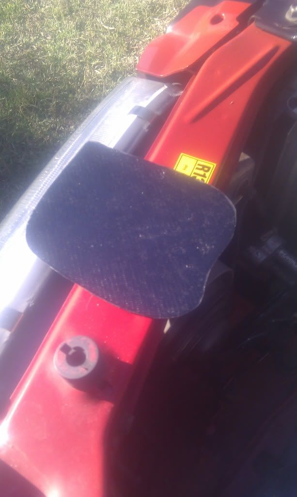

G'day gents;
I've got a little red subaru sportswagon :P and I want to extract some more performance out of it, without going down turbo lane. The reason being that I'm on my "P" Plates. Yeah, sucks to be me.
I'm taking my chances anyway with mods that don't attract attention. So What I've started with is resonator removal, which then turned into plugging the fenderwell from the engine bay hot air (thus basically making a cold air intake) and finally a K&N air filter.
I've also switched to 98 RON fuel and done an ECU reset to re-calibrate for the new fuel and airflow characteristics.
I'm going to strap some borla headers and an exhaust system on next, but I was after some reccomendations especially concerning what muffler, new cat or not, and what size piping?
Then I'll do another ecu reset/tune if I can find a local tuner. Also on the agenda is a possible rear end disc-conversion, springs/struts (Can I just put WRX wagon springs on? I'll probably lower it 25-30mm if it will improve the handling), as well as a larger diameter wheel with a lower profile tire.
Then I'll just be looking at smaller gains such as strut braces, swaybars, upgraded bushes.
But is there anything else I can do? I know that N/A tuning isn't really worth it, but there have been some pretty nice gains already, with minimal expense and work. And I could always use an excuse for more carbon bits :P
I'm going to have a go at some track racing, and I'm participating in targa tasmania in a year or so as a co-driver, and the year following as a driver. I'll probably still be on my P's, so I won't get away with any outrageous turbo fun. For the record, my little red wagon will 0-60km/h in 3-3.5 recorded via gps and stopwatch, but the zero-100 is consistently 9-9.3. Obviously evident where a turbo would be beneficial :P
Thanks;
Braden

Post by H-top » Thu Feb 03, 2011 10:24 pm
Because it is N/A and does not force air through
the intake system, you could look at making a new
intake from airbox to TB using silicone joiners and
aluminium tubing with fitting for lines.
Also oil type filters haw been known to take the
life from many Subaru air flow meters.
Keen to see more pogress!

Post by H-top » Fri Feb 04, 2011 11:35 am
Bradenrm,
it's not the Backfire that kills it, it's the oil getting
sucked from the filter onto the meter.
Backfires are uncommon on a healthy engine.
You want as smooth and gentle curves as possible
