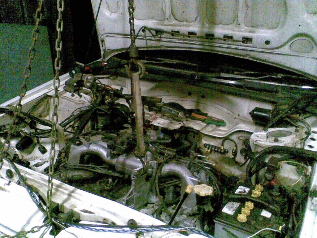

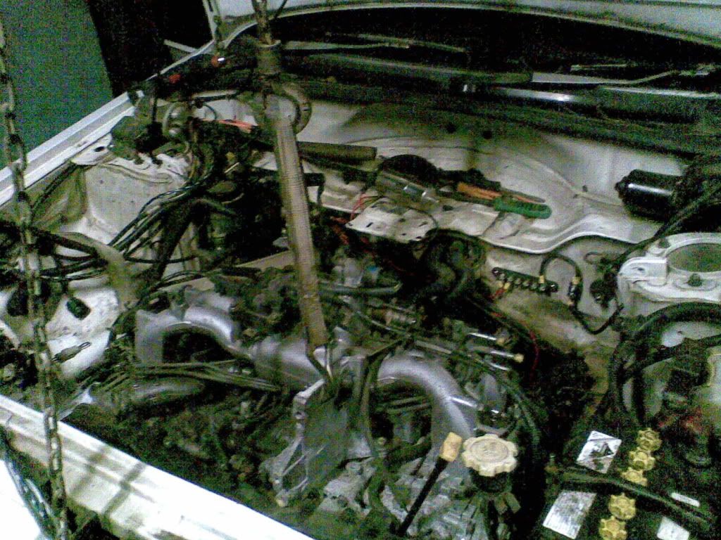

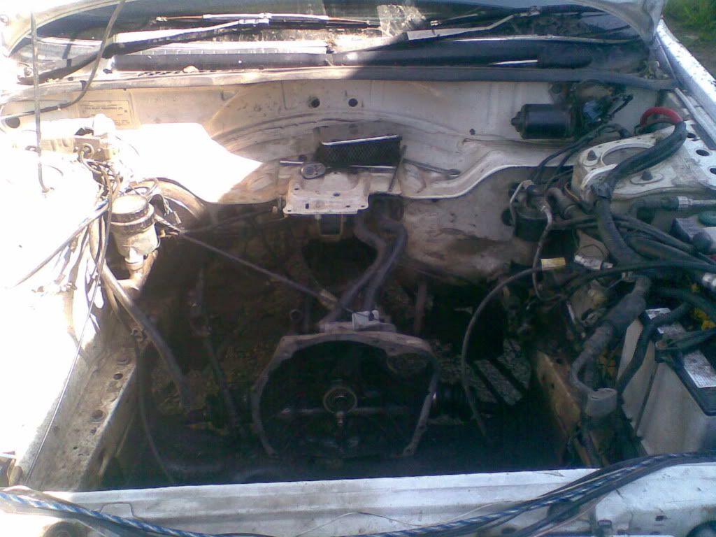

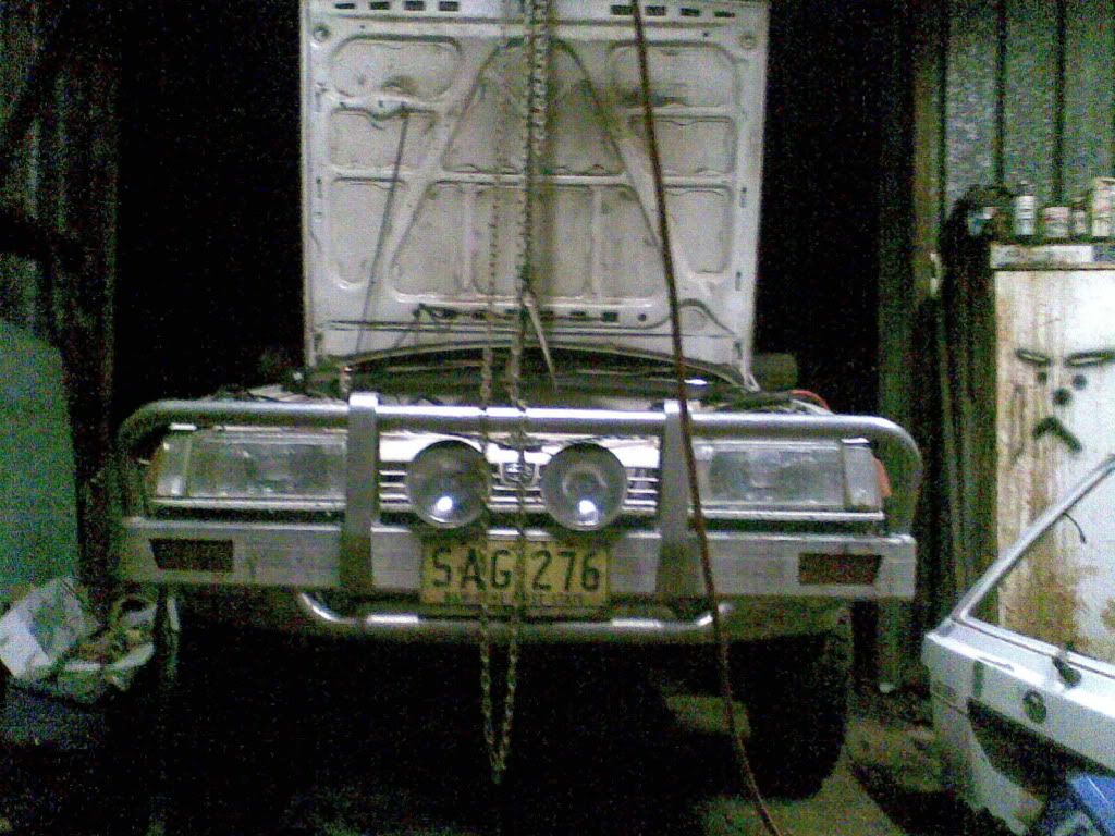

Engine out.

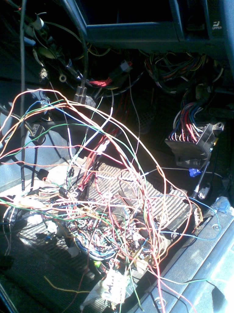

Tackling the wiring under the dash/ mounting the computer

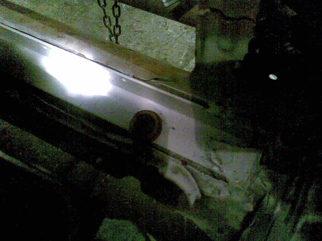

The mate, welding my new radiator support to accomodate a liberty one.
Radiator support in.

That wiring certainly looks messy! Will you be wrapping it up in tape or some from of conduit?

Yeahh got it in yesterday arvo, the old man was the 'holder of the block and tackle chain, due too non locking mechanism inside.' haha yeahh that wiring is all done now, that was just a photo of what i started with but now its taped in sections and all tied up nice and tidy. :) This is my first EJ conversion and too be honest i'm loving doing it.. Been coming home from work (working on others cars all day) and have been motivated to work until sundown which is good. :) i'll do a little more this arv and update you all tonight.
