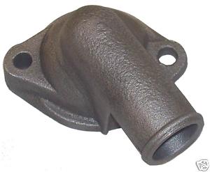

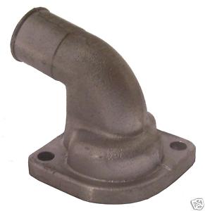

Extended thermostat housing on MY power steering? Is it taller or a longer neck ? If anyone has answer, pics or description to assist I most likely have one amongst my junk and it would be the ony part of MY power steer I would not have thrown away not knowing it was different from my 3/84 sedan I wrecked a few years back

thermost housing
Hi there,
I think the first one is the one to use with power steering
Hylton:twisted:
Hylton:twisted:

I agree.. the one on my Brumby (the complete kit that Jules got me) has a thermostat much longer than any of the pics here. The first pic from Hylton and Jules is just a standard EA81 without powersteering and Hylton's 2nd pic is for a EA82 carby model.phantomD wrote:Are you sure? Neither of them look long enough to me.

no probs.. wish I was at home to measure it. I know that the top hose is the same for non and p/s models.steptoe wrote:Paul, the longer of the two is the odd one I have, cannot be certain it was on the power steering engine, but i run the shorter ones on two non PS EA81's and standard top hose fits ???
