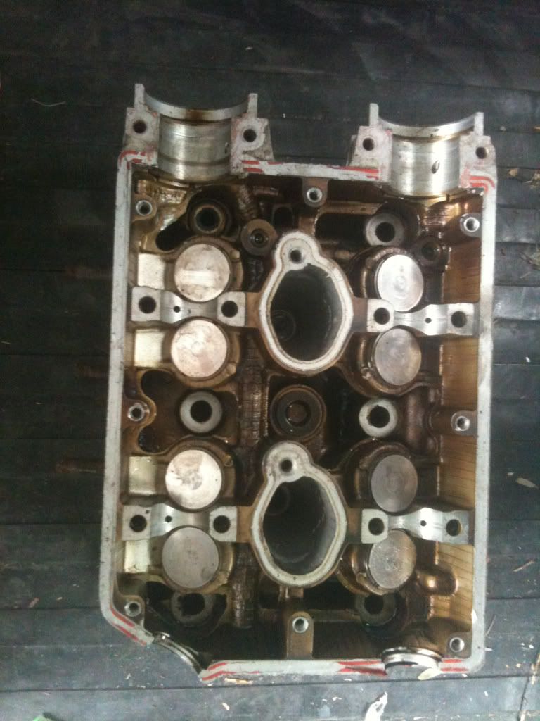

G'day all,
Well I've finally bowed to peer pressure
and advice on my $ vs KW situation
with my EA82T in my vortex.
Yesterday I picked up 2 EJ20G's and am
rebuilding 1 at first to put in my vortex.
Planning for standard + forged pistons,
ARP headstuds, Cometic heads gaskets
and portwork.
Any advice on limits of porting? Build issues
and special things to look out for?
Am also looking for at least a digital
manual for a 92 RS liberty to assist
in rebuilding with specs.
It's has begun!
Sam
and portwork.
It's has begun!
Sam

Very good combo.. tried and tested with great results
Make sure you use the WRX pistons in the EJ20G block.
Nah.. more so the valve to piston clearance.. When Subaru recalled the RS Turbo cars we had to change all pistons and heads with the version 1 & 2 WRX gear.
Another point also comes to mind.. What manifold are you planning on using?
Nice.. just remember because they are taller they do touch the bonnet on the XT.
yeah.. spacers work on the engine crossmember but carefull of the ground clearance of the sump. It will be an awesome car once done
