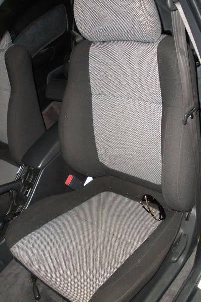

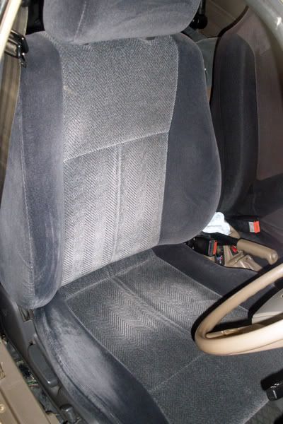

Been wanting to upgrade the seats in the wagon for a while now and finaly got the oppurtunity when I replaced the seats in my ge2 Liberty.

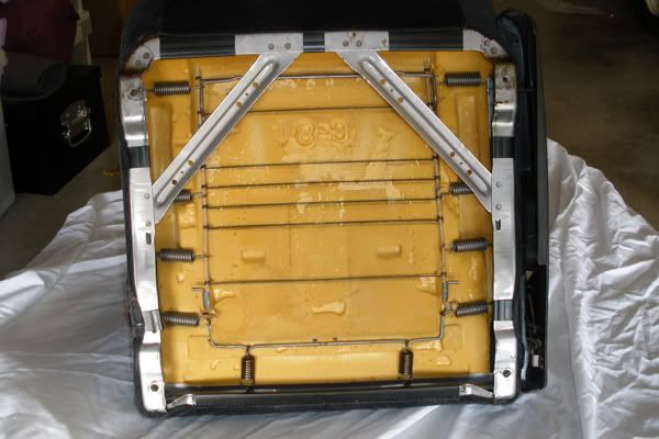

Started with the passenger seat and to my delight the rails on the liberty seat were bolted on. The MY seat rails are also bolted on so things were looking good. So took the rails of the My seat and put them on the Liberty seat.

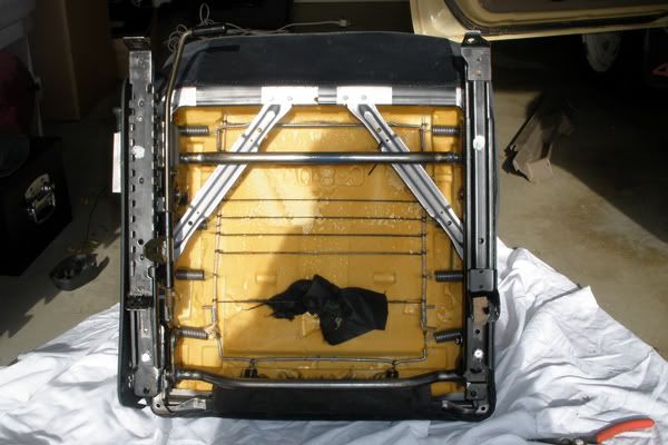

Original Liberty seat.
No rails

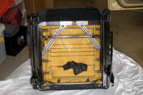

My seat rails on
The my rails bolted to the front holes on the liberty seat but I had to drill new holes to bolt the rear of the rails into.

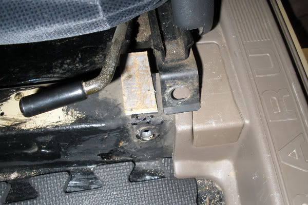

I then sat the seat into the car. The side nearest the transmisson tunnel fitted perfectly. The side nearest the door not so good.
Door side front
Door side back
So I just re drilled some holes to suit,

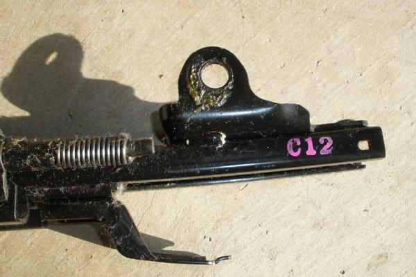

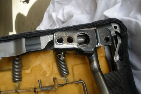

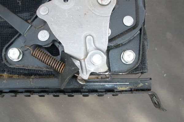

The drivers side was to so easy as the rials were attached differently due to the height adjustment
Front rail mount
The MY seat rail bolted easily to this. I had to grind off the rear of the liberty rail to modify it to suit the MY rail.
Back section to grind off
Gound off piece installed back to liberty seat.
I was then able to mount the MY seat rail in the same way I did on the passenger seat. I then installed it into the MY wagon in the same way that I did on the passenger side.

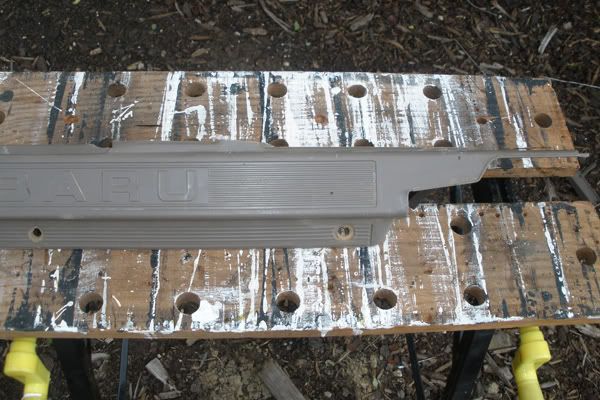

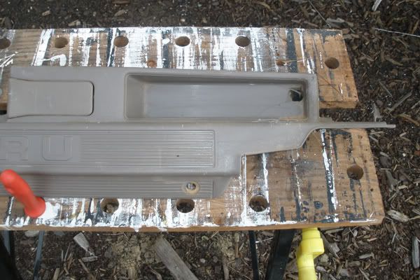

The other mods I needed to do were the plastic door step trims
Before
After
I also had to trim a small piece of metal off the door side of the passenger seat, and some plastic trim on the seat as it was catching as you slide the seat back
Before
After
Installed

What did you fit into the Gen2?
Some impreza seats that I thought would fit in the "my" wagon, but did not fit and would have required work with a welder which I dont have.
So I thought I would try them in the liberty and they were a straight bolt in
The seats looks wider than MY is that right? or just the rails?
Yep seats are definitely wider but still fit ok. just a little tight on the passenger seat near the seatbelt retractor

Would you have more pics of the driver side set-up? did you end up keeping the height adjustment feature?
Dont really have any other pics, the liberty seat rails come off with 4 bolts. Once the rails were off I then had to grind off the bracket from the seat rail. It then just bolted the bracket back to the liberty seat.
I could then just bolt the "my" rails to the seat, only needing to re drill 2 new holes.
By doing this I did manage to keep the height adjustment
