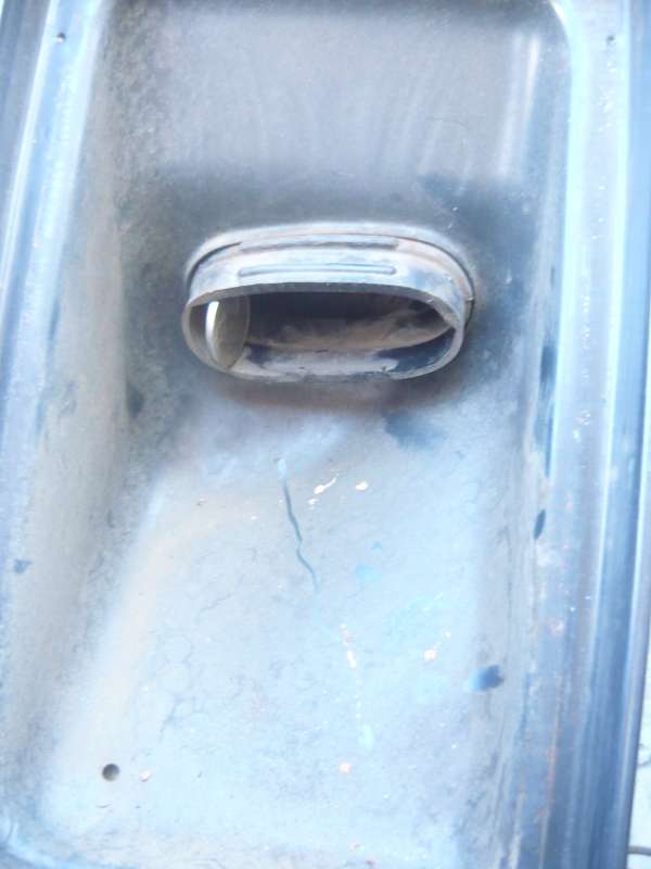

I managed to move the plastic arch liner enough to get a look at the chamber and its ducting . There looks to be two plastic Phillips head screws towards the front of the liner that won't come out .
I did try to remove the duct that picks air up from behind the headlight but you can't rotate it far enough to get it out of the chamber with the guard in place . I don't like to cut things if it can be avoided until I know they're going for good .

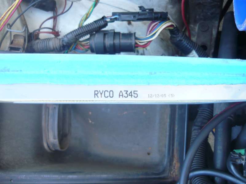

The feedback about the common MPFI L/XT4/XT6 air box is that the filter element itself is not the restriction so there is only very small gains to be had changing the element itself to a higher flowing one .
People OS are saying that if you can remove the restrictions in the lower half of the air box you are doing something useful by fixing one of the std boxes problem areas .
I reckon there are possibly ways to improve the passage in the upper half of the air box to the AFM .
Yes we did think about removing the air box completely and moving the AFM closer to the inner guard and housing a pod filter inside there .
Legally you are supposed to have an enclosed filter element and I imagine that's for fire reasons , don't know just want it to appear legal .
The other thing is it makes changing or cleaning the element much simpler having it in the engine bay .
So the aims are less pressure drop between the atmosphere and the turbos inlet and less exhaust restriction overall .
If the volumetric efficiency climbs then its all cake and will show up as more torque everywhere .

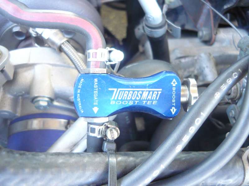

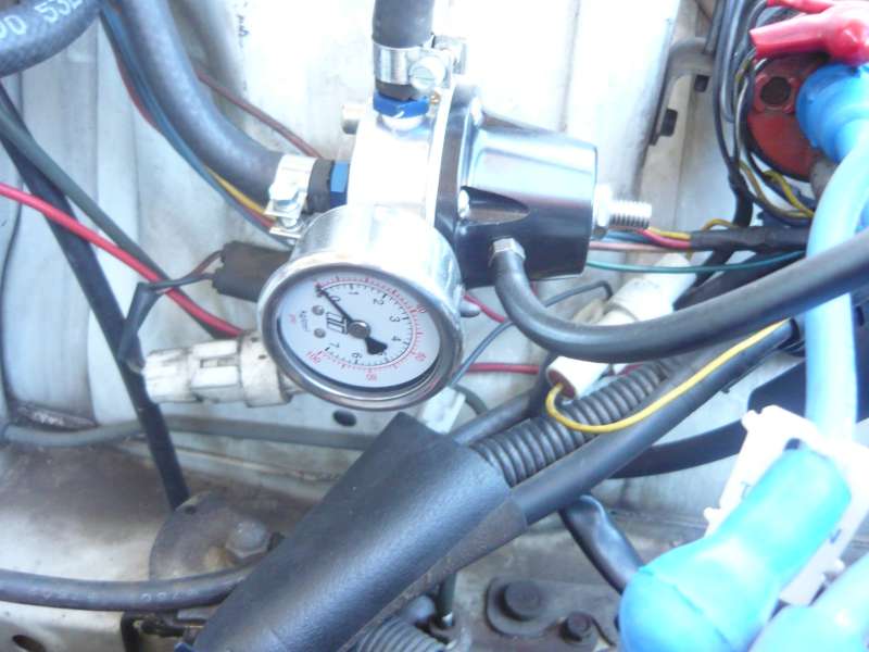

Controlling boost pressure is not a problem with these turbos , for the record my turbo uses the actuator intended for an XR6T so its supposed to regulate at about 6 1/2 pounds of boost .
When you size turbos a tad big on the hot side they tend to make good airflow at low boost pressures anyway . They also tend to climb into positive pressure slowly at the boost threshold so the actuator isn't being "rushed" so to speak and has no dramas doing its job .
I got a near new Turbosmart boost T for a good price so that adds a degree of adjustment .

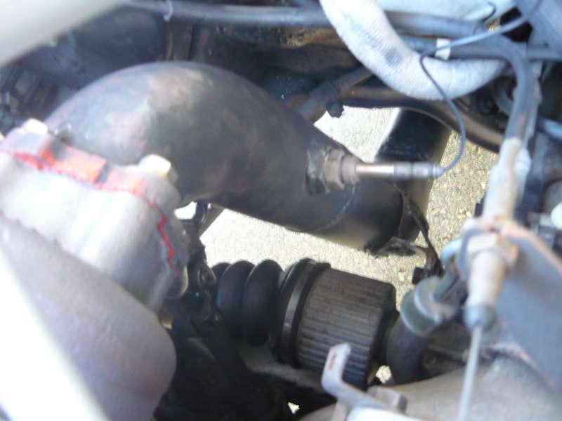

I use a Tech Edge WB3A2 wide band and it doesn't read off unworkable AFRs though on boost it used to go really rich like more than 10 to one with the other 2.25 engine pipe . It also gets used in an R33 I have and I must put it back in the L Series when the exhaust has been enlarged . The last time it was in the Roo it gave no indication that the engine was running out of injector/fuel . I also have an adjustable FPR so could push that a little if fuel pressure was marginal .

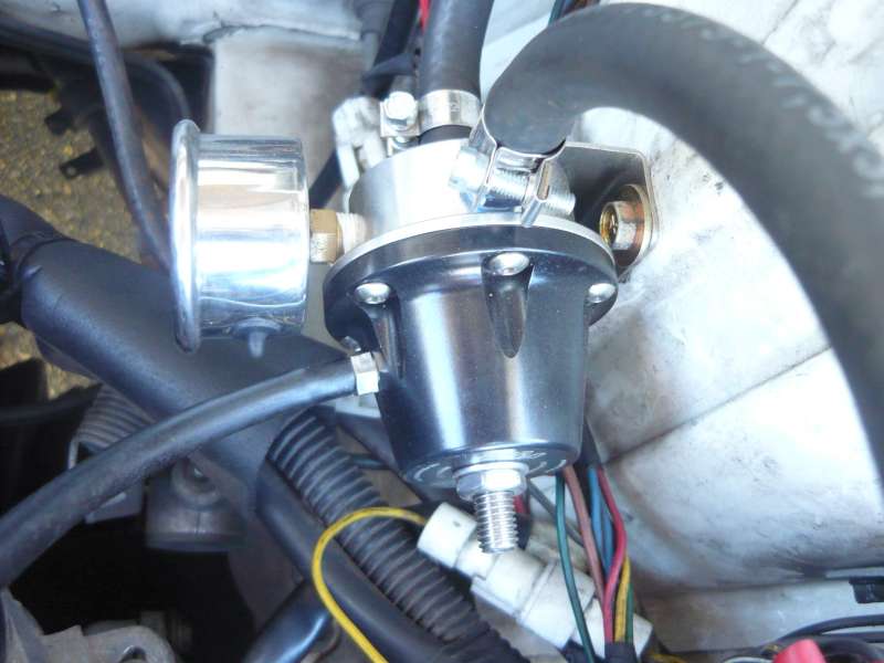

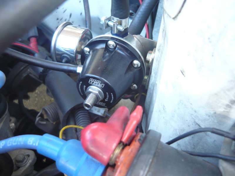

My fuel pump was changed for a VL Commodore Turbo (RB30ET) one because I didn't trust the up to 24 year old OE style pump .

A bit hard starting a hole saw with nothing for the drill bit to locate on .
I want the hole to be ovalized because you can use larger diameter tube I think than the vertical high of the boxes duct section will allow .
The reason I don't like TMICs is because they do SFA at low speeds or stationary . Also , IMO , the air scoop makes a L Series look a bit boy racer ish . I think Ls need as much airflow space in the engine bay as possible to make the cooling system work . Also I can see a few things being hard to get at with the TMIC in place .
Actually another thing I have to get around to is making up a couple of spacer plates to get the bonnet hinges up a little for better flow through the bay .
Gannon did you get those pics I Emailed to you ? The ones of the lower box section and its duct would be good to see here .
Cheers A .

Hi Gannon , that last one tells the real story .
That's a twenty cent piece balanced in one side of the lower half of the air boxs inlet duct from the inner guard .
With a 3.5" "pipe" feeding into it you'd have to say getting more than the standard cars 115 Hp worth of air would be much easier .
Did you get the shot with the std Ryco element sitting sideways in the lower half ? Also the adjustable fuel pressure regulator .
Thanks again , cheers Adrian .
