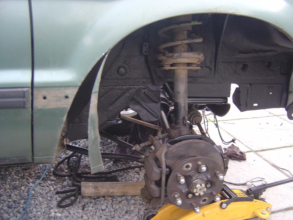

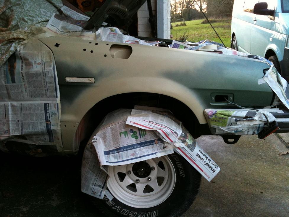

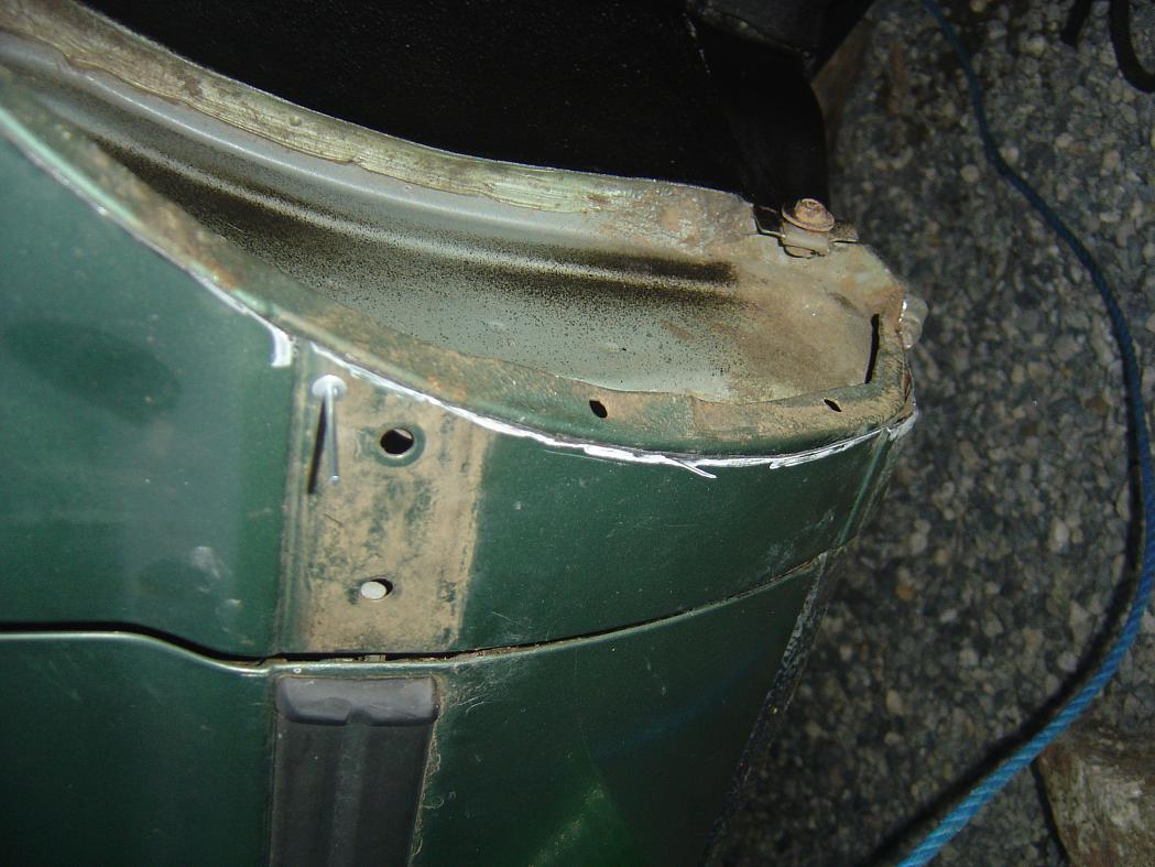

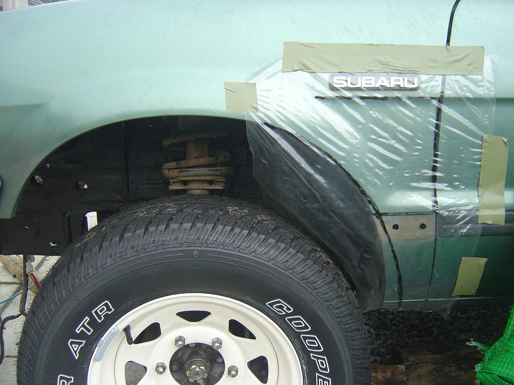

Just done mine. I used clear plastic sheet and black marker pen to make a template so both sides came out the same when I cut. Then I made one cut from the bottom to about third of the way up the wheel arch but still keeping the cut metal joined at the top and then folded it behind the remaining arch. Drilled a couple of holes and then pop riveted and glued the flap in place. Bit of filler and primer and its come out seamless.

- IMG_0024.jpg (104.9 KiB) Viewed 4315 times
- DSC00760.jpg (104.96 KiB) Viewed 4316 times
- DSC00756.jpg (106.21 KiB) Viewed 4318 times
- DSC00754.jpg (105.9 KiB) Viewed 4321 times
