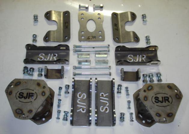

I was looking at new lift kits. Could someone tell me the diference between those to kits. One is SJR american kit and the other the HIrise kit. I see that the hirise have blocks but the SJR u shape bars. Would that make a difference? any ideas?

I've been talking to the manufacturer of the SJR lift kit(first pic) and this is what he said....
"solid blocks or bent peices, I would think they are comparable , I have installed both and the long bolt type if you dont get everything lined up just right its easy to crossthread those fine thread bolts, which I have done as a mistake before, I personally havent seen either type fail"
any comments??
thx
any comments??
thx
I'm sure his kits are fine, if he continues to make them that way and they havn't broken for his customers. That being said I think the other type is bound to be stronger. Yes it is easy to crossthread the long-bolt type, but not if you are careful during installation - there is a technique. Once it's installed, it's done anyway, no need to worry any further. Best to get somebody with experience installing them to give you some pointers in person at the time.
I think you're better off getting a superior kit locally rather than overseas, I'm sure the BYB guys would have responded to your "wanted lift kit" advert by now anyways.

The SJR kit(see pic) cost US$610 incl postage but thats the Bent steel kit. Description:4" Lift Kit fits EA82, keeps rear swingarm pivots up in stock location adds 4" lift at front and rear, adds 1" clearance, stearing shaft must be lengthened (not offered at SJRLIFT )
The Byb Lift Kits will cost me AU$700 solid block kit.
What would do??
I think with the conversion the AU$ they would be about the same price. Cheaper would be better but i dont want to get some shit kit...
..... any bright
Thx much apriciated
What would do??
Thx much apriciated

My (largely uninformed) thoughts:
-I wouldn't be too concerned about the relative lack of stiffness of the SJR blocks (that aren't really blocks). Subarus are floppy, lightweight vehicles, so when you add great strength to one small area, you just exacerbate a weakness elsewhere. Slightly deformable lift components will not transfer as much load into the body as rigid ones, so you'll be less likely to rip captive nuts etc out of the floor.
-Keeping the rear semi-trailing arms in the stock position but pushing the strut down 4" would leave you with bugger all downward travel. Having the diff a bit higher is a good idea though.
-The lack of a steering extension from SJR creates more work for you.
-The exchange rate right now makes the SJR kit $763.
-Local suppliers are generally easier to deal with, and easier to go back to if something goes wrong.
Based on all that, I'd go for one of the Australian kits.
Dane.
Dane.
Better to buy local, easier to deal with. Also the BYB kit (afaik) also comes with the extended steering linkage, it's hard to get this done separately by people as they don't want the liability of welding steering components, I spose you could get just this 1 bit from BYB. Keeping the diff abit higher will gain you some extra clearance but at the expense of the longevity of your rear CV's. You could ask them to customise the lift kit for you but they may not like being told what design works best lol.
If you got the SJR kit you'd prolly be the only one in Australia with one.

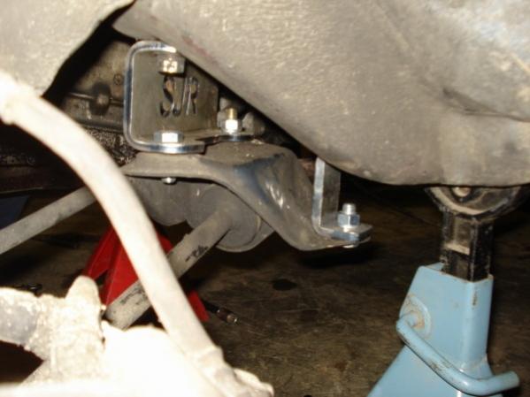

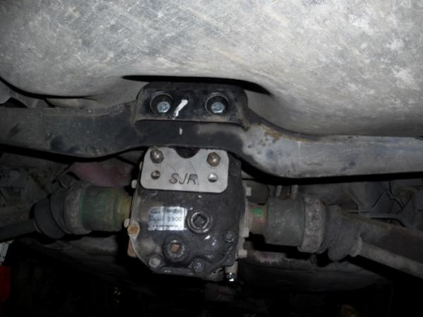

here are some pics of the SJR kit and how its bolted to the car.
Comments....
thx
Comments....
thx
