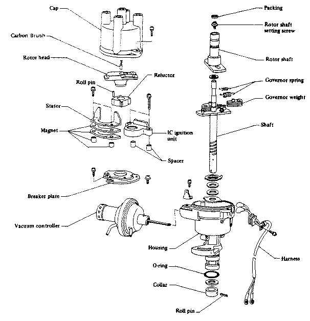

Cheers Steptoe, but being new with re-curving dizzy's you're gonna have to hold my hand a bit!
I found an exploded view of my Hitachi (or near enough to), which bits did you mod and how does that alter the curve? Did it help a lot with power and economy? I'm hoping so as mine is chewing the gas.
I had a 32/32 Weber onboard but could not find an LPG mixer to suit, so I had to revert back to the old stockie peice of s**t. I've got a 2L Toyota throttle body that I will put on a soon as I get around to crafting up an adaptor plate.
Any more tips on dialling in the EA81 for gas would be greatly appreciated. As it stands she's stock as a rock. Cheers again for your help Steptoe.

Not sure where yer hands have been, but here goes...
I have not done this for a while but I remember
1.0 Under the rotor button in the shaft, is a screw under a plug. REMOVE
2.0 I remember prising the electronics reluctor thing off with a flat blade screwdriver either side. This has a small roll pin that sits against the shaft, let it stay there and this should also indicate UP for you on reassembly
3.0 Maybe just the two screws at the side holding plate to body UNDO. NO NEED TO UNDO OTHER SCREWS holding components together
As the centrifugal weights fly out, they have fat pins going UP through the slots on the tangs at the base of the rotor arm. By limiting how far out they are allowed to travel towards the outer you are limiting the mech advance
As far as economy, best is 60litres 500Km, regularly do 540km to 68 - 70 litres
Search STEPTOE and HITACHI in last few months and you may find some good reading (maybe not!! )
