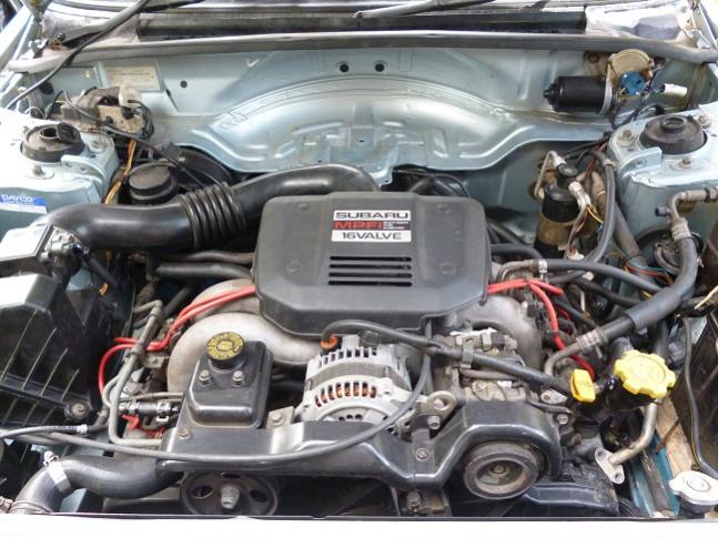

finished engine bay:

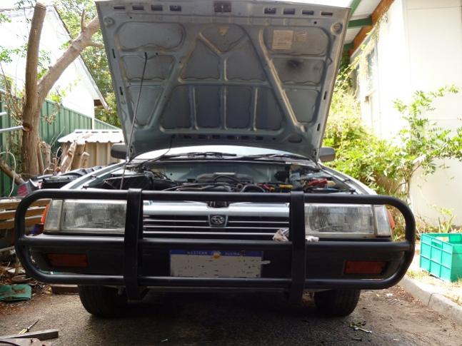

new lick of paint on the roo bar:

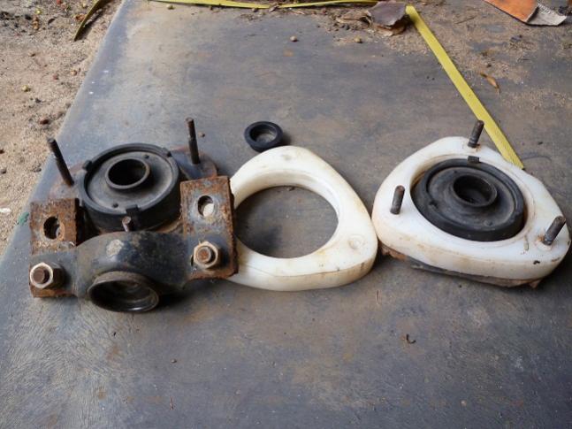

my dodgy homemade strut lift (currently not in, but will be again soon):
[ATTACH]3260[/ATTACH]

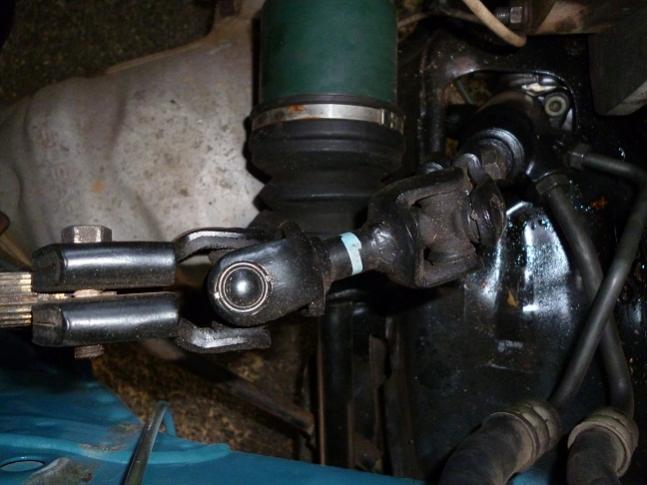

The liberty steering knuckle to lib power steering, which there was some debate about a while ago:
[ATTACH]3262[/ATTACH]

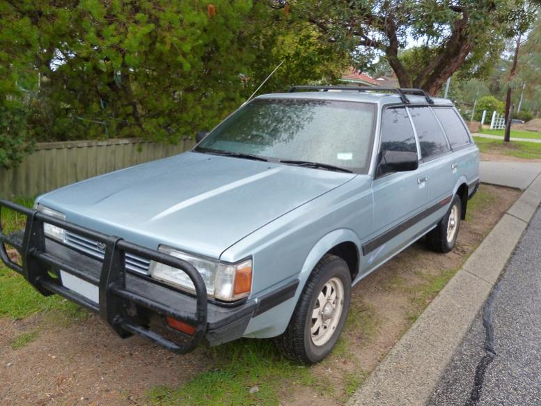

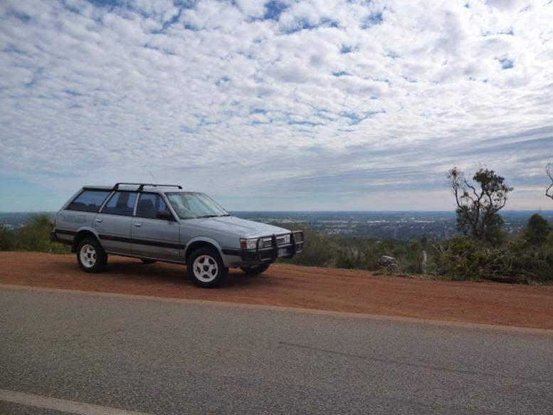

and a pic of what it was when it passed:
[ATTACH]3439[/ATTACH]
Post by TOONGA » Wed Jun 20, 2012 11:02 am
A job well done and looking very stock.

MTB92 wrote: The liberty steering knuckle to lib power steering, which there was some debate about a while ago:
How did you do that?
I have a Liberty rack in my Leone RX and it sat like this
So I shortened the steering column shaft so it would slide further up.
Is the shaft sticking out of your Lib rack as long as mine?
MTB92
Posts: 204
Location: Koongamia WA
Post by MTB92 » Sun Jun 24, 2012 5:50 pm
yeh, it seems to be the same gannon. although, it loks to me like the shaft is angled back towards the driver a bit more on mine. i think we came to the conclusion that the fwd and awd have different set ups. i am not exactly sure why or in what way, all i know is that mine bolted straight up from a fwd A/T gen 1 series 1 liberty.

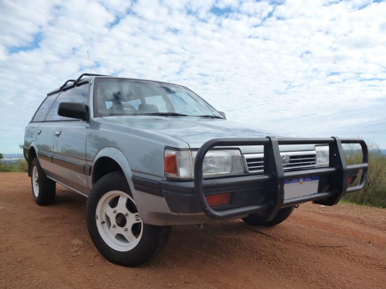

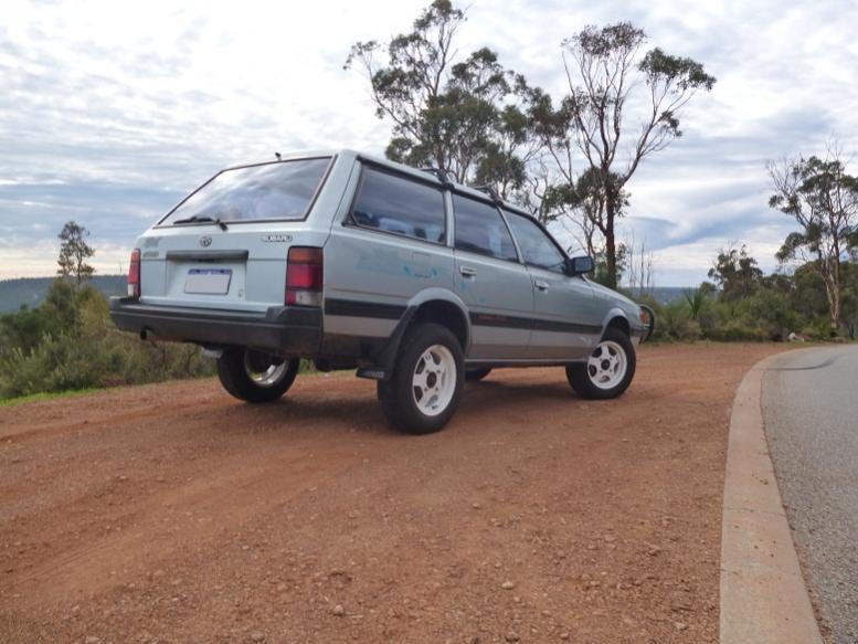

finally got around to taking a few snaps with the new wheels as it stands ready for action :D
[ATTACH]3440[/ATTACH]
[ATTACH]3441[/ATTACH]
[ATTACH]3442[/ATTACH]
My two favourite sets of wheels :cool:
[ATTACH]3443[/ATTACH]
