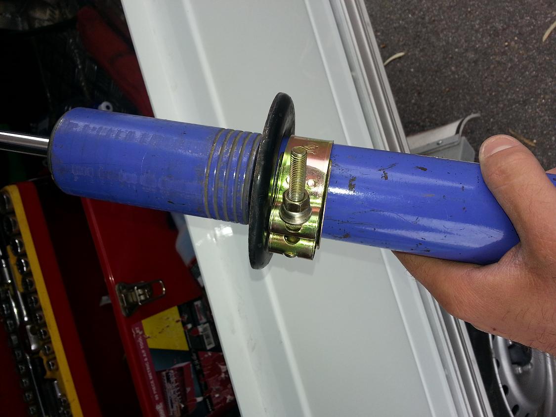

so this is my attempt at the ghetto 'just incase' clamp
[ATTACH]4066[/ATTACH]

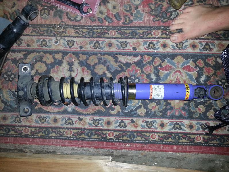

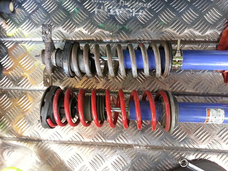

here's one next to the stock s13 setup, i had to compress the springs lots to get it all to fit and they bulge like crazy so i'm thinking i should cut a loop off? they're just the stock l springs that came with the car.
[ATTACH]4067[/ATTACH]

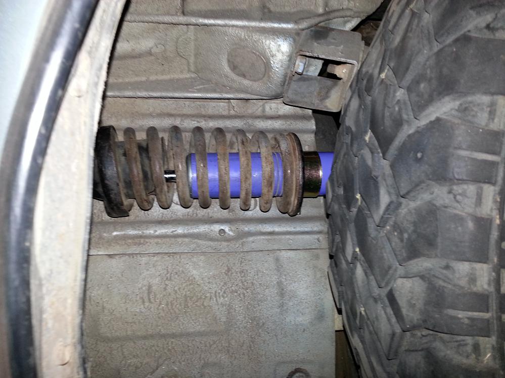

here's what the stock setup with 3" lift bracket on the left side looks like under load
[ATTACH]4068[/ATTACH]

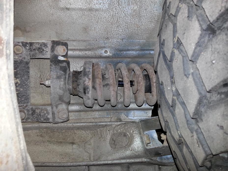

and this is the 13 shock and spring with no bracket under load on the right side, i thought maybe the bulge would straighten out once i put them in
[ATTACH]4069[/ATTACH]

Post by El_Freddo » Sun Apr 21, 2013 10:30 pm
Awesome Datto!
I don't fully understand what this s13 suspension thing is. Keen to know more.
Looks like the spring isn't seating properly causing the buldge :(

yeah i dunno i came across a cheap set and had seen it done before so decided to give it a crack, ultimately i'm after more clearance in the back because once it's full of junk it scrubs out,,, and i think the dampener thing will be cool to fiddle around with/see what i can get out of it.
not sure how i could get it to seat properly? i think its just that there's so much strain on the whole thing that the rubbers are squishing out one way or something
now i'm wondering if chopping a loop of the spring will fix that or not

Post by steptoe » Thu Apr 25, 2013 10:17 am
i think the bulge is called coil bind

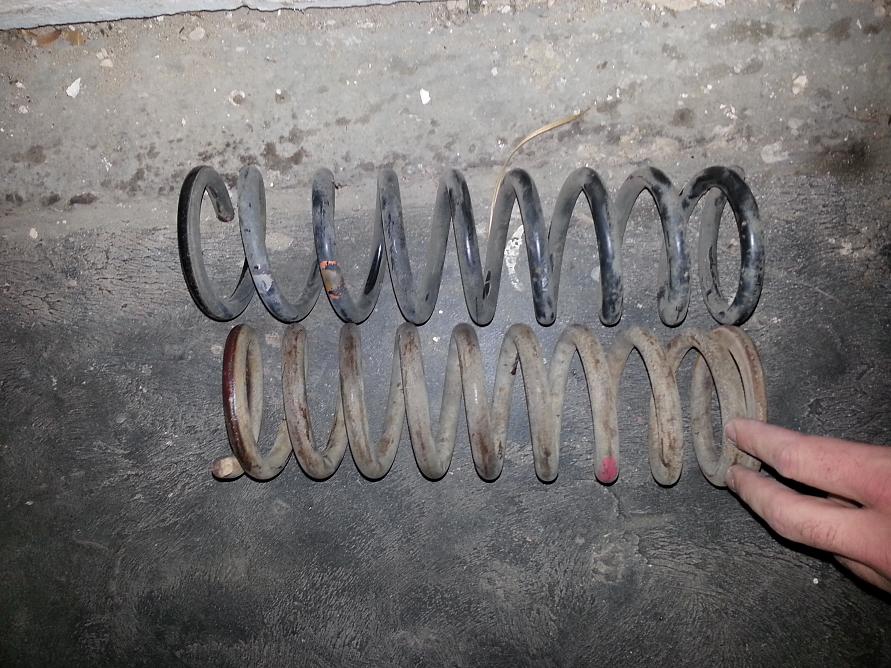

alright so i went to u pull it today and got some new springs and a few other strut top components i was missing and ended up with this
[ATTACH]4082[/ATTACH]
the springs i took of another L were a bit taller and a thinner guage
[ATTACH]4083[/ATTACH]
so they're looking better but i still need to sort out the bottom eyelet thing, the s13 ones are a tad bigger, don't know if i can just sleeve something in there or press the things out and swap them over,,,

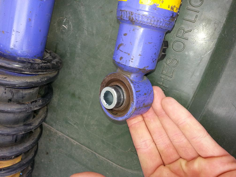

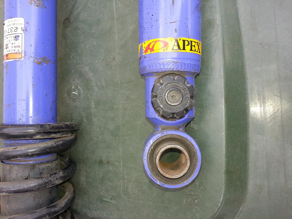

alright so i bought some generic bushes from supercheap that came with sleeve kinda things
so here's the s13 eyelet
ATTACH]4124[/ATTACH]
here's the sleave cut down to the same length as the stock subaru one
[ATTACH]4125[/ATTACH]
to stop it sliding around do think i can put a couple of tacs or is welding a shock a big no no?
cheers
Post by TOONGA » Sat May 11, 2013 12:36 pm
You need to find sleeves that fit thats the best solution. you can tac them but I wouldn't as shockies can go bang when mixed with welders. (very rare but they can do it) you other alternative is a shim between the sleeve and the eyelet.
username
Posts: 204
Location: Semaphore, ADL
Post by username » Sat May 11, 2013 12:42 pm
TOONGA wrote:You need to find sleeves that fit thats the best solution. you can tac them but I wouldn't as shockies can go bang when mixed with welders. (very rare but they can do it) you other alternative is a shim between the sleeve and the eyelet.
the sleeve fits in that it doesn't move up and down and it's the right size to fit to the car, its that the s13 eyelet thing is thinner, so i need to stop it from sliding left and right along the sleeve. i could pack it out with washers but their inside diameter would have to be bigger than the sleeve which is about 20mm
cheers
edit:
but not bigger than the s13 eyelet because it's surrounded by a bush that would just chew out, and it couldn't be as big as the outer casing because it wouldn't sit properly where it mounts to the car
