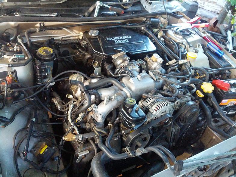

Update
Got my turbo gaske.
Wiring is proving to be a bit more of a hassle than initially thought.
I believe i have spare plugs for ABS, and some other things. ( that i dont have )

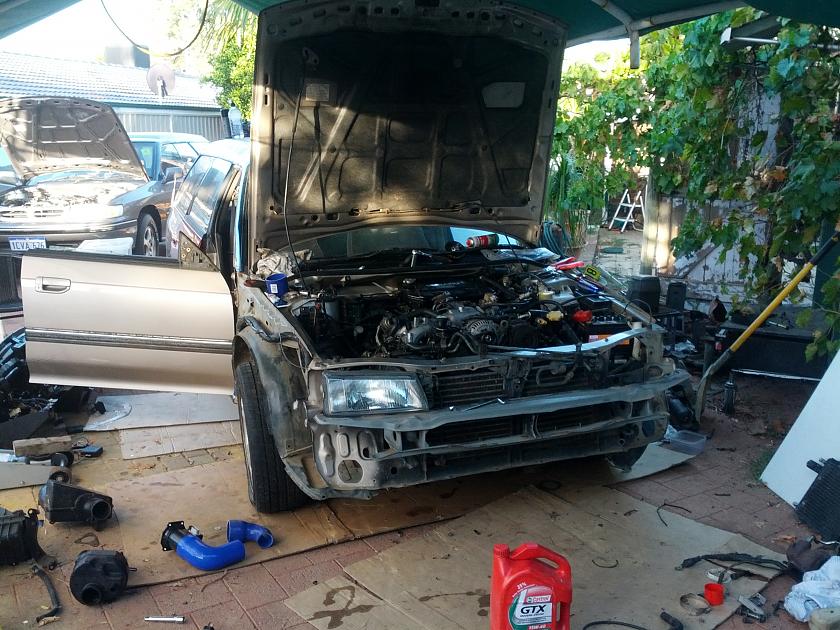

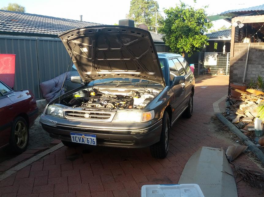

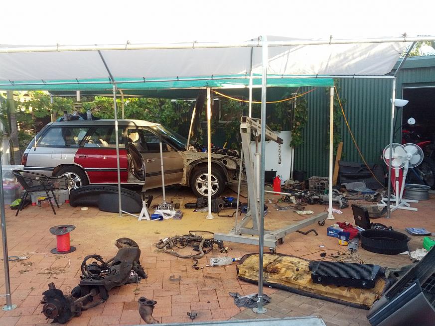

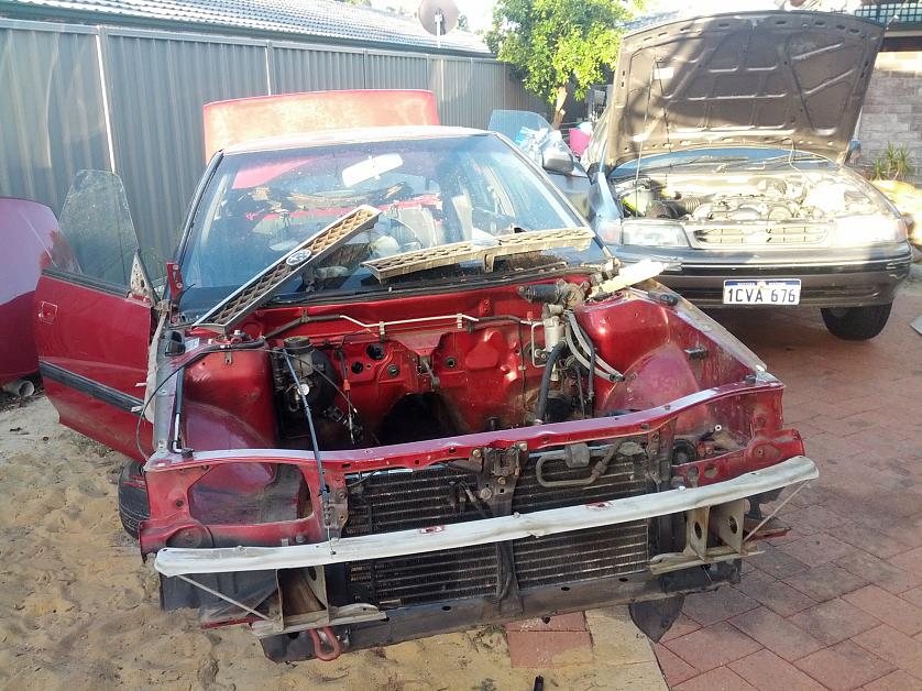

Post by jayrod » Sat Feb 23, 2013 8:24 pm
Update ;)
She runs :):):):):):)
And some pics i took of my ..."workplace"
Red car is Donor
Silver Car is my Current lifted subi
Silver car with red door is the Ej20t car i will be lifting :)
