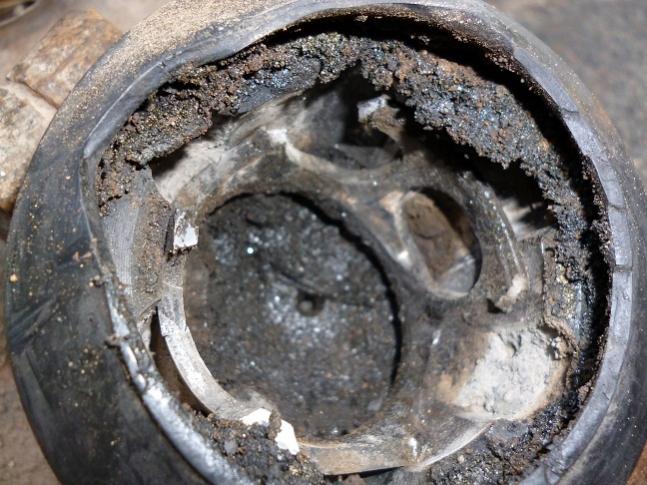

yep, knackered CV and bent shock. everything else seems alright, but i think it is going to need a serious wheel alignment...
what a CV joint should NOT look like. :???:

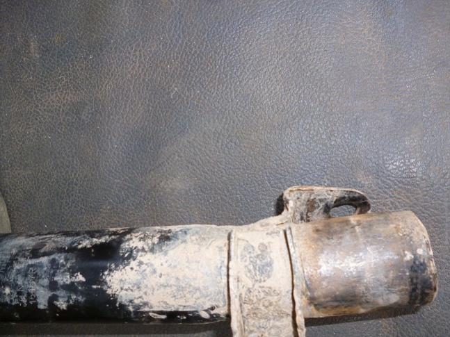

and the bottom of the strut is bent out...

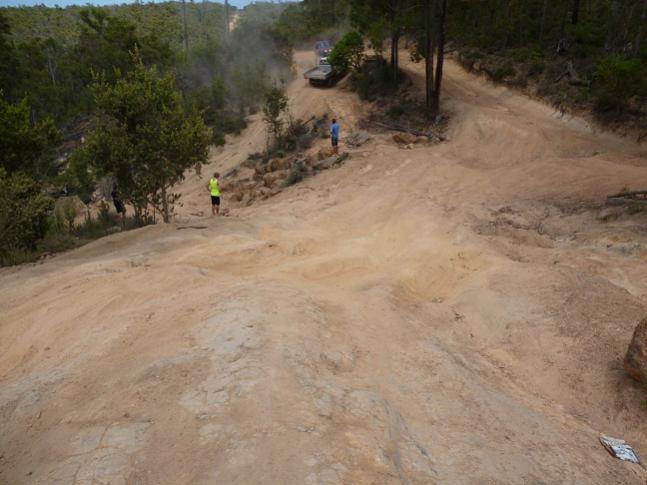

and this is the hill that did the damage, looking down from the top after it happened. :twisted: i slipped into one of the ruts, which jolted the wheel sideways. i am sure some of you guys will be familiar with the hill, just west of Gorrie rd on the power lines

Shit mate, must have been a pretty full on knock!
At least it's easily repairable.

Nice job :) did you check the radius rod as well?

TOONGA wrote:Nice job :) did you check the radius rod as well?
they look straight. if they were bent then the wheel would sit further back in the arch wouldn't it? because it is not doing that.
i guess if it is still crooked when i put the car back down i will know something serious is up!

Robbie.. that is one hell of a good job on the CV joint :( I'm guessing the force of a Subaru engine matched by SPEED may have had something to do with this. Climbing rocky areas is completely different to climbing sand dunes.. slow and steady wins ;) bet it was fun though :mrgreen:

RSR, I was going too quick, but i think it was dropping into the rut sideways that did the damage, not pure speed. Just so i have a car again for the next few weeks it is currently running RWD with my old pogo stick shocks :mad:

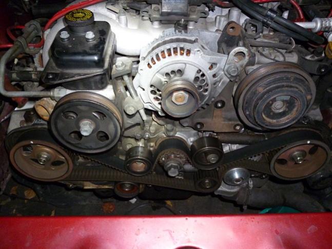

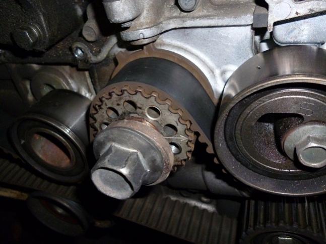

i now have another question, with the timing belts. The 2 camshaft pulleys have white out marks that line up with the notches on the belt cover, but the crankshaft pulley has an arrow which doesnt line up with anything at the same point. so which one am i meant to go off to replace the belt?

yep the cam pulleys are the right ones and then use the small notches on the crank pulley with the small notch on the oil pump and you will be all good

cheers. i did end up getting it. the mark on the crankshaft pulley was almost completely gone, but after a lot more searching with a better light it was found. :)

yea it shows up well in that pic that you took

Post by RSR 555 » Wed Jan 04, 2012 2:48 am
MTB92 wrote:[ATTACH]3066[/ATTACH]
90brumby wrote:yea it shows up well in that pic that you took
Yep.. this little notch is on one of the crankshaft timing tabs. As you have it lined up in these pics is correct. The crankshaft keyway should be facing down at 6 o'clock.
The arrows are there to line up for Top Dead Centre (TDC). If you rotate the crank (once you've installed you new belt) then all of these arrows should point up (12 o'clock) when the #1 piston is at TDC. These arrows where put on them for the EJ18 engines that came with the SPFI and Distributor.

RSR 555 wrote:Yep.. this little notch is on one of the crankshaft timing tabs. As you have it lined up in these pics is correct. The crankshaft keyway should be facing down at 6 o'clock.
In the poor light in the shed i couldn't see that mark. only the flash of the camera made it visible there, and i didn't look at the photos too hard before i put them up. i knew what i was looking for, i just couldn't see it. :oops:
I took down a bright headlight and saw it. :)

Everyone Ive ever seen the good doctor do, is done by aligning the 3 marks.
Post by RSR 555 » Wed Jan 04, 2012 11:16 am
MTB92 wrote:the book makes a big deal about finding tdc before starting to do the timing belts, is that really important?
As long as you set it up the way you have it in these pics, you'll be fine. Just be 100% sure that all 3 marks are lined up before pulling the pin to the timing belt tensioner.

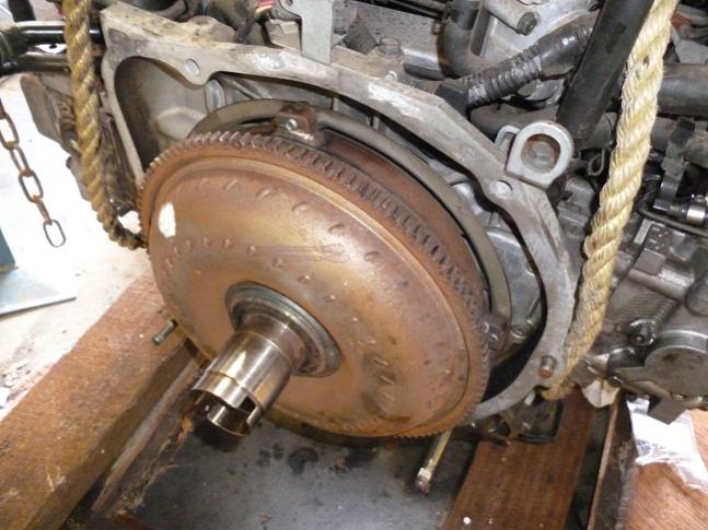

ok, timing belt, oil seals and water pump done. also pulled out the motor last night.
i am now trying to get the flywheel off the motor, but having never had anything to do with autos i am a bit stuck and i can't seem to find anything about it in the manual.
is the dome part meant to be left with the gear box to access the bolt on the flywheel? the only other bolts are 4 12mm bolts around the outside of the flywheel that can only be accessed from the bottom where the bell housing is open.

ok, scratch that :p
