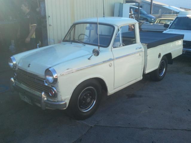

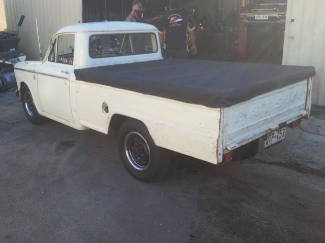

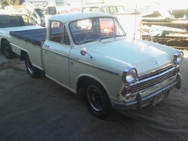

In the meantime, Here's some pics of my sweet new ride. This one's a 65
[ATTACH]3266[/ATTACH]
[ATTACH]3267[/ATTACH]
[ATTACH]3268[/ATTACH]
It even drives and everything. Pretty much had to replace most of things.
Jake

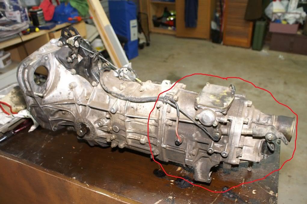

[ATTACH]3269[/ATTACH]
Aight so i'm guessing it's this bit. Do I have to mark anything/make sure anything lines up or is it just a 'plug and play' kinda thing?
Any help appreciated.
Jake.
Posts: 12708
Post by El_Freddo » Tue Mar 27, 2012 8:58 pm
Well this job is going to be a piece of piss since it's on the bench. Make sure it's in neutral!
1) Move all the wiring so that it's free to move with the rear casing
2) remove the top plate with the four bolts
3) inside there will be a 10mm bolt head on the selector shaft, loosen this off so that the selector shaft can move freely.
4) move the selector shaft so that it's free of the gear selector forks
5) undo all the bolts that hold the rear casing to the front half casings
6) if it's tough to remove, gently use a rubber or plastic mallet to help the rear section move.
The new rear section is the reversal of the above with the exception of the attention you need to put into the selector shaft - you need to make sure this is relocated back to it's spot in the gear selector forks. It can be a bit of fun. Then tighten up the little 10mm bolt.
That's about it. It could be a good time to replace the rear seal too. Also you might want to replace the paper gasket that's between the front and rear casings, I've not used it but some reckon it's required for correct gaps etc...

El_Freddo wrote:Well this job is going to be a piece of piss since it's on the bench. Make sure it's in neutral!
I stole that picture from another thread but i'll try and complete these steps with it still in the car, by the sounds of it it's going to suck. There's no other splines or anything i have to watch out for? I can't find the thread again with the picture of the rear housing removed, revealing scary bits that i'm not familiar with

Post by El_Freddo » Tue Mar 27, 2012 9:27 pm
EA gearbox down to the same point that you'll be stripping yours to:
This is the AWD gearbox split, not needed for what you're doing, but note the difference at the back of the gearbox with the length of the shafts and the lack of the gear on the pinion shaft (above with the EA box)
View when the top plate is removed (EJ):
^ The head of the 10mm bolt is below that cylinder piece in the top of the pic...
Doing it in the vehicle will be pretty tricky, especially if you can't see the bolt in the gearbox - you don't have to remove it, just loosen it off so you can move the selector shaft more than it would normally. Also don't let any crap fall into the gearbox ;)
