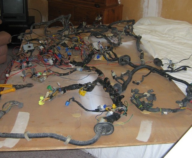

I just pulled this out of my crashed EJ20G rally Leone and I am feeling a little overwhelmed!!!
See - loom 1

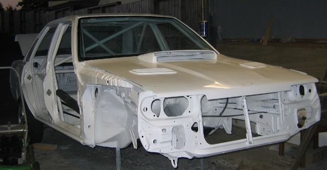

But - once it is stripped down and looking preaty and after lots of dumb questions to you guys it is going into this...
See - Paintedshell

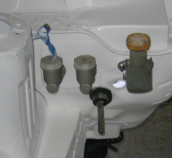

Already done is the full hydro setup, including two brake master cylinders so I can dial up F to R bias.
See - Paintedshell

Looking good, and i have to admit, thats quite a wiring mess

Naa not more than you can chew at all! Looking great. I have never even heard of adjusting F to R brake bios other than in F1/V8 Supers cars...
Paint job looks terrific. Keep up the great job and I'm sure the forum will answer all of the questions you don't know.

Wiring looks hard, and confusing.. And well I guess it sometimes is. But its relatively straight forward to chop down a loom to just engine-ecu wires.
I am starting from a good point - this loom worked in the old car!
However there is heaps I can prune off and plenty of dodgy connections to sort out, the prime ones are onto the little pins at the bottom of the Legacy fuse box, some have fallen out leaving no clue where they are suposed to go!!
Smokey - most fully fledged rally cars run a F/R brake bias, some go the easy way and use a brake proportioning valve, I have gone the whole hog and installed a brake balance bar which splits the pedal effort through a shaft in a spherical bearing to either left or right cylinder depending on where you adjust the bearing in relation to the centre (being the pedal shaft). They you just plumb MC to the frount and one to the rear.
Look up "Wilwood brake balance bar" and you should be able to find a pic or two!!

Hey, I love what you've done with your new shell. Looks tops.
That twin mc setup almost looks factory sitting in there too. I looked into it but the MY didn't have the room so I put it in the "do it later" basket.

Just spent a couple of hours pruning all the terminal ends out of the loom where the leone/legacy parts meet. Also re-routed a few wires to tidy things up.

The two MC mount in the 4 original brake booster holes, just elongated them a bit, if I was doing it again I would put them abou 15mm closer together to make it better suited to the brake balance bar.
The car has a five stud conversion (well 90% of one!) so will run 15inch Leggy rims.

That brake system looks pretty interesting! Where does the brake booster go? I guess it would be located further forwards that the firewall with a longer rod or something? Or are there more than one booster now?
EZ30 L series - Monsterwagon
maybe a remote booster like the VH40 ?

Yeah, My brothers Fiat X1/9 doesn't have a booster and the brakes have a lot more feel and aren't that hard either.ToyRX wrote:loosing the brake booster improves the feel.
