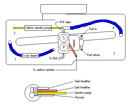

I can't quite see the detail in that pic but I'm pretty sure that is the outlet of the fuel filter labelled 1, this goes straight to the carbie fuel inlet or through a fuel pressure regulator first if you have one. I can't quite see what label 2 is pointing at. The little hose that comes out of the top of the fuel filter is supposed to be a vapor vent line, that hose goes down the firewall a bit and joints to a Y piece which I think is the fuel tank vent line. These two vents should go off to the carbon canister. Pipes 3, 4 and 5: one is a fuel bowl vent line which needs to be blocked off as the Weber doesn't have a vent. One is a canister purge line (usually the biggest diameter pipe) which should go to a large diameter vacuum port somewhere near the center of the manifold, usually there is a large vacuum port smack bang in the middle depending on what year manifold you have, but in your pics it looks like you used to have an EGR valve or something there? large plate in it's place with a big L bend pipe sticking out. And the last pipe on the carbon canister needs a vacuum source to operate the valve on the carbon canister.
The theory behind the canister is all the fuel vapors that are vented from the fuel tank, carb float bowl are drawn into the carbon canister for "storage". When the engine is running a vacuum operated valve opens and the vapors are drawn into the intake manifold to be burned. Unless your car had a return line with the old Hitachi you shouldn't need to use the Webers fuel return port.
This pic may help:
This pic may help:

Can the fuel pump handle not having a fuel return line? Will it burn out our should it be fine. Does the Hitachi return fuel? I'm considering getting a regulator with a bypass so the fuel pump is not working hard but pumping no fuel. Or is this silly?
And I think I am getting fuel out of the vapour connection on the top off the filter in the engine bay. Should I block this off? I'm not quite sure still how all the fuel lines on the Hitachi setup worked.

the charcoal cannister getting knocked out may cause problems as it is taking in vapours - should only be vapours ? from fuel tank and burning them off when signalled by the appropriate vacuum signal. Maybe knock up a catch can type thing to monitor if you are getting wetrol out of the charcoal can - think this can happen if fill beyond first click' of fuel nozzle at the bowser...
