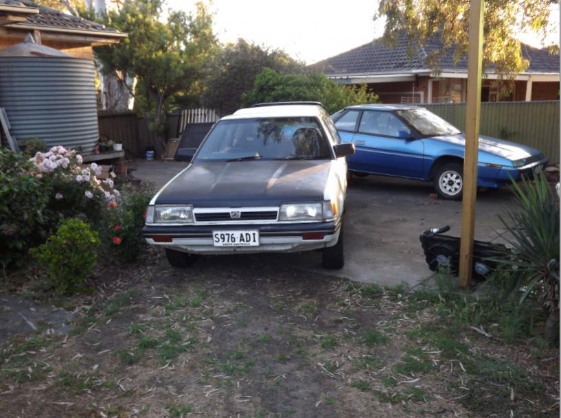

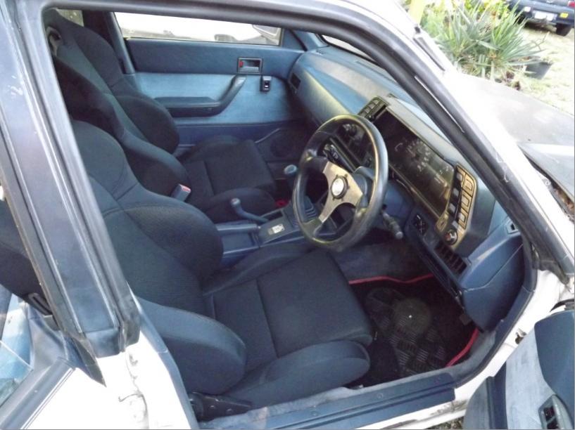

2 of my cars
A few pics of the toys,if anyone needs a project or 2,i'm open to suggestions.The engines out of the vortex at the moment,but if someone wants it i have 2 ej22's and a 25.At this stage i don't want to part with any engines.I have 6 cars and unfortunately i can't do everything.
