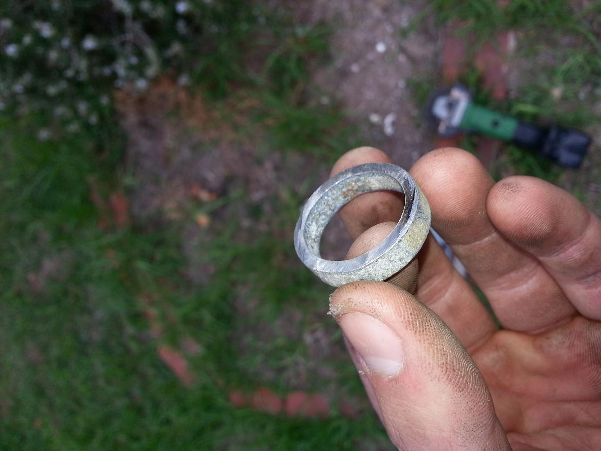

TOONGA wrote:ok I was thinking that the sleeve was loose diameter wise. you could get some billet washers machined in mild steel or brass to the size you need, so you would only have 2 per shockie.
alright i found a bit of pipe in my backyard that's the right size so i cut some 7ish mm washers out of it,,, no movement at all now
[ATTACH]4126[/ATTACH]

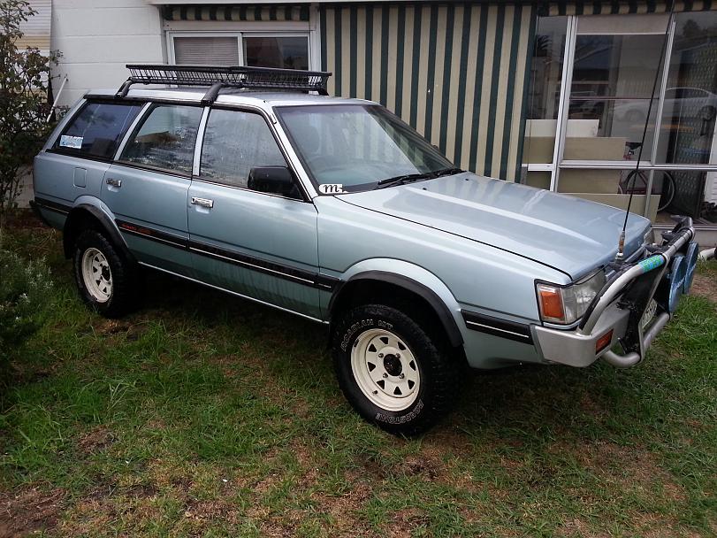

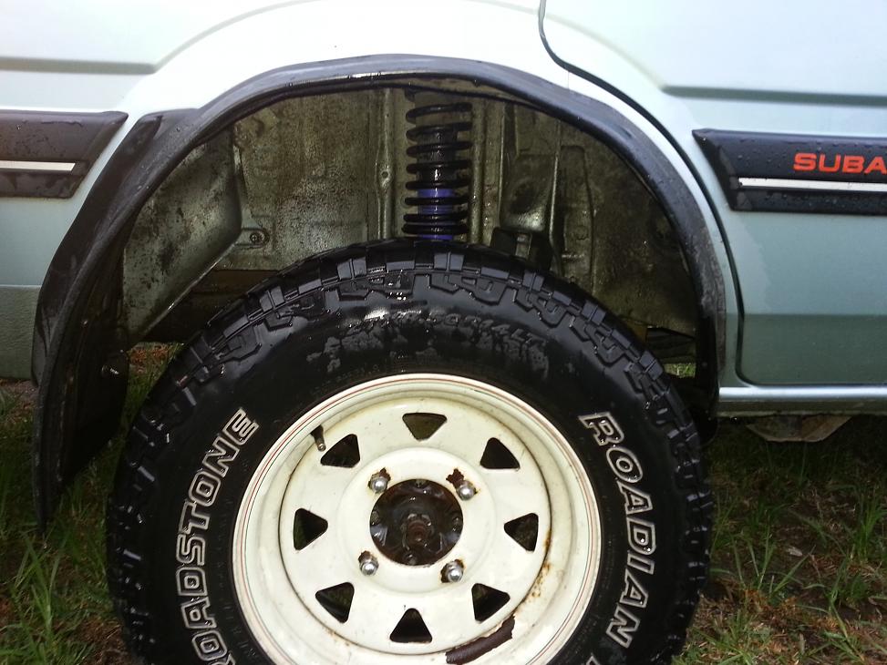

pushed it out of the shed and here's how it looks now with both sides in,
[ATTACH]4127[/ATTACH]
[ATTACH]4128[/ATTACH]
kinda hard to tell from those pics but i was looking at it from the back and it definitely sits higher, hopefully now when i put things in it it wont scrub out. haven't taken it for a drive because it's not registered but i have to drive to vic at the end of this month so i guess i'll find out then,,,
