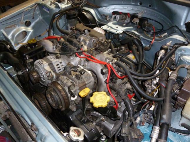

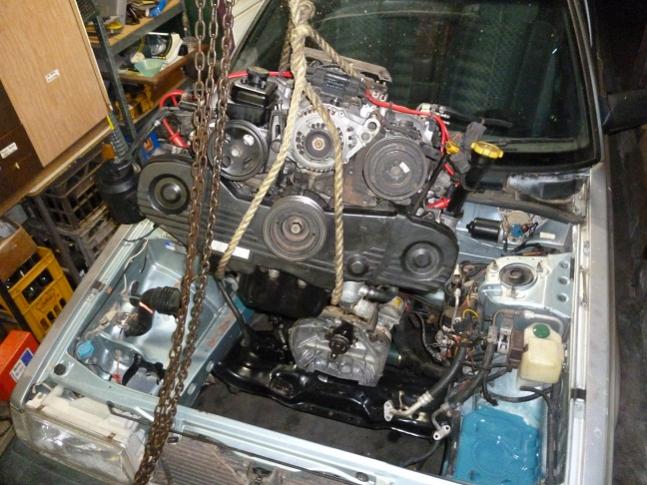

Post by MTB92 » Fri Feb 03, 2012 11:36 pm
well, i have been pretty busy with other things, so haven't spent as much time on it as i would like to have. Its getting somewhere now though :)
cleaned up the engine bay and put in the new motor. still a fair bit to do before i fire it up, but its starting to look pretty good now!
[ATTACH]3131[/ATTACH]
[ATTACH]3132[/ATTACH]
getting exciting now :twisted:
I am probably going to need a few pointers for how to connect the EJ aircon compressor and alternator to the L series wiring, but i haven't looked to hard into that myself yet.

MTB92 wrote:getting exciting now :twisted:
I bet and looking good :cool:

MTB92 wrote:Image
I bet you are! There's quite a lot of work done just to get this far! And it's really exciting when you get it in there and you realise that it's becoming a reality for you.
