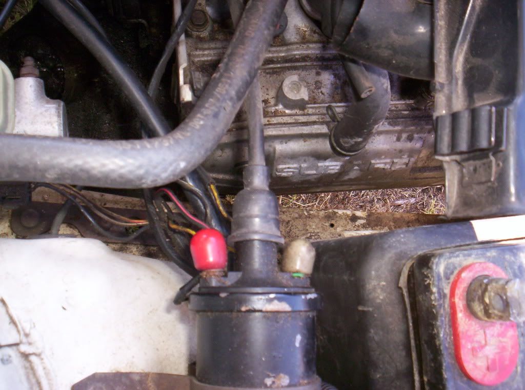

OK, fair is fair. i have seen an EA82T sitting in a standard height Brumby a few years back, so should not have asked as others have said you need the special rare wide chassis MY or cut the rails or modify with a BFH or the like, portapower. Others have sad one of our legends Tim81coupe had measured one up to not fit. Others have got EA82 in MY but never to my knowledge contributed the detail.
I am in the middle of a EA81 225mm clutch change in the Brumby, my EA82 hybrid of carb block turbo efi heads and intake to be fitted initially as NA LPG to my Brumby engine sitting just too close to the action, got hoisted up without flywheel or eng mounts to get in the way of lining up - could not stand two challenges of same in one day ! I dropped the EA82 in to see the fine tolerances that show in the pics - just a smidge less that what I remembered but.... it fits. It is a bit lower than where mounts would have it, but it fits. Chassis may need rubber lining to prevent knock, and rocker covers better not leak as engine needs a lift to remove them.
Pics to follow as have sent them to those who possess superior bigger pcture posting than I

Cool good stuff. Any pics that show the clearance?
I would be in favor of a few swift whacks with the BFH instead of putting bits of rubber, would prefer not to have any contact at all, but each to their own. Maybe there are some ridges or other bits on the rocker covers that could be thinned out abit with a dremmel tool too? Or ultra thin head gaskets

Thanks Mark, and so early in the morning too. Must find, make time, to learn this next step of bigger pics.
The lowest pic of last post there is the LHS, phew, see the clearance? Next one up is the RHS.
The clearance issue is really with the rear most part of the rocker covers as the timng belts have oodles of room, yet there is some symetry missing. Looks like minimal clear at LHS rear but the timing case has more room on LHS than on the right.The clearances are 'similar' to what I have sen before do not thinking it is any gearbox mount issue.

Boy those clearances are close !

The clearance is close a small amount of ajustment went on (not by me) with a hammer on the LHS here is the pics I took when I got the car I centerd the block and made new tranny mounts so it no longer pushed on the left side tunnel.
Left
Right
Will try to get more picts if u want to see more will hav to wait till weekend though

heh, so to make the engine fit comfortably, without any chance of hitting the rails during driving, the rails required modification? yes/no ?

cool that's good to know. I guess Tim81Coupe was playing it safe for his at the time. Most others I know of have needed to do the mod but because of quadcam EJ's.

heaps of room. little tap with a hammer would double the room.
clearances are not symetrical left to right because the heads are staggered.

of course the stagger is right along to the front where timing belt covers also appear to have different clearances - like any V of flat config. Good one wrxer - for putting the words to the scren !

Ok first I did not drop the ea82 in this brumby I pick up unfinish prodject cheap wanted the wheels decided to finish as it was alomst done. the bonnet has been painted now, the stagger was before I fixed the engine mounts and replaced gearbox mounts with new ea81 ones previously had one of each ie:ea81 & ea82. Sorry about hijacking your thred steptoe.

I thought Tim had lift on his MY? By the look of T'subaru's pics you're all good if you're not running with lift - any lift and you'll have cam cover clearance issue I'd reckon...AndrewT wrote:cool that's good to know. I guess Tim81Coupe was playing it safe for his at the time. Most others I know of have needed to do the mod but because of quadcam EJ's.
