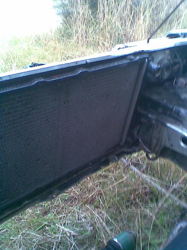

I got myself a GX radiator to see how it fits
Now i just have to drill 2 holes in the angle iron i got to brace for the 2 lugs on the bottom, and work out how im gonna support the top and i can weld the lower radiator support back in

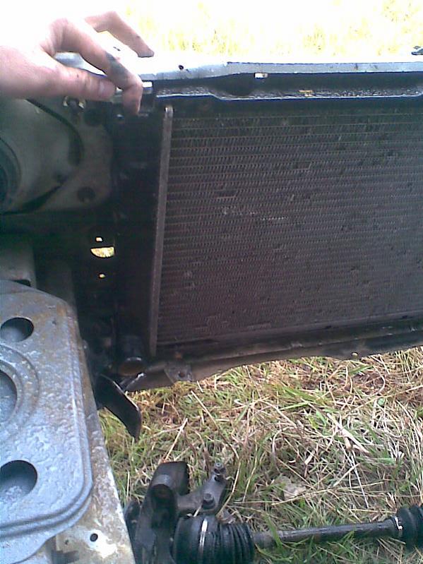

You can probably see the liberty front hub and shaft the the 2nd picture, i got one installed, but it started to rain, so i still have to do one front hub and the 2 rears.

Some better photos
GX Liberty/Legacy
I should have said non turbo Liberty.
I just have to weld the angle iron in place and then tack the end bits together and maybe a piece over the top so it look all neat and factory.
