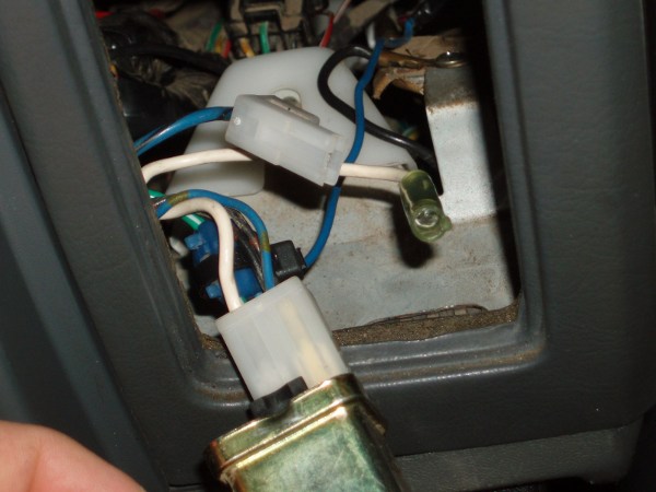

Not working...
Ok, so i have installed the A.C. in the Brumby. Now the dash fan doesn't work nor does the A.C. system. (I also accidently disconnected the vent so i took a large leap backwards in comfort!) I think i have made a mistake - looking at the wiring diagram i have that i should have a 20 Amp fuse on the white tail i have poking out in the picture. Does anyone remember how the relay install works? I have had the voltmeter out and i have 12v on the white that is plugged into the relay and 0v on the one that is floating in air. Still haven't had a lot of time to get really into figuring it out... just thought it might stick out like a sore thumb to someone who has done it...
The fan relay works though and i get both fans on when the temperature gets up high. So some of the wiring is ok...
- P8180013.JPG (58.47 KiB) Viewed 5535 times
Fitting an Air-Conditioner to a Brumby was my first request for assistance with this forum. After reading this thread numerous times, I must congratulate all those that contirbuted to it. It will save me countless hours, as I have been informed by other so call "expexts" to attach the fitting in a completely different manner. Thank god that I found you guys.
All the best and regards
Buddyboy

555Ron - did you get your AC sorted? I'm sorry for the super late reply, I must have missed this update of yours back in August.
I also had someone request a photo of the relays on Sunnie the Brumby, I unfortunately forget who this was and I've still not yet taken these photos, if anyone needs them PM me and I'll get them sorted now that I'm back to living close to this subi
Hey El Freddo,
I got it sorted and the A/C works really well, not too hard to install. I left a fuse in the old wiring harness from the donor vehicle, i was able to make a temporary fix to get it working until i got back to the donor wiring harness.
I haven't got the idle adjustment working yet, but it still idles ok with the A/C on so i haven't been too concerned about it. Does the arm from the vacuum adjuster go straight the the carb or is there a piece in-between?
Oh and it's well worth the time and effort to fit, so comfy!
