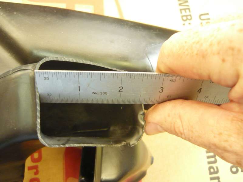

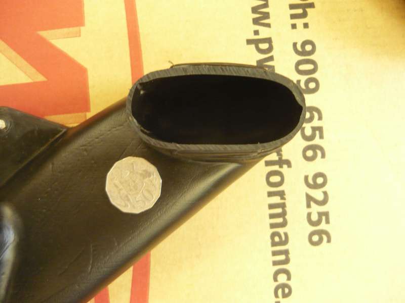

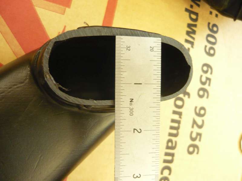

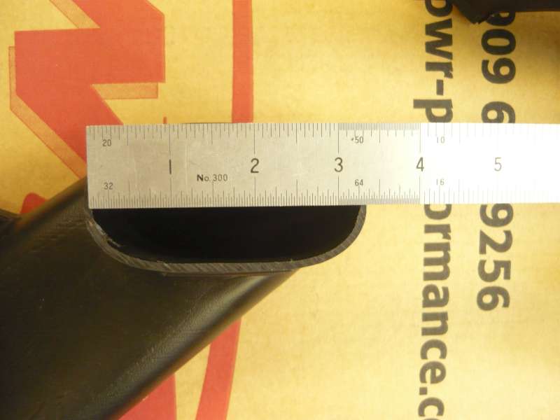

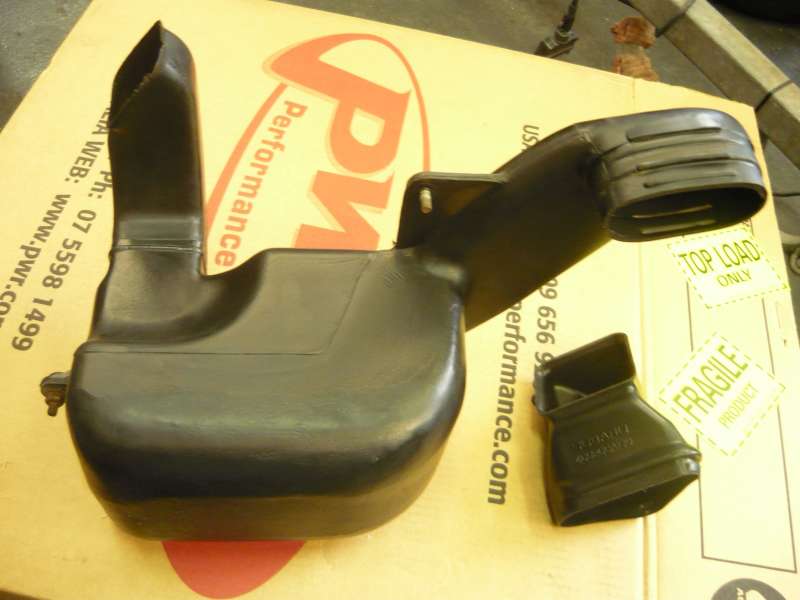

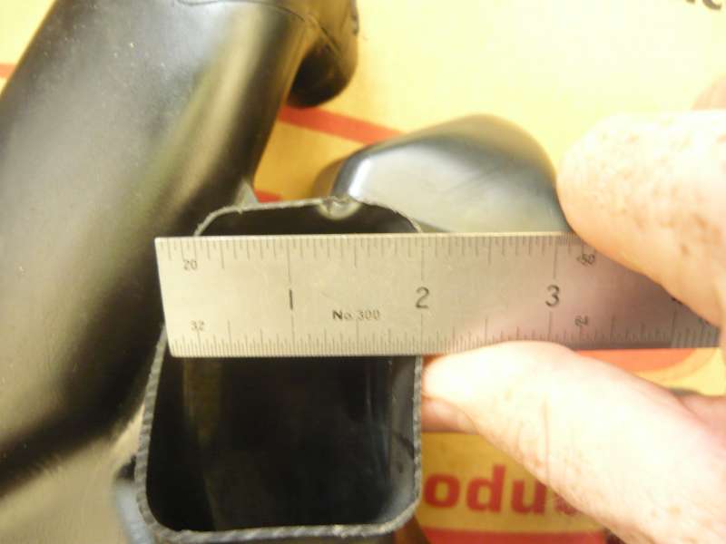

- BB 010-800.jpg (27.11 KiB) Viewed 3975 times
- BB 009-800.jpg (31.81 KiB) Viewed 3976 times
- BB 008-800.jpg (32.06 KiB) Viewed 3976 times
- BB 006-800.jpg (30.32 KiB) Viewed 3977 times
- BB 003-800.jpg (28.75 KiB) Viewed 3977 times

I got hold of some 3 1/2" exhaust tube today and some will be used for the air boxes inlet and the rest as the front part of the Skylines exhaust , it too will be big at the front like the L but with 2.5L and much better head and electronics . Would like to see 270 Kw at the wheels with that car .
Cheers A .

You posted while I was typing .
No that was the box for the radiator PWR made for one of Explosive Racings quad bikes .
Just happened to be a good flat surface to put my stuff on .
