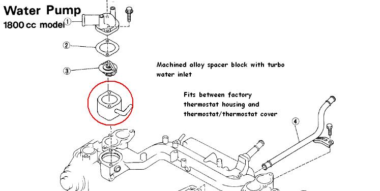

I was just brainstorming....
Why not make an extension on top of the thermostat housing to make the thermostat and outlet pipe higher than the turbo?
Would be dead simple to make. A block of alloy, machine it to the right shape, gut the inside, weld in a pipe to come from the turbo, and then use longer bolts and 2 thermostat gaskets and its as good as gold.
EDIT: Just did a quick mock up using paint
- thermo ext.JPG (35.87 KiB) Viewed 4016 times

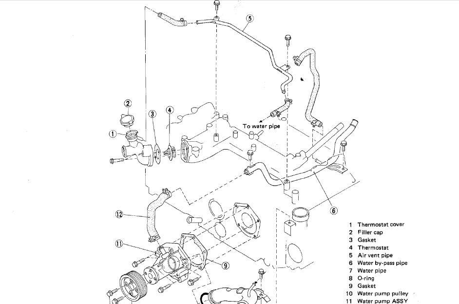

Ah you are lucky you said that, as i have a diagram of the ER27 setup herediscopotato03 wrote: Just for giggles I must look at the XT6 ER27 WSM , those cars had so many transition bits from the L to the "EJ" production line that maybe there is something to be learnt .
The pressure cap is on the front of the thermostat.
- thermo 2.7.JPG (62.23 KiB) Viewed 4015 times
...I wonder does the ER27 have a different Water pump and larger 'bottom' hose?
looking at this they might...

I had thought of the housing spacer Gannon but the trouble is that you end up with the water outlet being highter than the top of the radiator .
No I'm afraid all this stems from using manifolds designed for a Vortex and its
possible that the nose and rad sit higher in those than an L series .
I wonder if its possible to raise the rad very much in the old L .
Also did you notice how Fooj use a bleed pipe between the water pumps steel outlet pipe and the thermostat housing on the ER27 , make the things easier to bleed I reckon .
I should look into that Lib rad in L idea again , I don't think removing the lower support section would get the nod from the rally fabricators unless it was not a load bearing member .
Cheers A .

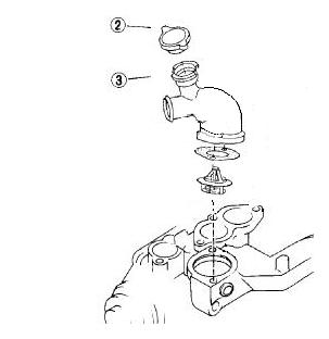

So could you modify/duplicate an ER27 thermostat housing so it will fit on the EA82 manifold, so you can incorporate the pressure cap and make it the higher point
- thermo modif.JPG (10.45 KiB) Viewed 4006 times
