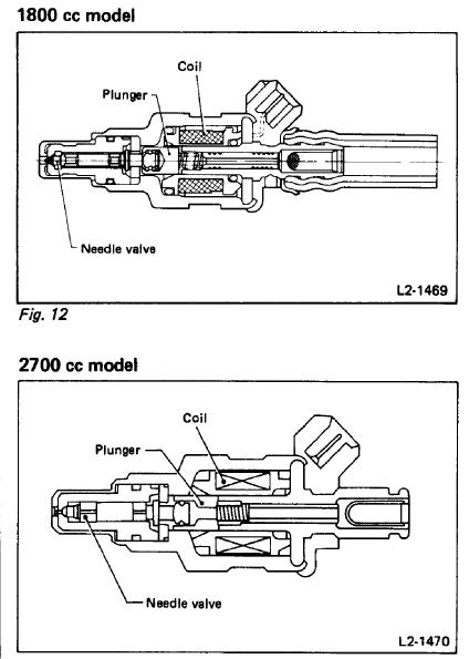

By the looks of this...
This ER27 looks like it has alloy fuel rails, and this picture confirms that ER27 injectors have O rings
So it has top feed injectors, and at a guess, the bosses in the intake manifold would be the same as the EA82 ones
But that probably doesnt help you much as ER27 injectors are only gonna flow as much as EA82 MPFI injectors.
ER27 injectors also have a built in resistor

Thanks Gannon , the injectors themselves are easy to find once you have top feed O ring style fuel rails and the whole lot is sooo easy to work on compared to hose barb type .
Actually both the EA82 and ER27 are whats known as EV1 style injectors and they both are held in the manifold with plates/insulators/cushion rubbers and the lower seal itself .
As you know the hose barb type fuel rails fight you every step of the way particularly on an L type EFI engine . The spider rails are a little easier to get up out of the hoses but not a walk in the park .
Later EV6 and EV14 O ring injectors are held down purely by the rail and have more modern internals .
