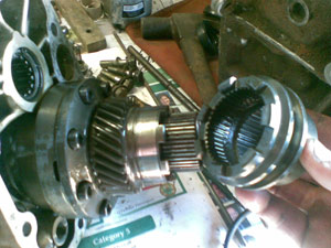

the diff lock light sw is at the bottom on the drivers side of the extention housing below the diff lock lever
these boxes also have a neutral sw and a sw that tells something when its in 5th gear (i think its 5th anyway)

a pic of center diff locking mech
