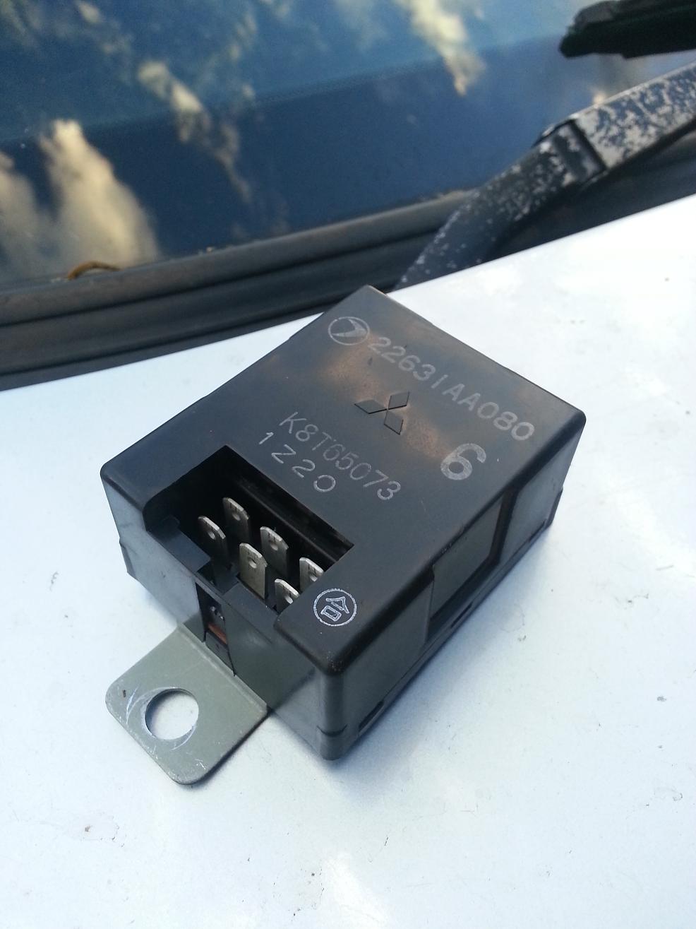

just bringing up a past thread here with the flasher unit mine recently went when escorting a mate being towed at night, my hazard lights and indicators arent working so i'm guessing this should be the problem??? does the unit look like this... pic

Dann wrote:just bringing up a past thread here with the flasher unit mine recently went when escorting a mate being towed at night, my hazard lights and indicators arent working so i'm guessing this should be the problem??? does the unit look like this... pic
Nope. This is either the A/C Rev counter or the Wiper Control Unit
The Flasher Unit should be a round silver looking unit
Post by steptoe » Thu Feb 21, 2013 7:13 am
Not the wiper control unit, they have been grey boxes so far - that unit is something like the stop the electric fuel pump in case of an accident - about 350 bucks for a new one.
Dann, can you tel us year model or make date of your L, maybe even a pic of the indicators at the column. Er, you have checked fuses ?

yeah it's a 1992 l series standard one built- Jan 1992 on a Wednesday... haha jokes but the Jan 1992 part is right, and yes I've checked all fuses, can somone post a photo of the exact relay of the flasher unit,cause i thought it would be the silver canasters too but this thread says otherwise, anyway I put the car in test mode and one at a time swapped all the relays around( only the same type ones) with one that was working and all of them worked, unless the unit is tucked right up under the dash?
